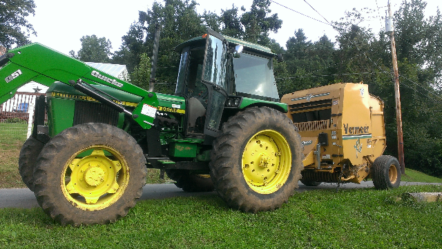

Jd 3150 pulling a vermeer 554xl. ive been useing this combo for several years now and so far it seems to work well for me. We have some pretty good hills here that I wouldnt want much of a smaller tractor to try to handle that baler. The baler is in pretty good shape. We only roll several hundred rolls a year and so far not too much to go wrong with the baler. Twine arms can be kind of tricky on these balers. Ive never understood why Vermeer put them so close to the pick ups.
Did you buy your baler new? We bought a 55XL brand new and if I could I would shove it up Vermeer's *****. It's the biggest piece of crap junk manufacturing joke of a machine I've ever ran. Those Vermeer engineers must have been smoking dope. Every issue that could go wrong has gone wrong from day one. Monitor, sensors, poor design etc. If you spit on hay then it's too dry to roll up and plugs it.
