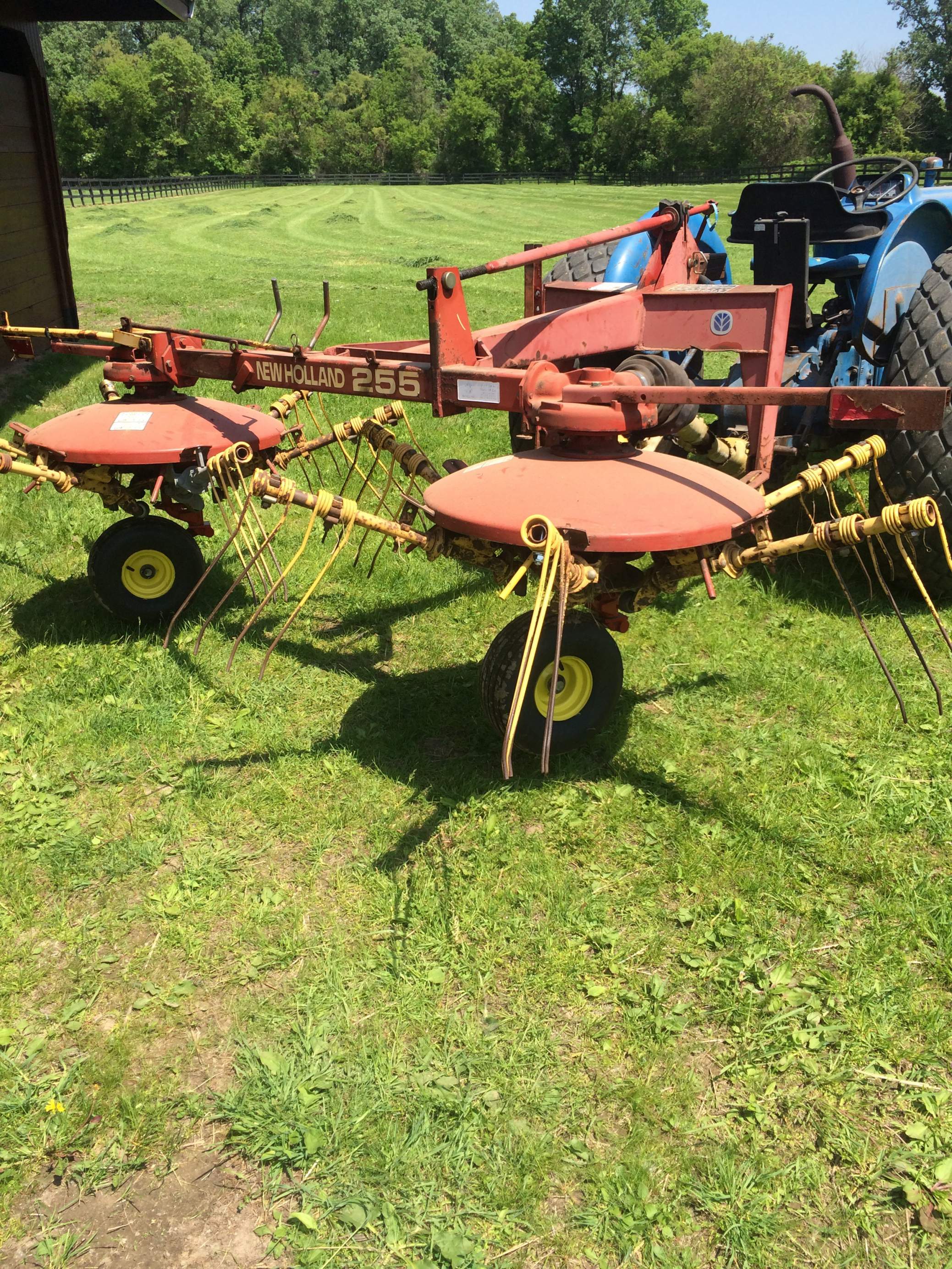

Here are some pictures and video of our New Holland 255 Rake/Tedder which I affectionately call "Edward Scissorhands":
Videos:
https://www.youtube.com/watch?v=GnkGWFRJhpE&list=UUI9EPMDqQwCnyYzoYM685UA&index=1
https://www.youtube.com/watch?v=6AdZIaI6Kf8&index=2&list=UUI9EPMDqQwCnyYzoYM685UA
Our grass hay is typically very thick and tough to dry. I contract with a local farmer to cut my fields and I sometimes wonder of his conditioning rolls do and adequate job. As I am relatively new to this I have no frame of comparison. The second video shows me tearing apart 2 swaths. The first video is the second tedding of the first cutting in the same field.
