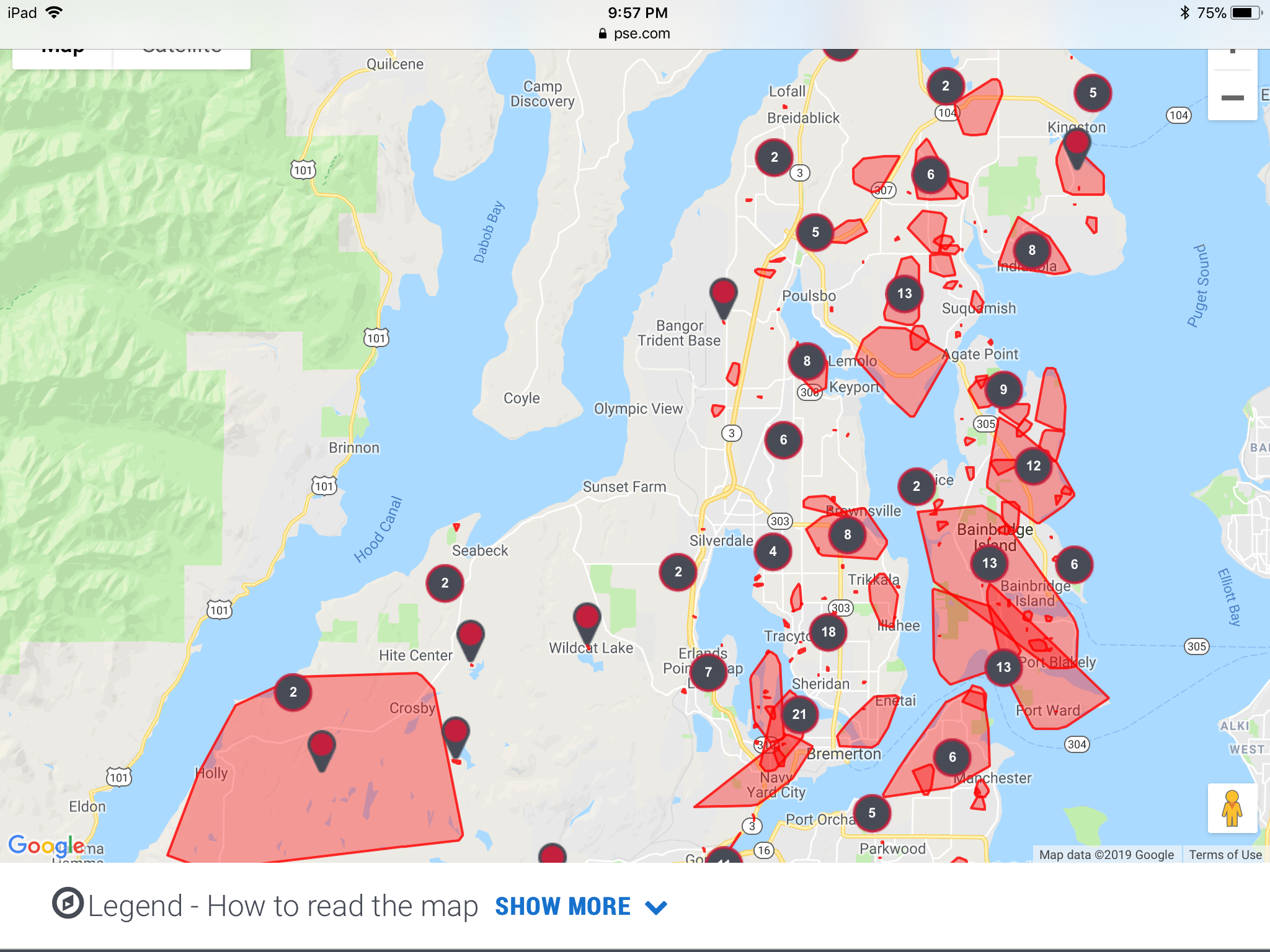

I went on generator about an hour and a half ago. Power is out all over the area:
Outages:533 Estimated total customers affected:43256
About the fourth time this year. Do not move to Western WA if you like utility power :D
