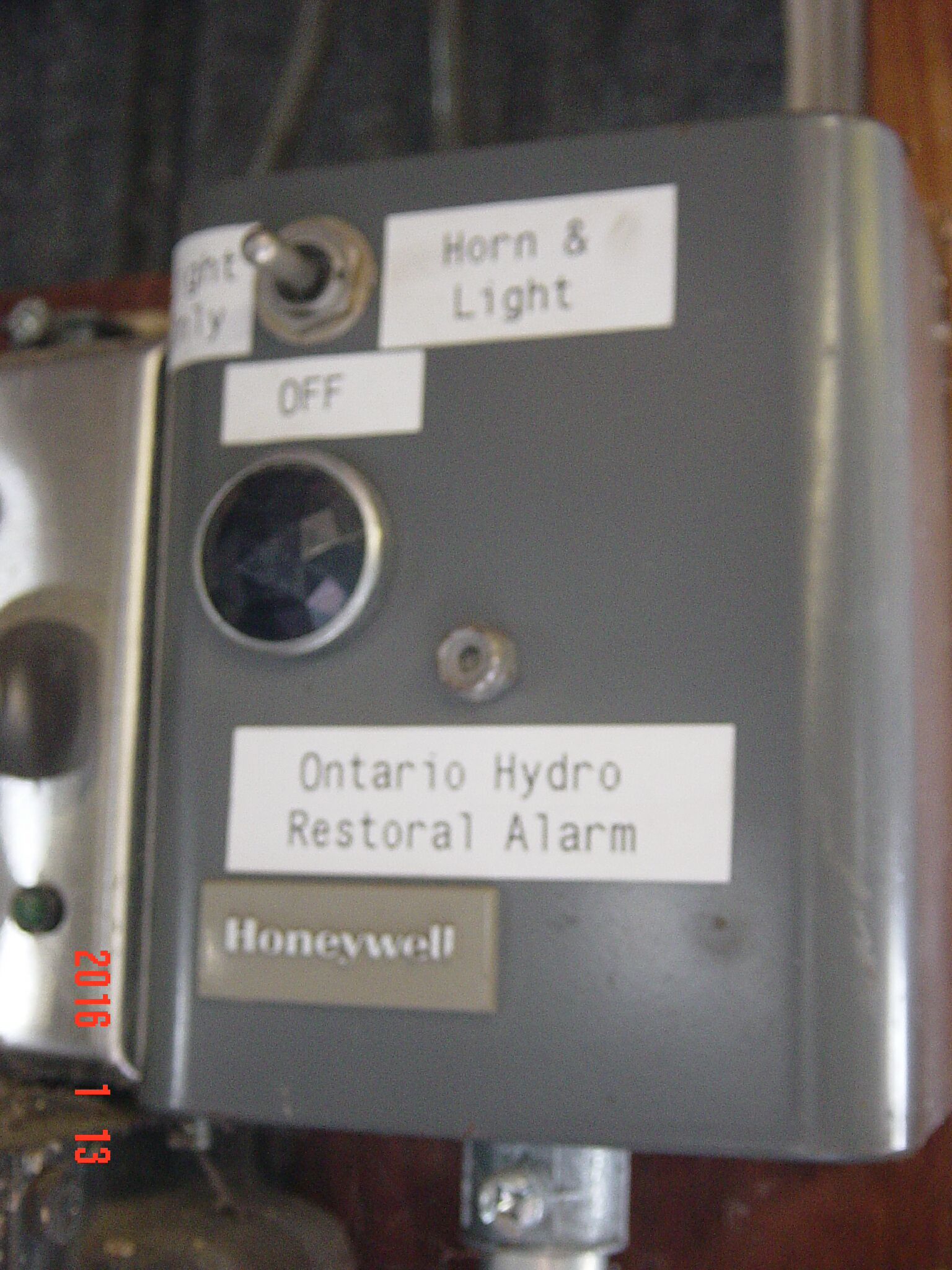

Regarding the flashing "power restoral light/horn"
Within this control box, I have a small transformer to make 10VAC and an old telephone system interupter, basically a motor and cam driven switch. Anyway, this makes the lamp flash quicker and the horn go at telephone ring intervals.
I would LOVE to use an LED, but they don't come on quickly enough to use them for flashing (I believe). Also, I don't think you can get a bright one in the short, oven bulb, type size.
Power went out again this morning. I didn't even know. I was alerted by Text msg from my monitoring station. A neighbor called. The Utility was not even aware of the outage and there were no weather conditions at all. Strange. I never even bothered to get out of bed and it came back an hour or so later.
