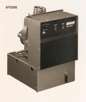

I did the weekly maintenance run for a number of years at a small medical clinic... back in the 80's...
The single cylinder natural gas Winco Genset was in the basement... it did put out a lot of heat and was loud... the exhaust was Black Iron Pipe that ran some distance and eventually up through a small grate...
Never gave it another thought... basement was fully below grade... one set of wooden stairs down and the vertical access grate...
The room was for light storage, electric panels, Telco MPO and vacuum pump... when the clinic closed I was paid to remove the generator and 240v transfer switch and brought it home... never did anything with it because it's really is loud... only way I would be able to use it would be by making it much quieter...
My uncle had a WWII surplus genset and he built a concrete bunker into a hillside for it's permanent new home at his hunting cabin... it ran for decades.
Generator, Winco

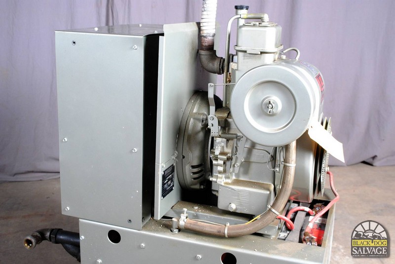

It’s been almost 2 years since I started building my powerhouse.
I installed my two 28 volt DC generators yesterday and fired the MEP-952b military APU tonight for the first time under load.
Talk about coincidence, I need to do some sound/acoustic work because my building is sounding like a huge bass amplifier.
The engine is a 15 hp 750cc Farymann 43F single cylinder diesel and it really shakes it up.
I think setting it on some isolators will do the job I just need to find something suitable.
I have 4 items to address to finish this part of the project.
1) Need to finish the exhaust;
2) Setup the 55 gallon fuel tank;
3) Install proper heavy electrical cable run to batteries;
4) Isolate APU from building.
Part two will be to get my home made 28V DC generator on line.
This unit has a 10hp Yanmar L100 diesel belt driving a Niehoff N1603-2 28V 450 amp alternator.
This unit is currently in place only no connections have been made.
At my earliest convenience I will perform a fuel consumption test on both units supporting the entire household minus the electric dryer.
It’s important to know how many hours/gallon they will run for planning purposes.
I have 2 powered exhaust vents with speed & temperature controls so I can hopefully keep the engines warm enough during the winter months, I would like to have the interior temperature around 70~90 degree.
90cummins

Itç—´ been almost 2 years since I started building my powerhouse.
Itç—´ important to know how many hours/gallon they will run for planning purposes.
90cummins
An ambitious project, that will serve you well.
Acoustics can take a bit of time to sort - I'd definitely want to start with the isolators. Might mean flex connections on all lines, if not there now....
For me, there are at least 2 challenging phases to many projects - 1) Starting It ! and 2) Wrapping up those last few details.
I like your hybrid approach using batteries - a lot of household emergency use is fairly low power. Your previous consumption #'s looked good, and being able to cycle a diesel through medium plus loads, then have the batteries carry during diesel Off times is pretty much optimum IMO.
Liking the setup for the exhaust fans - were those controls built into the fans already ?
