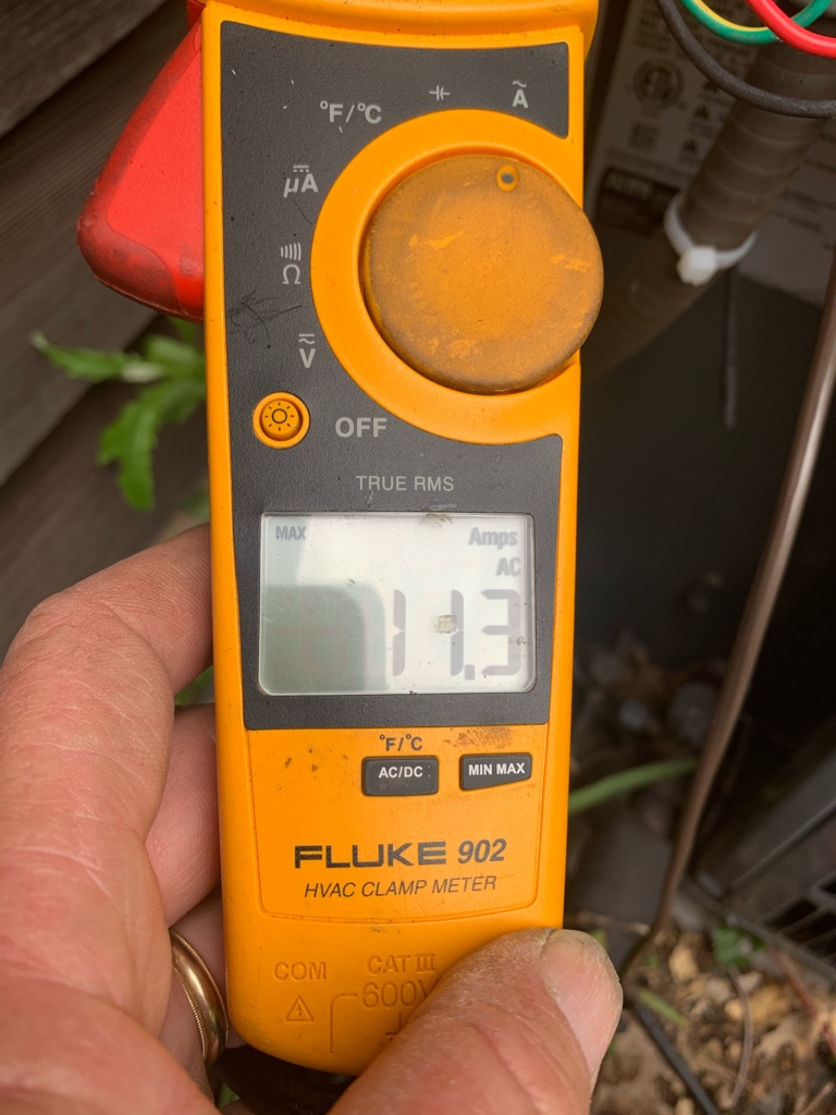

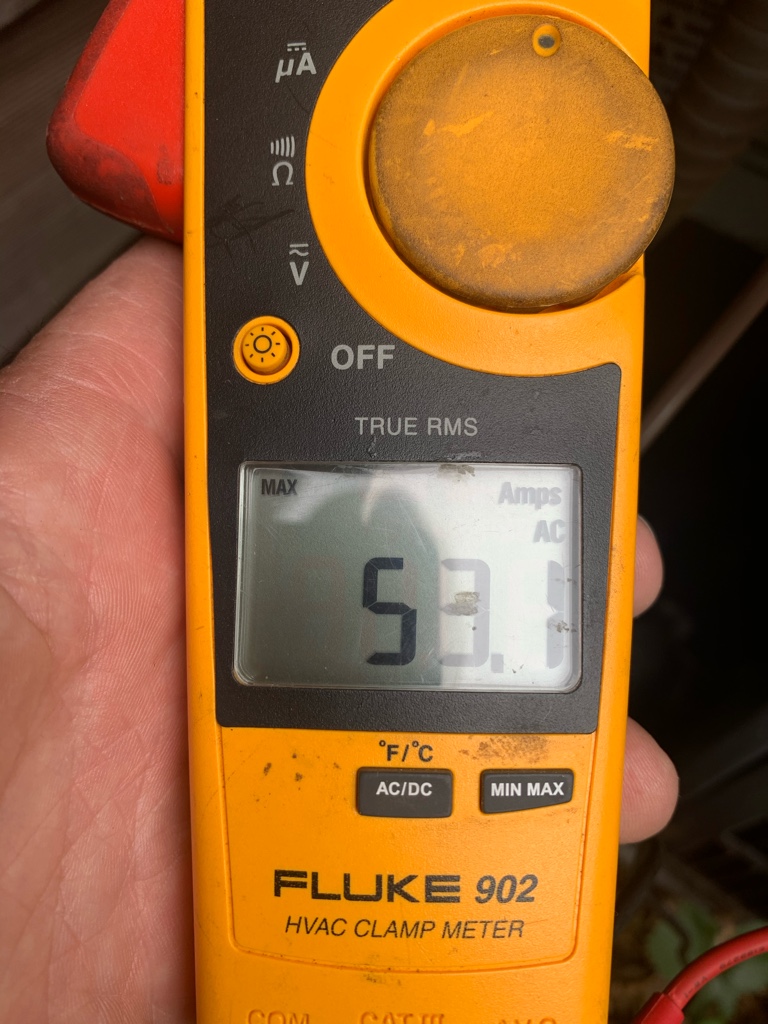

Revisiting the soft start vs hard start discussions earlier in this thread.
After researching the Hyper Engineering “Sure Start” I figured I would investigate further and plunked down the $275 to buy one to test. I installed it on a 3-1/2 ton heat pump. Here is the before and after results as measured on my clamp on ammeter set to capture peak reading. The before was with a hard start, the after was with a sure start.
I would have to say that while expensive, the sure start does what it claims to do, and I would now recommend one to anybody wanting to run AC or Heat Pump equipment with a generator.
   / Your last generator Maintenance Run #4,259
yup.... i have installed quite a few of these over the past 3-4 years. Not cheap, but they have allowed ac units to operate under generator loads that would not run before. Last mondays 14 hour outage at my house. When the ac cycled the lights barely flickered....barely noticeable. The led lights only slightly. The incandescent not at all. The generator did not labor to run during use. Before soft start, i had to use a load shed device to prevent 97 amp draw at startup on my ac unit... a 4 ton.
One last thing a hyper engineering soft start does, it prevents a ac compressor from running in reverse when transfer switch returns to utility power. In the fractional time a transfer switch uses to switch back to utility, there have bern complaints that a running scroll compressor can run backwards. Normally the unit will shut itself down and restart after a delay when this happens, but cant be healthy for it. The soft start prevents this from happening.
