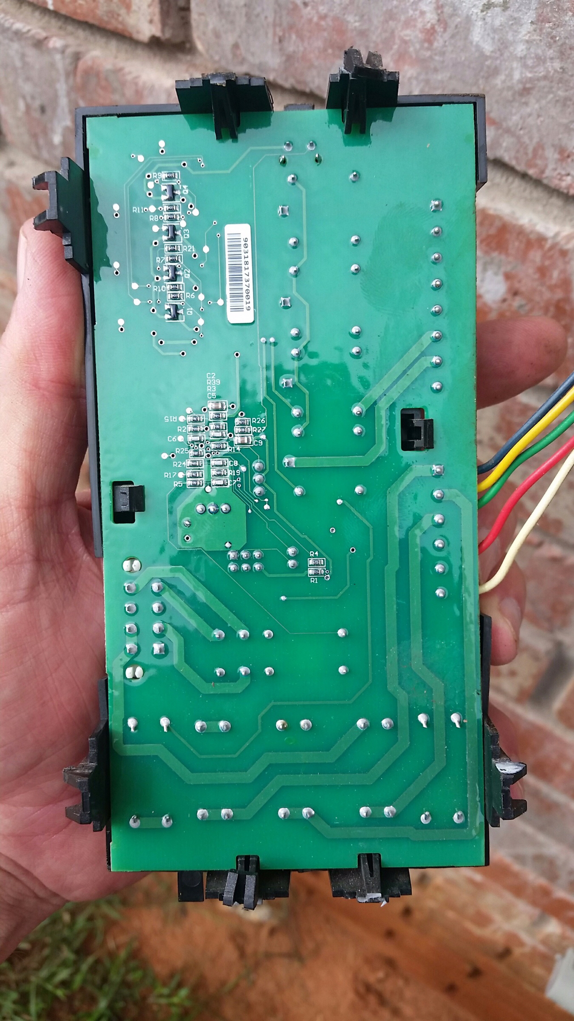

There isn’t board level documentation that I could find, but it does appear that the load shedding is independent of the transfer function. However like you said, the LEDs not being lit is a red flag even if they aren’t directly related to the transfer.
There not related directly, but when transfer is initiated all loads are shed at same time, then after 5 min the load 1 is reinstated, others at 15 sec intervals. So something is amiss.

I got the board out, once a few of the tabs break it’s much easier lol Nothing obvious that I can see, the smudges are fingerprints, not mine.
After putting everything back together and turning the house power back on I took some readings.
On the terminal strip side T1 N1 and N2 all read 120 volts, (as did all the fuses.)
The bottom 2 terminals read 12 VDC.
One thing I noticed is that once I flipped the breaker on the transfer switch, the voltage (12 vdc) began to slowly fall. Within about a minute it was down to 10.96 DC.
I didn’t remove the PC board from its housing, I can go back if need be.
If I can take some more readings, let me know.

That doesnt look shorted. Those are real obvious. Entire base is fried.
When the generator is in Auto mode, you should have 12V+ on 194 to ground or the 0 wire. 23 will not have voltage as it's just either grounded or ungrounded depending on the desired position of the switch.
The 23 wire gets grounded (12V-) when the controller tells the switch to move.
Im not sure why your voltage is dropping. It should remain constant. And i really dont understand why the 4 led lights arnt on. Maybe you should take a quick look at face of board? Something weird going on.
How old is the unit.
Also something that you should check. Look at the bottom of the controller inside generator and make sure all the plugs are installed tight.

I would still suggesting measuring between 23 and 194 for 12VDC with the generator running and the utility power off.
If there is not 12VDC there, the problem is in the generator. If it is there, then the problem is in the switch.

agree. thats what im asking above. if hes not getting 12V+ then the trouble is in the expensive controller. was hoping its in the cheaper board. problem with generac is they dont have any reference material available to troubleshoot circuitry within a board or a controller. there have been people repairing a defective controller, but thats way beyond my pay grade. one thing about servicing these units in person, i have nearly every part on my truck, so i can try different parts to help track down any issues. hard to do on a online chat.
