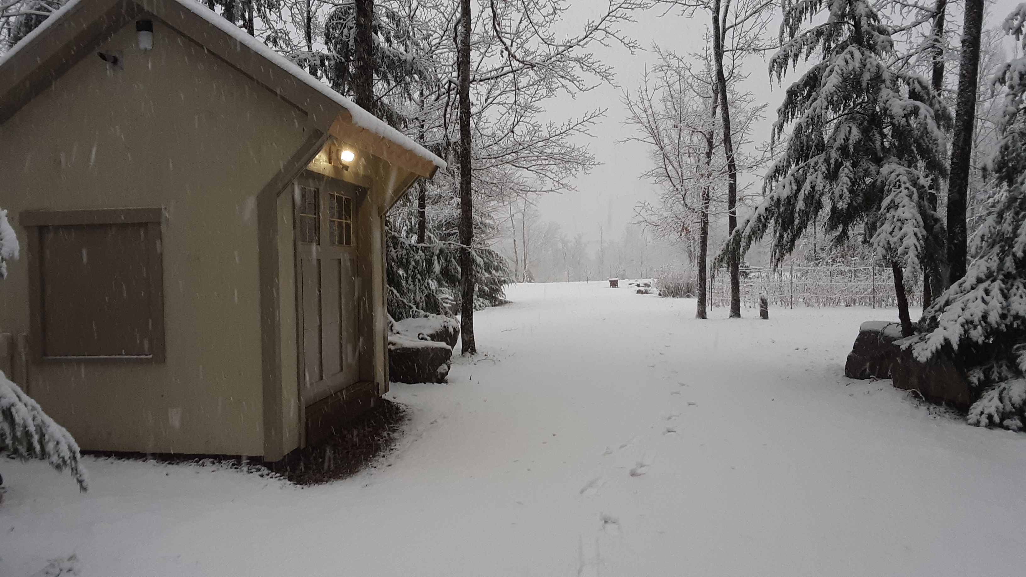

   / Your last generator Maintenance Run #4,689
With up to 15" of wet snow forecasted, and wind gusts up to 50mph forecasted, I just walked out to plug in Genny's block heater.
20201205_142418.jpgi
#4,690
You are all prepared Rusty.
Murphy - Move Along - nothing to see here !
Rgds, D.
