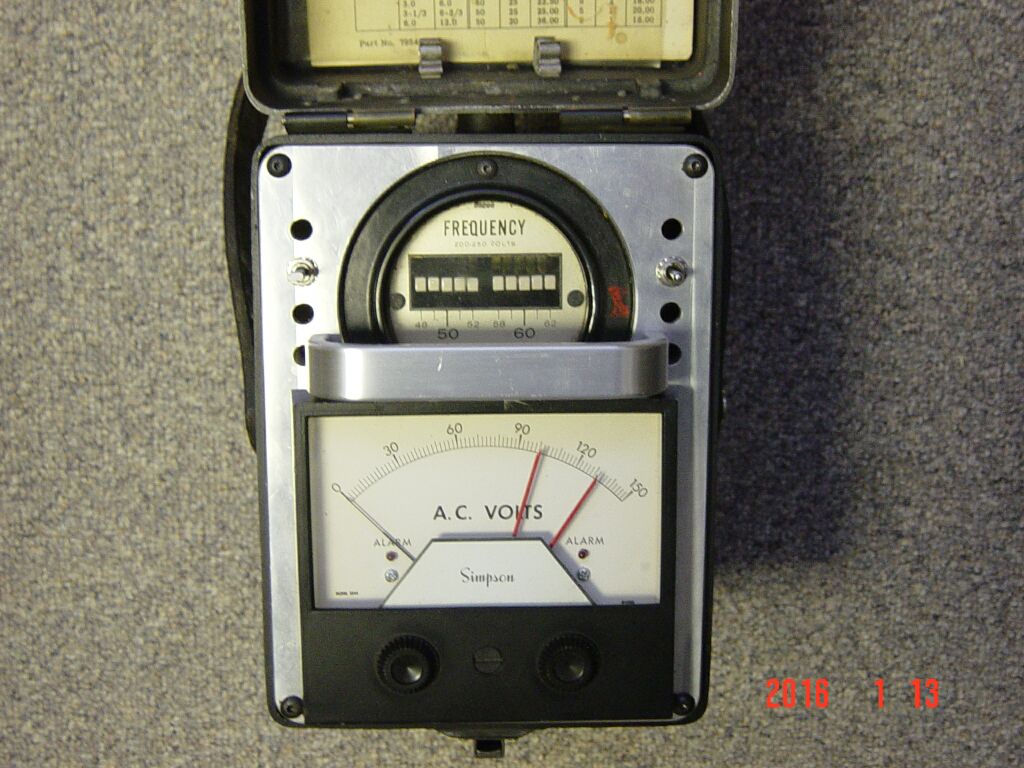

I like using this old Frankenstein type meter I built many years ago when I had a pto set. Has vibrating fingers. Also Hi and Low voltage presets/alarm. FOOLISHLY simplle and no programming sheet has to accompany it. HECK, it doesn't even require batteries. Can sit in a closet for ten years and you can drag it out and it works. The only thing it should have is a timer as it alarms whenever the water pump comes on if set too tight.
But really, I don't care if the Freq would be out 5 hz either way. I don't have a Hadron Collider and my clocks don't have to be in sinc with Denver.
   / Your last generator Maintenance Run #4,773
I’ve never seen a reed type frequency meter with 50-60 Hz span. The dedicated 60Hz ones had 1/2Hz graduations.
Simple for the win every time. They are almost entirely unaffected by harmonics.
I can't believe that you don't have one amongst your collection IT !
If it's not a Hadron, what type of Collider do you have ? :cool2:
I love it when old tech beats the ___________ out of Nu Tek...... reminds me why I went to school for engineering.....
