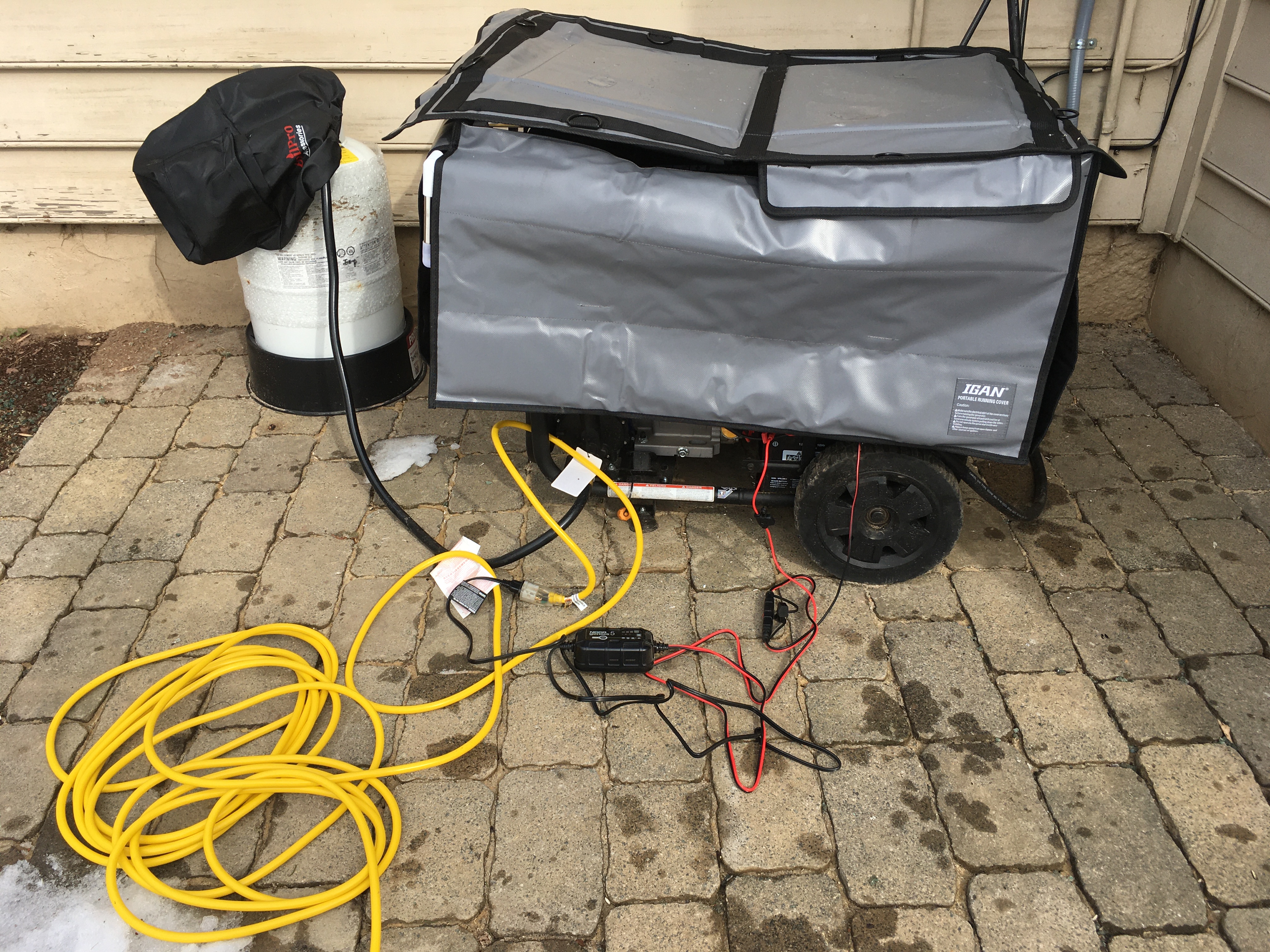

with the snow and ice coming in today and tonight, thought it might be a good idea
to top off the battery in the gen, which took all of five minutes using a 5amp smart charger.
Then I put another tarp on top of the main cover and plopped a five pound bag of birdseed on top to keep it there.
If I have to go out in middle of night to start it, hoping that just pulling on top tarp will make dealing with the snow easier.
Will be interesting to see if gen will hold a load in cold weather. If I do have to run it will keep an eye on voltage and make sure it's not dropping
