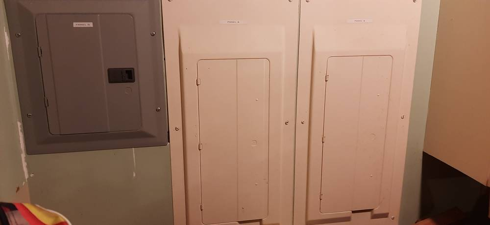

In Olympia the 400 amp service is split to two 200 amp panels.
Off to the side is a Gen Tran 8 circuit box with each circuit having a 3-way switch... Utility-Off-Generator.
Like has been said it has important circuits set up for 5000 watt generator.
Of course someone capable has to be there to run Generator and switch loads.
Not ideal but economical...
That's how this house is currently setup, however I want to be able to run anything I need (mainly the water heater and A/C during the summer), winter I use wood stove so no resistant heat.

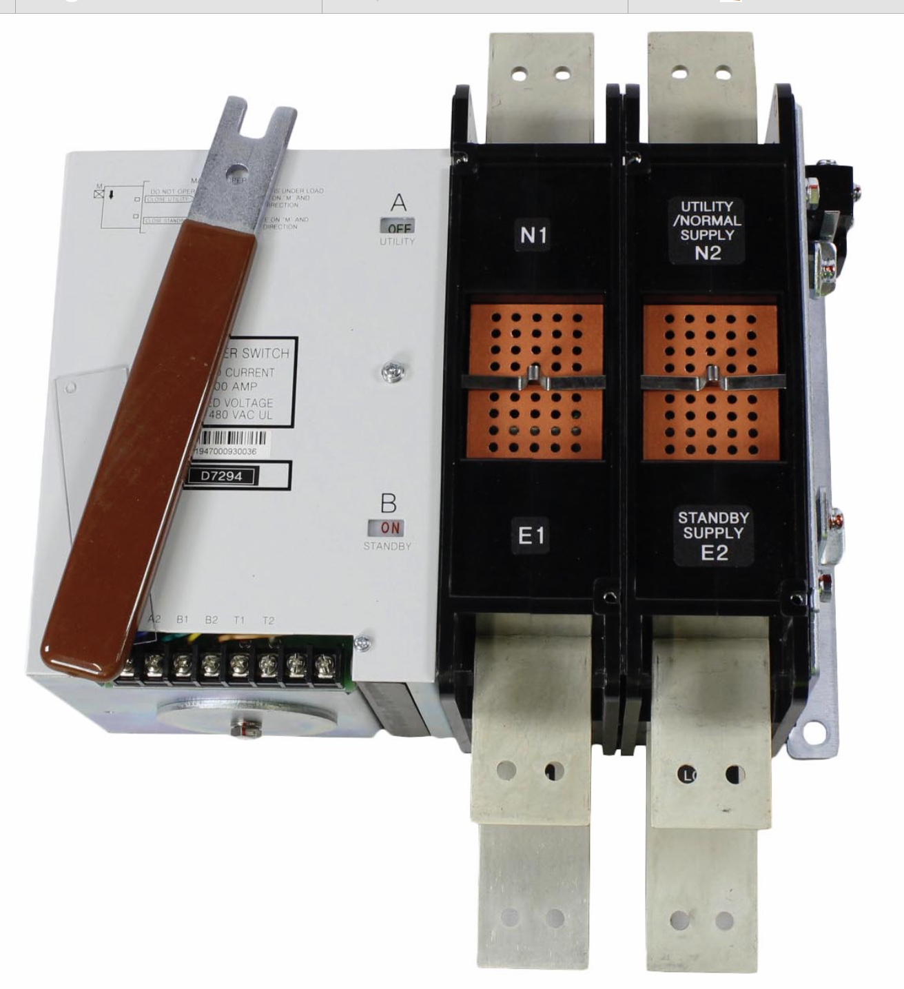

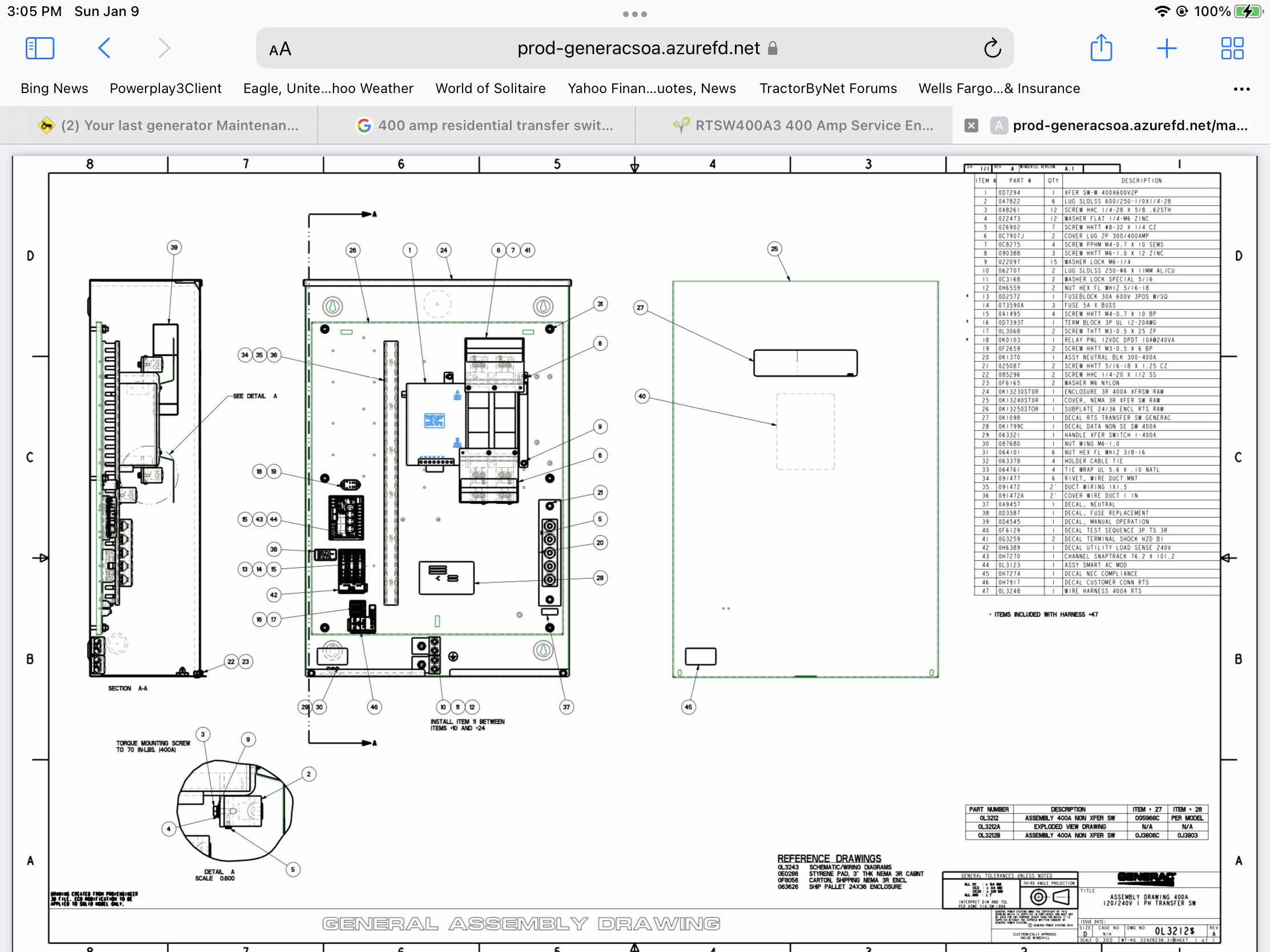

the 400 amp generac switch has a single 400 amp rated switch, at least the ones i installed years ago. They were so damn expensive, hardly anyone uses it UNLESS you have a generator that outputs greater than 200 amps, than you cant use a 200 amp or double 200’s. In this case, you HAVE to use the larger switch.
parts manual for 400 amp switch….single mechanism
if your lucky you have a meter set on a pedistal away from the house and you can add the transfer switches and generator away from the house. A big issue is where do you place the switches. They are aprox 14” x 30” units.
you can use an older generac switch on a newer generator with minor modifications (adding a fuse block for T1 power). You can use a newer generac transfer switch on an older generator, but the enclosed load shed module most likely wont work (its a crapshoot whether the older governor controlled generators will provide true enough waveform for the SACM load sheds used today, as compaired to the electronically controlled newer units). But you can always add SMM load shed modules, as these remotely sense a drop in frequency and shed a load. Be aware though, there are a series of generac units out there…..not sure of the model number though, that only came from factory with 58 hz output. Have no idea why this was done. They play havoc with the SMM load shed modules, and make clocks run slower when on generator.
View attachment 728576View attachment 728576
I figured it out, I was thinking of the B&S transfer switch, Briggs & Stratton 71057 400-Amp Split Service Automatic Transfer Switch + AC Shedding Service Disconnect
Looks like what I would need for my setup and less expensive then 2-200a Generac units! Would just take a bit more work to get everything functional but the hardware would be there at least.
