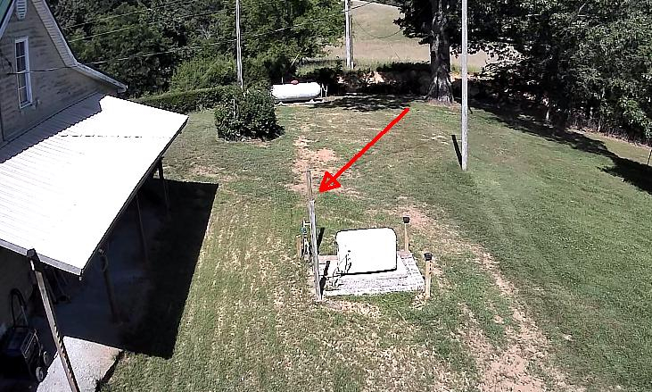

Not enclosed at all right now, other than the factory enclosure. I put the 4 x 4 posts in as sacrificial bumpers for the tractor, mowers, etc. The two at the house end are still around 6', so the thought is some 5' dog ear boards as a sound baffle. No air flow issues at all.
Modern Generac household enclosures I've been next to seem pretty quiet, but there are lots of variables......
Window A/C tend to leak sound and air, so improving that may be enough. I'd be tempted to build an "acoustic" (whole field of engineering right there, but as per the vid I posted, even crude changes can yield significant results) wall parallel to the house face, next to the generator. That ^ might be plenty on it's own - in my neck/woods, I'd also be tempted to have a sloped roof from the new wall to the existing rear posts.... but that's probably more because of the snow/ice here..... may be little/none your way.....
Wall one-side + roof, but still open on 3 sides shouldn't create any heat issues......
Rgds, D.

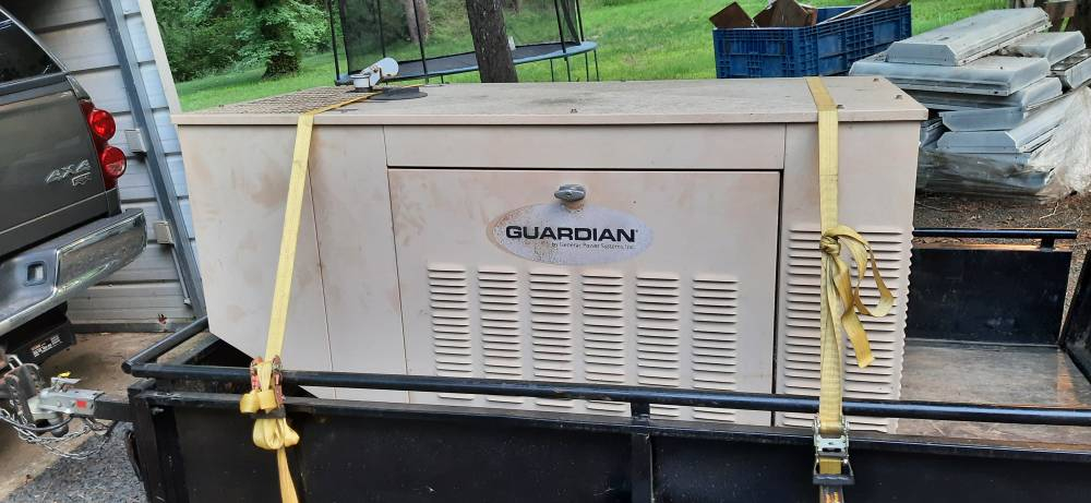

Hey grsthegreat, I just picked up an older (2005) 25k Generac, model 47253. Looks like the newer transfer switches will work with it.
I have 2-200amp main panels so I have to either run a 400a or 2 200a switches.
I don't think generac has a single panel with 2 200a switching gear inside like briggs and stratton does.
I think I did ok, $1k for the gen with 320hrs on it, was taken out of service 3yrs ago due to the stand it was on settling and needing an upgraded service rated ATS.View attachment 748953
Sent from my SM-G715U1 using TractorByNet mobile app
Sounds like a good deal, esp. where many prices have gone to these days.
Are you planning propane or natgas ? Let us know how the project goes.
