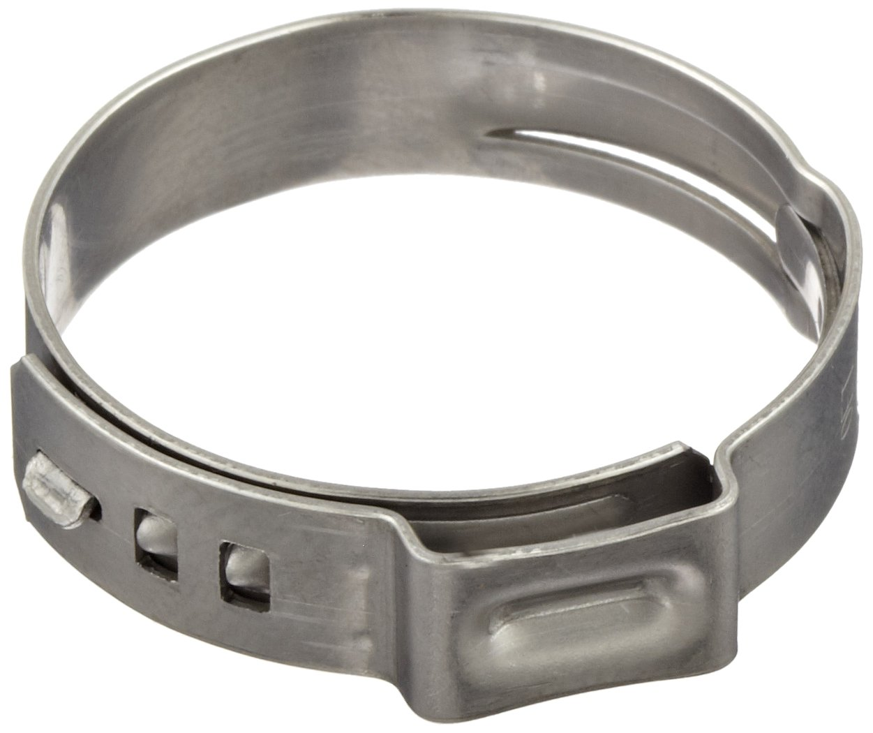

Got a new filter in & finally replaced it. Hate where they have it mounted. Angled away from the front & impossible to get to from the inside. Keystone/Carbon clamped the fuel lines wirh permant Otker clamps instead of spring loaded ones or good old worm gear hose clamps. Had to get bolt cutters into no room to cut them off. Then fight a rubber grommet you can't see for 20 minutes to get a socket on the filter you can't see.
had to look that one up.
learn something new every day
   / Your last generator Maintenance Run #5,885
We use those Oetiker clamps on generator oil cooler lines. Once crimped….never coming off except by cutting off.
