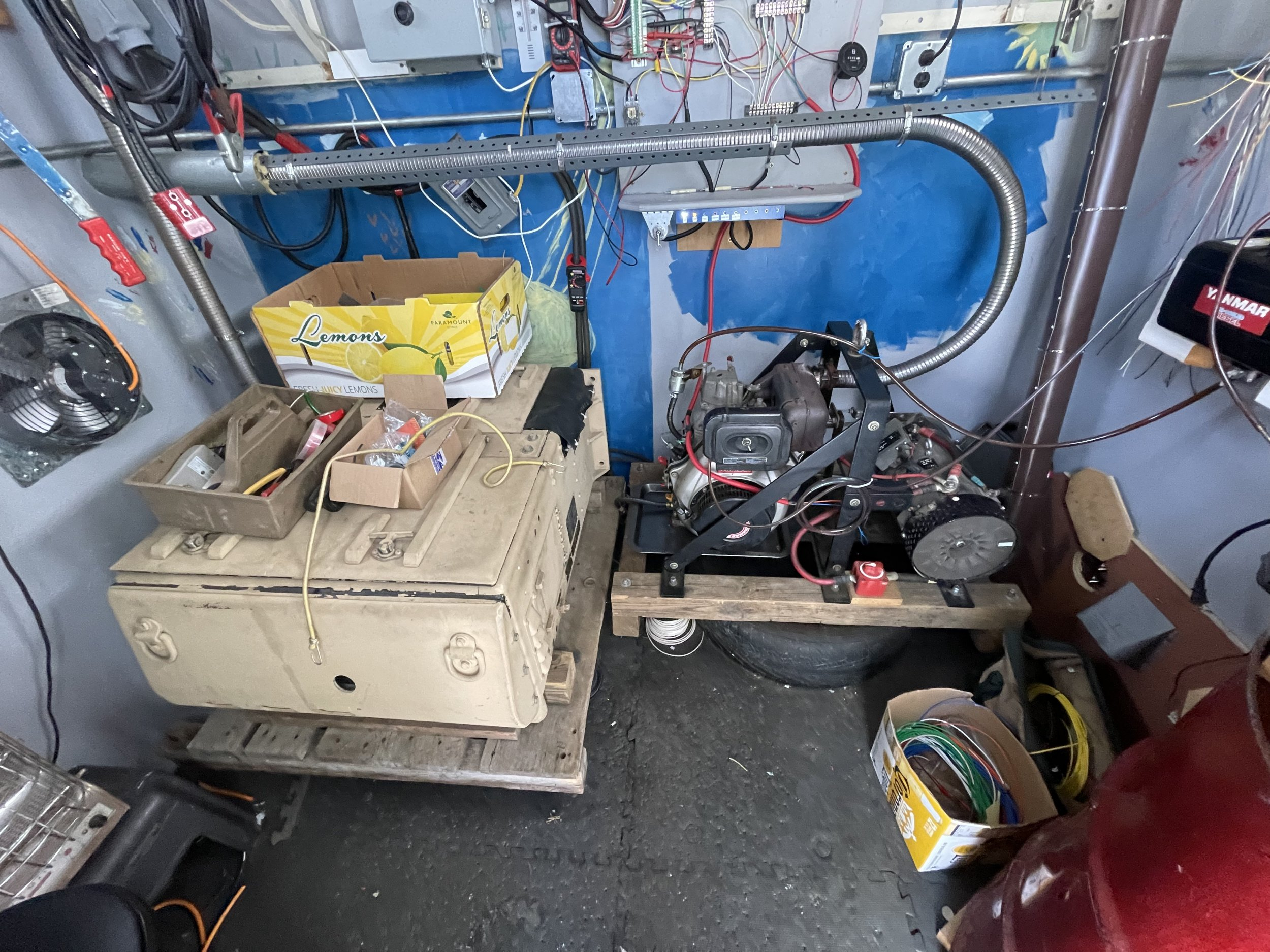

not to burst your bubble, most people are starting generators to get power back, how do you plan on powering a 1500 watt heatgun? thats a huge load
This is my powerhouse. These are my diesel backup generators. Both are 28v DC generators that support my 4kw battery backup. During an outage I can use inverter power or my Honda EU2000i portable if I have to do a cold black start. I have other backup sources if needed.
My second source would be a Yanmar L70 diesel portable that has a mil-spec Yanmar configured for extreme cold with 2 intake grid heaters and an extended 3 quart capacity deep sump.
This engine will start at minus 10 degrees F within 2 engine revolutions using the heater and is capable of running unattended for 400 hours with the deep sump and bypass oil filter system providing there is sufficient fuel.
I’m still in the process of tidying up the electrics.
I recently configured the cooling fans so one fan starts ventilating when the fuel in turned on and the second fan is programmed to start after the interior temp rises to 85 degrees.
Being air cooled diesels it’s important to have an environment that is warm enough to keep the operating temperatures up.
I’ve repaired 3 air cooled Yanmars that suffered from wet stacking from insufficient load in cold environments.

What are the characteristics of the oil that you’re using in your Yanmar and MEP generators. I don’t mean brand, but what type (syn/conv), viscosity etc. and what is the pour point of the oil that you’re using? Although cold diesels can be difficult to start certain oils can help in that situation….but still provide ample protection once they’re hot and working hard.
