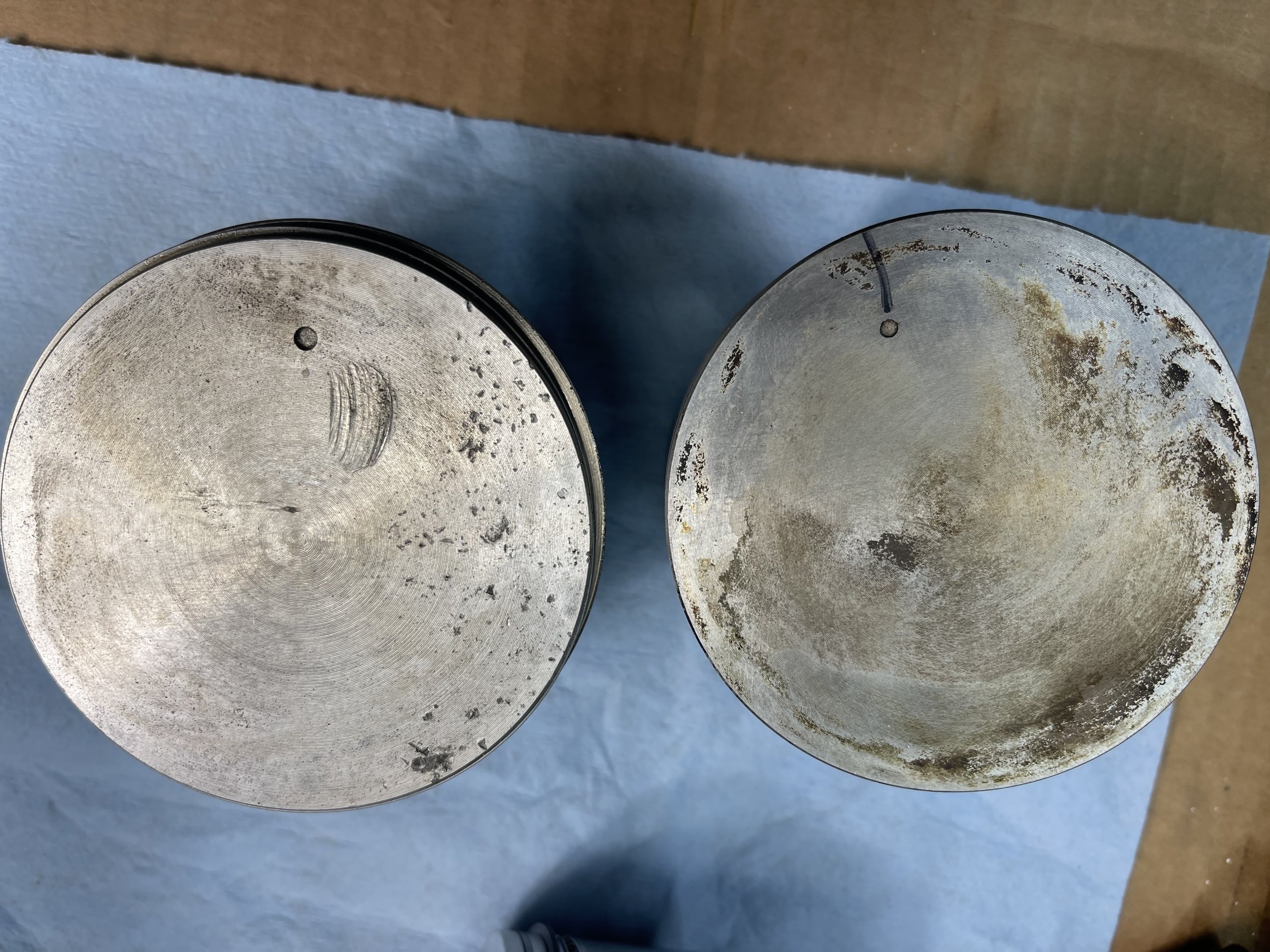

   / Your last generator Maintenance Run #6,399
You can save big by doing your own maintenance or it can cost you big time as this piston from a 15kw engine engine shows.
Unit was brought in with excessive blow by. Interior of unit was covered in oil.
I’m told it dropped a valve so they replaced the head & did a compression test which was 190 psi & determined it was good to go.
Didn’t work out so well.
I would expect much more damage if it dropped a valve!
I suspect something was dropped down intake🤨
Ordered 2 new pistons cut a valve seat & currently waiting on a couple small parts.
It will be used as a backup.
90cummins

OUCH !
Nice recovery though, as always ! (y)
