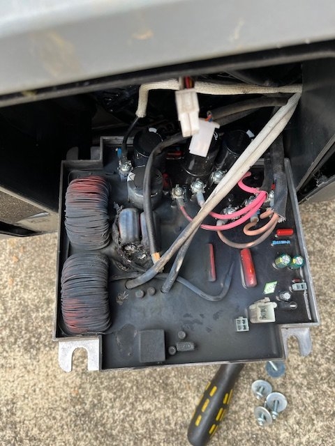

My 4 year old portable Briggs & Stratton Q6500 inverter generator (gas) has been working flawless until this past Tuesday when we lost power. Six circuits in the house breaker box are dual-powered through a transfer switch fed from the generator. On Tuesday, I cranked the generator with 3 pulls and flipped each circuit on the transfer switch to 'generator' and 'wa-la', power to the kitchen, family room, and central gas heat (2 units). All was fine and normal until the grid power returned about 15 minutes later. The kitchen flourescent lights started blinking, the generator speed controller started going haywire and the generator shut itself down. The remainder of the house powered up from the grid and I switched the transfer circuits back to grid, so the entire house was back on grid power. I restarted the generator just fine and set itself on 'idle' speed with the QPT switch on, but the power indicators stayed at 100% without any load. I checked the 120V and 240V outlets with the generator running, and there was no power. So, I pulled the inverter and it was fried (see below). Really don't know how/if grid power 'backing' through the transfer switch caused the failure or if the inverter just happened to fail at the same time as grid power returned. Anyway, a replacement inverter is about $600 and B&S have discontinued making these generators, so I am looking for a replacement generator with 240V circuit and at least 6kw. Any suggestions?
I switched to a Honda powered unit, just for the lower audible noise. But I'll leave specific generator brand recommendations to others who know the brands better than me.
But I'd like to get a look at that transfer switch, see if we can figure out what went wrong. The timing is too coincidental to assume this was a random failure. Got photos, schematics, anything for us to start digging on?
