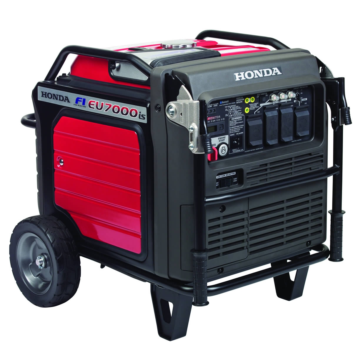

This EU7000is from Honda looks interesting:
I like the exhaust pipe extender kit and the app that lets me control it via my smartphone from the house. I can leave it in the barn, stop / start it, check the load, and read the fuel level from inside. It's also an inverter generator which, unlike the PTO genny, is safe for electronics.
Not cheap at close to $5k, but it's a fraction of what another tractor would cost. A permanent whole house generator is also a possibility but the price would be high with the required electrical work. There is also the fuel supply to consider. We don't use propane and natural gas isn't available. There are diesel models out there but they are even pricier.
For long duration outages, like the one that lasted 7 days during hurricane Sandy, I would still use the PTO genny. We heat with coal & fuel oil, so I can fuel the tractor for a month or more with oil out of our 1000 gal storage tank. I would still need the 2K Honda portable for the electronics though.
Gasoline storage is another issue. I keep a couple of 5 gal cans around for power tools and the small Honda genny. Might not be enough for the larger Honda linked above though. I rotate the gas in the cans every few months and getting more would just add to the chore. I figure I could always siphon gas from our 3 vehicles if necessary.

These big new inverters are nice. For my new one 11000/9000 I did the 5 hour break in on 2.5 gallons of gas, ran at 4kw for quite a while. With the variable RPM, they are quite fuel efficient, at least it surprised me. I kept wishing for it to run out so I could flush it with ethanol free fuel.
Sorry for the long winded rant and thanks for listening to my tale of woe.

Why do you say " It's also an inverter generator which, unlike the PTO genny, is safe for electronics."
I have had absolutely no issue with electrics on my pto generator nor has the farm and we have been using them from the 60's.
Depending on the quality of the inverter they can and have had issues with electronics as they are a modified sine wave and depending upon how many steps they make to make the full modified sine wave is important.
A used tractor is a possibility as long as it isn't someone else's problem. Finding a decent one for $5K would be a challenge. There is also the storage issue. It would have to live outside.
It depends on the generator and the electronics as to whether it can do harm. I'm involved with A.R.E.S. and am usually on the air during outages. I lost a $2K digital ham radio to the PTO genny I have, so I guess mine isn't good quality. I've never had an issue with Honda inverters.
