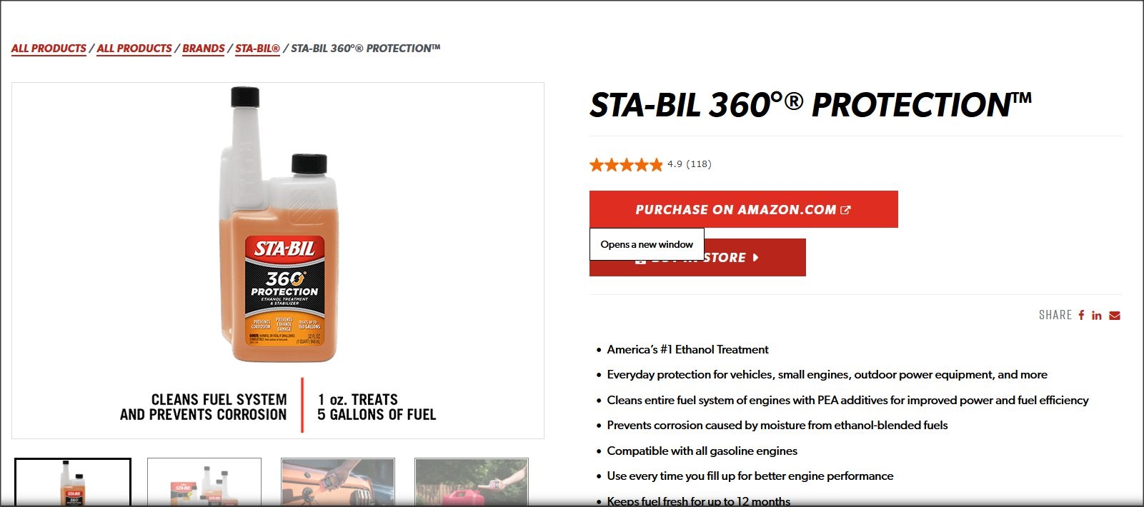

You mean Sta-Bil 360 which is the one to use for ethanol containing fuel treatment.
I have used it for several years in small engine fuel and it works as advertised!
Well, that's probably what I should be using, but it's not. The bottle I have is red and just reads "Stabil". Since I've honestly never had a problem related to e-gas, I haven't put much time or energy into sourcing and buying the best stabilizer.

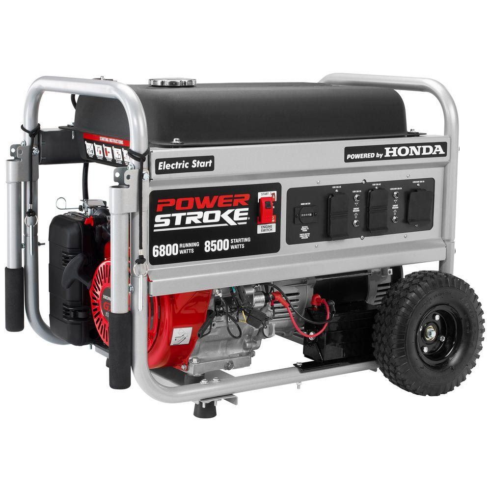

Did you do your own propane conversion? My portable genny is the ubiquitous PowerStroke 6800 with Honda GX engine, that I see all over, I guess they're pretty popular. But they're gas only from the factory, and the propane conversion kit I found for them back when I bought new involved cutting the frame. Some folks reported issues with that, as it really weakens the thing, with regard to travel if you load it onto a truck or trailer, or tote it around on the back of a tractor.
If anyone knows of a better propane conversion kit, I'd be interested. We have propane in our garage already, feeding a space heater, so it wouldn't be hard to tee in another line on a quick disconnect fitting for feeding the generator when back-feeding the house.
