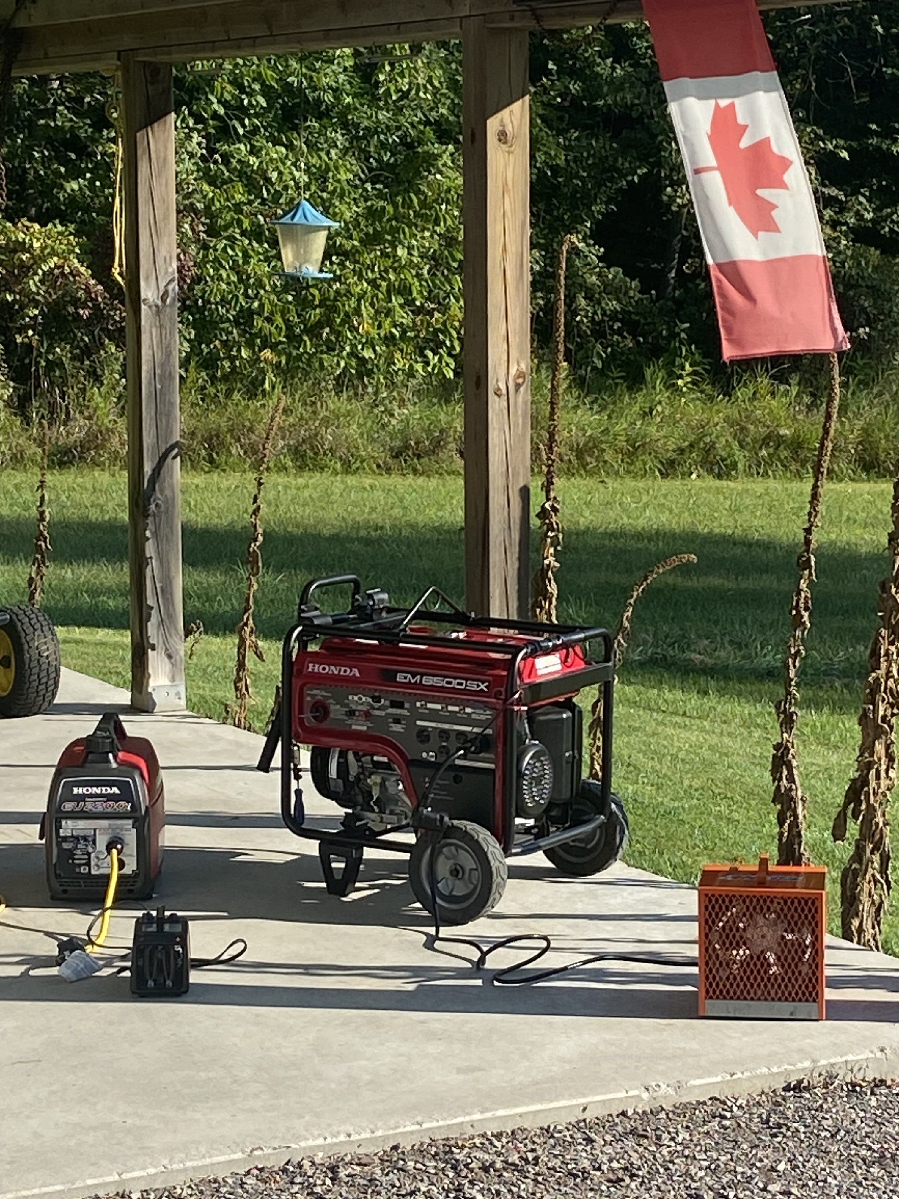

Fired up my Reds for their half hour of exercise. I set the small heater to 750 watts (sometimes 1500 for a few minutes) for the eu2200 and I just purchased a used 4800 watt 240v heater which gives the em6500 a good workout. Can someone confirm if I’m balancing the load properly by running this heater at the 4 prong L14-30 plug ?

Construction heaters make great loadbanks. Used to have a bunch of outlets on a board to connect 9 heaters up either single phase or 3 phase to test gensets on mountain tops. A bunch of heaters are a lot easier to load into a helicopter than one big loadbank.
