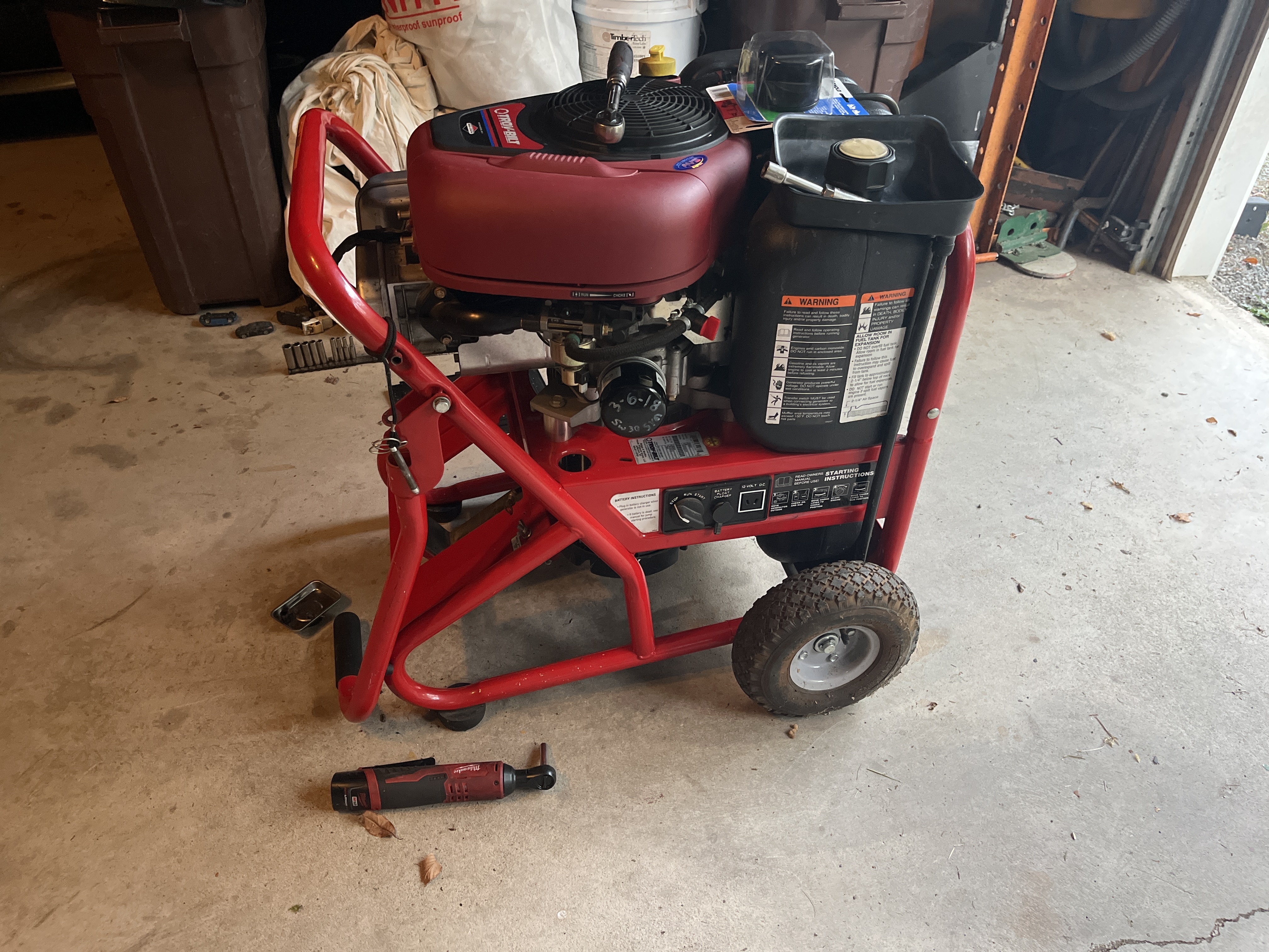

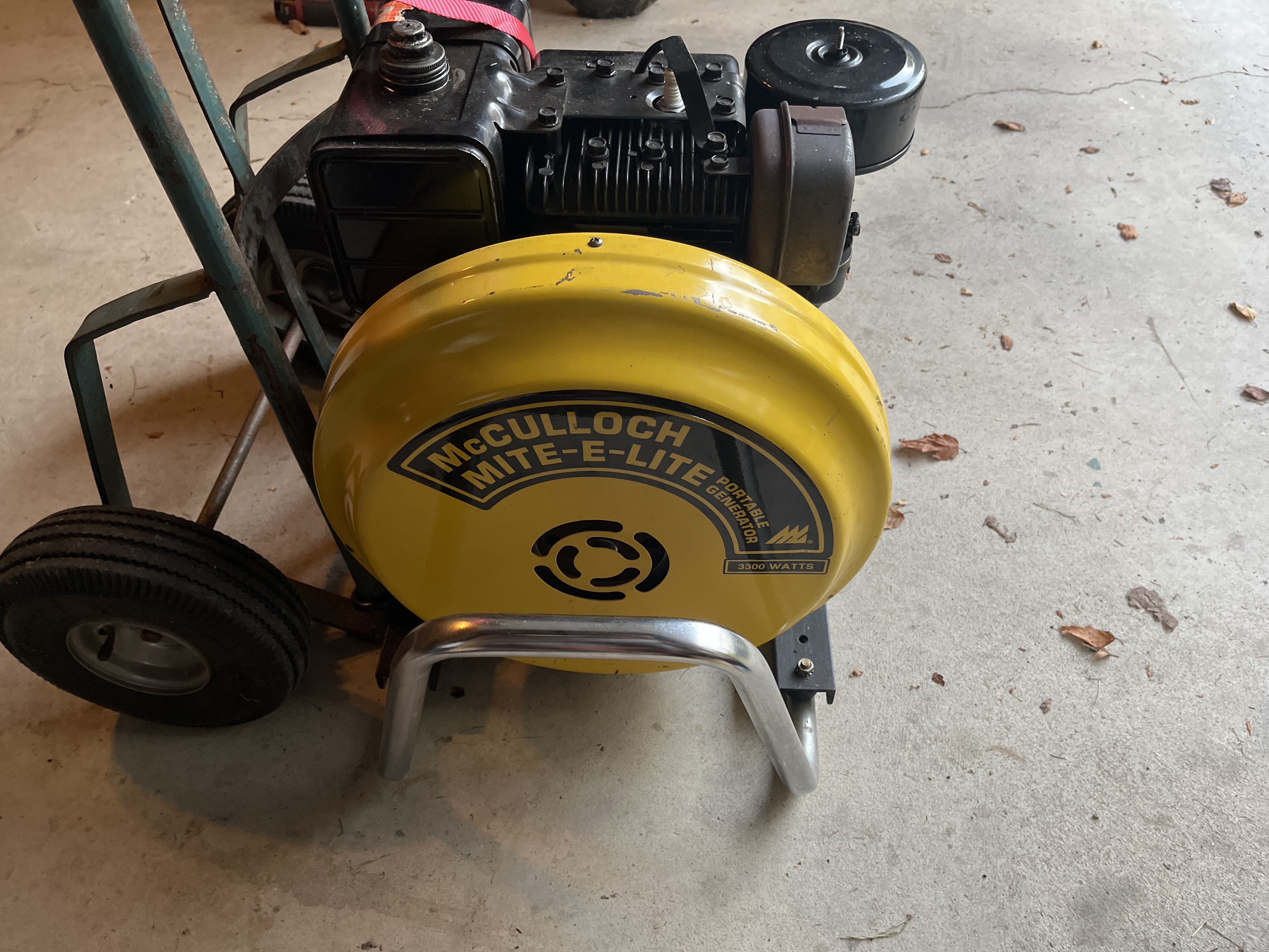

Went up to my mom’s house today and got the 2 generators out of the garage for her. Brought them down to my garage to clean them up, service, and sell them. One is an old McCulloch 3300 watt job, with a flat head Briggs on it. Vintage 70’s.
The other is a Troy Bilt 13kw with an electric start Briggs OHV. Last time they were serviced was 2017. Probably haven’t been run much since. I need to drain whatever gas is left out and put some fresh in to test them. Luckily both have fuel shutoffs and were run until the carb was empty.
Picked up an oil filter and plug for the Troy Bilt from ACE hardware.
View attachment 1169439View attachment 1169440
Started the McCulloch today. 2 pulls. 1st pull choke on, didn’t fire, smelled gas from the muffler. Turned choke off, second pull it sputtered to life. Ran it with a 1500w load for 15 minutes. Then changed the oil with 30w. Checked plug and air filter, all good.
Had about a quart of gas in it and it was sloshing out around the gas cap. Gasket is probably not sealing plus It’s a little bent, so I ordered a new one from eBay.
