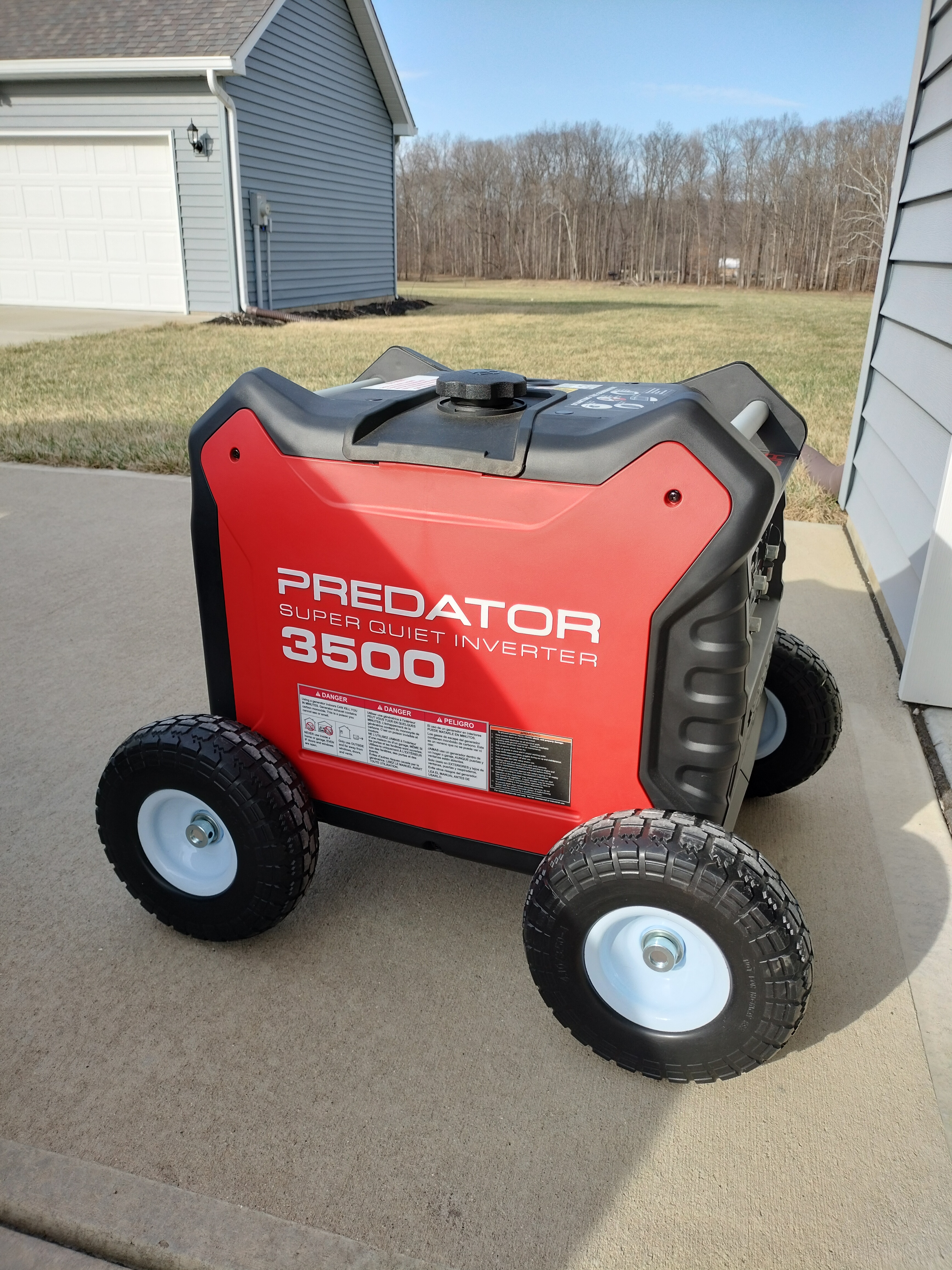

Started second pull... With the storm tonight, it seemed like a perfect time to verify.
Testing Done - Check. Now, grid will stay up, no problem, and storm will pass you by..... :cool:
I love those wheels. Most factory wheels are useless outdoors.
In the Tech World (and elsewhere....), First Mover Advantage..... you get to enjoy (only briefly in Tech) a price-premium for a unique product.....
Thinking about that ^, while having a coffee-break..... In Canuckland, you'd think that The Wheel had just been invented, if you ever go to buy a decent equipment wheel.....
Rgds, D.
   / Your last generator Maintenance Run #7,387
i think we all like those big wheels, what a good idea
maybe having one that locks?
cheesy wheel on my gen almost fell off
