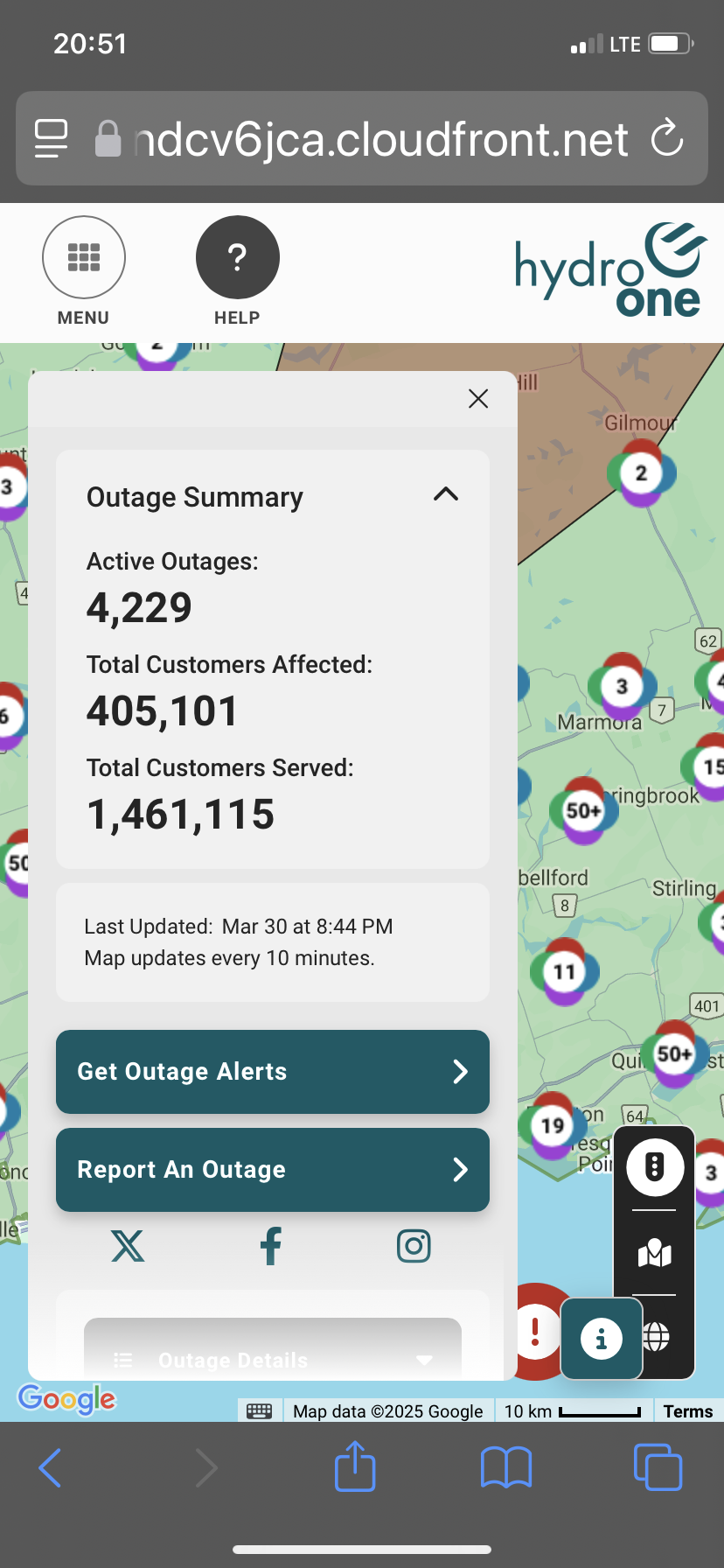

Back ice-storm here, Central/East Ontario.
Out for 14 hours @ home, 7kw Briggs did fine. Needed the sump pump moving a LOT of water, job done.
Electronics..... some interesting things along the way. Got up @ 3am, could see this area not yet reported to hydro (Canuck Elec Util), so called on my wife's cell that I had the map on...... after about 10 minutes, it wasn't a "normal" call drop (lousy cell coverage), but got a BIG pop-up that said "This network is not supporting Voice calls at this time". Shedding load, with the tower on Emerg pwr.....
So, one of the reasons I still have a landline, is for times like yesterday...... spent 30 minutes on hold, to get someone live to report the outage early. Then..... got my gen running in good time.

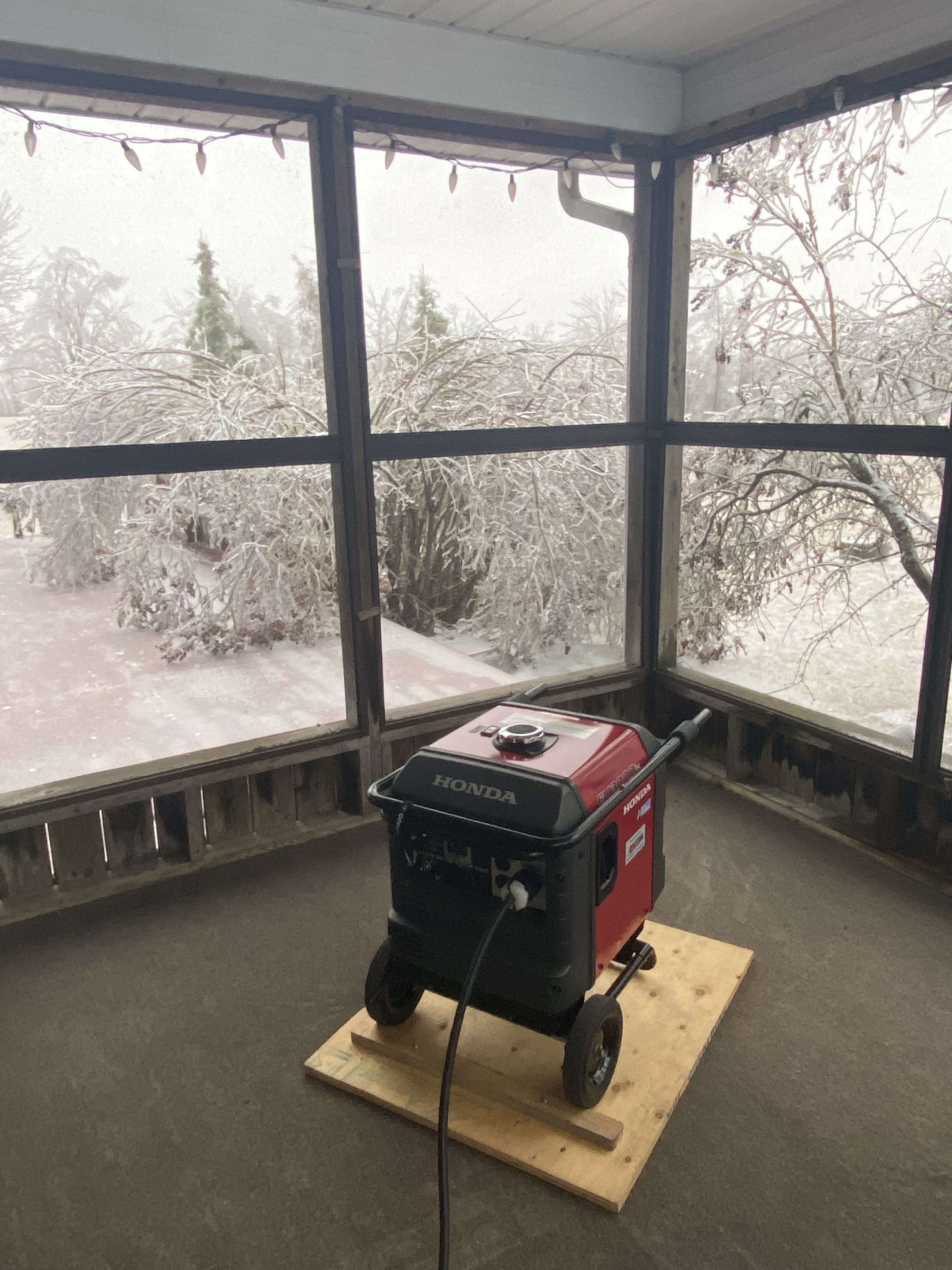

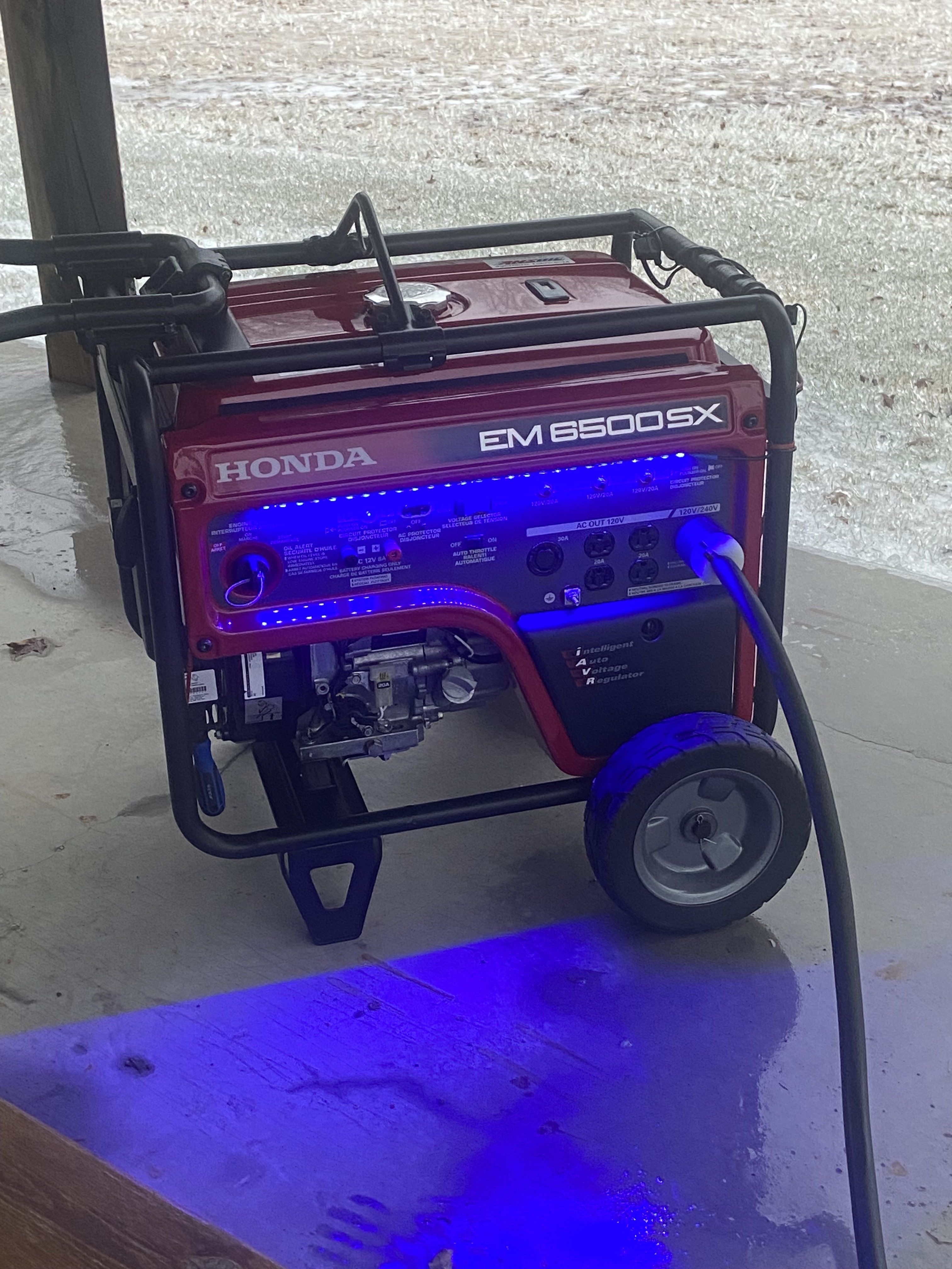

Yep, been running my Reds for about 12 hours, alternating between the two, since Sunday due to the ice storm here in eastern Ontario. Restoration is promised for tomorrow late. Time will tell…
