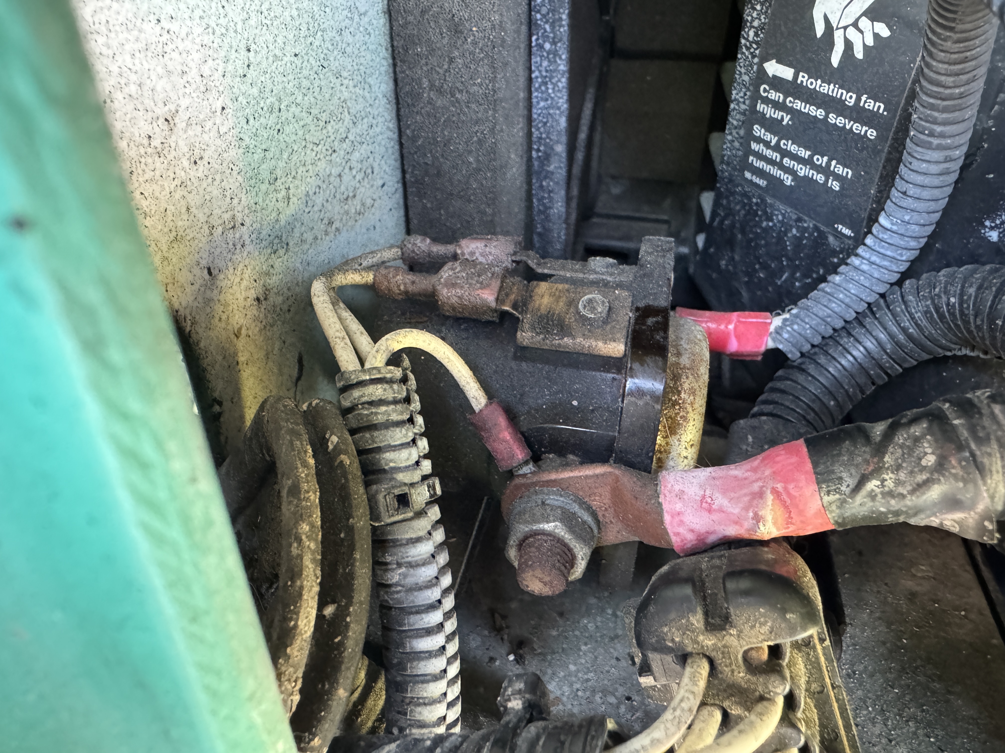

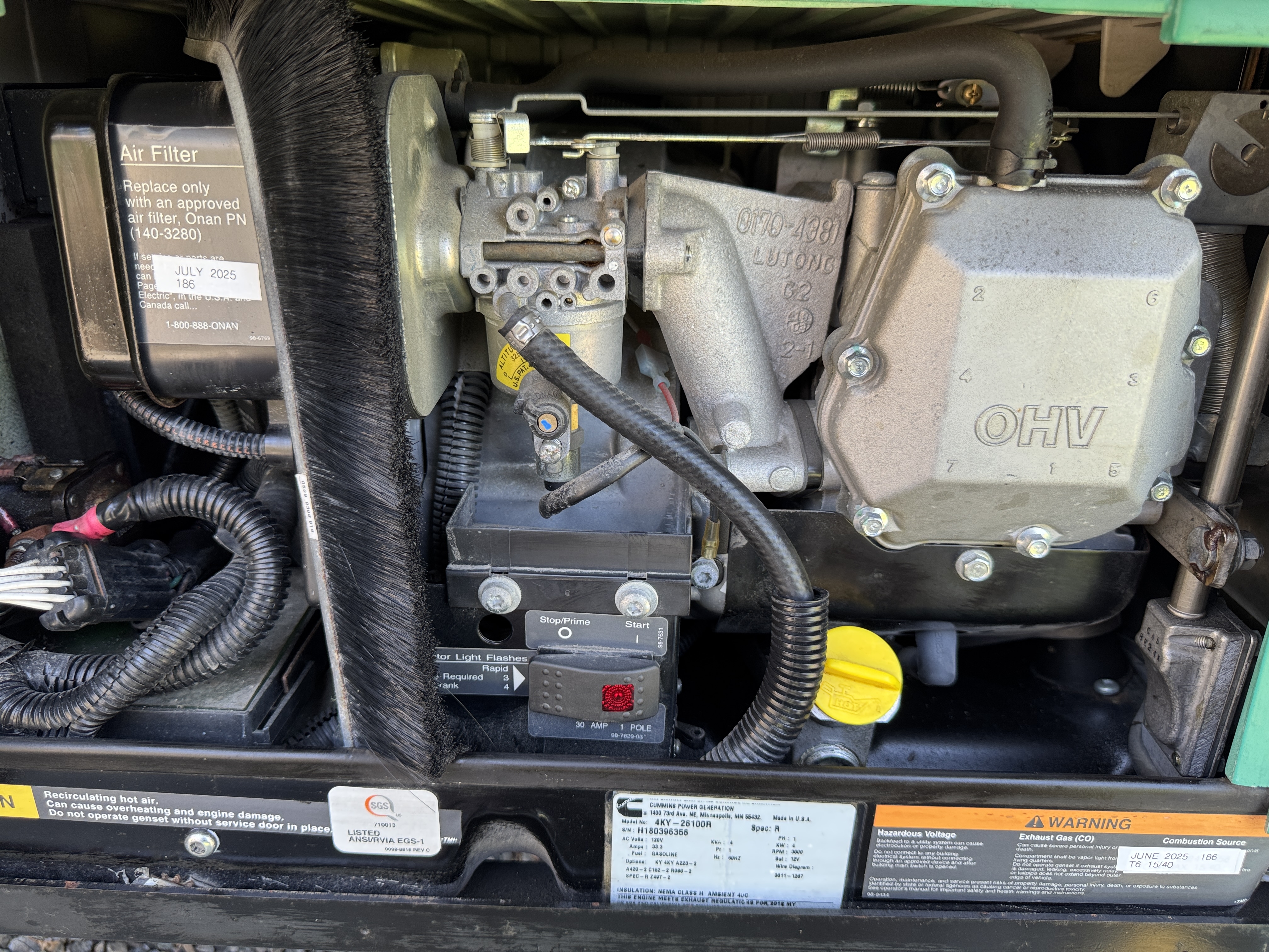

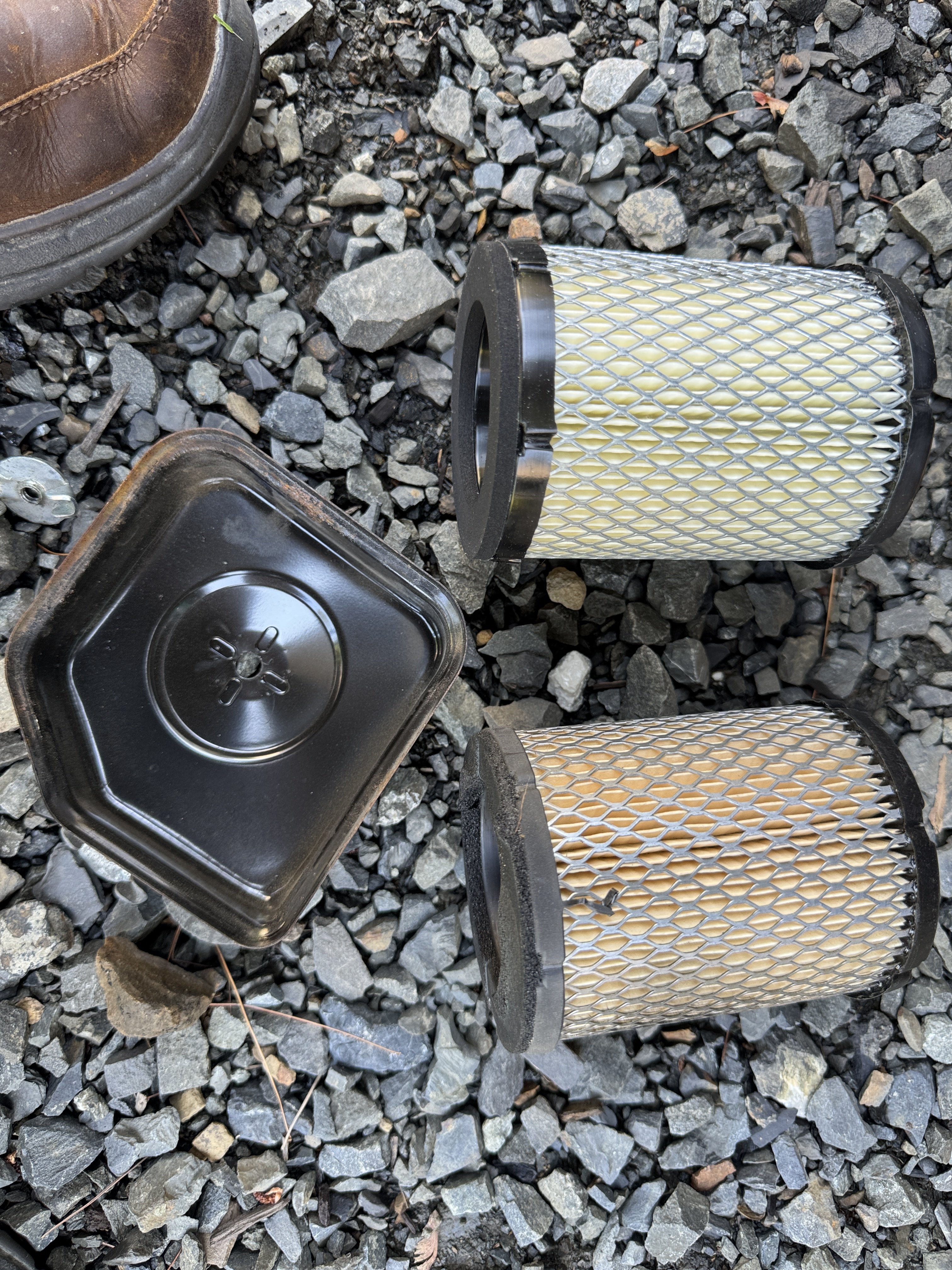

finished maintenance on my rv gen this morning, changing out air filter element
after a year and 30 hours, but across the US and back. Slight change in color; I rarely use this gen,
normally plugged in at campground.

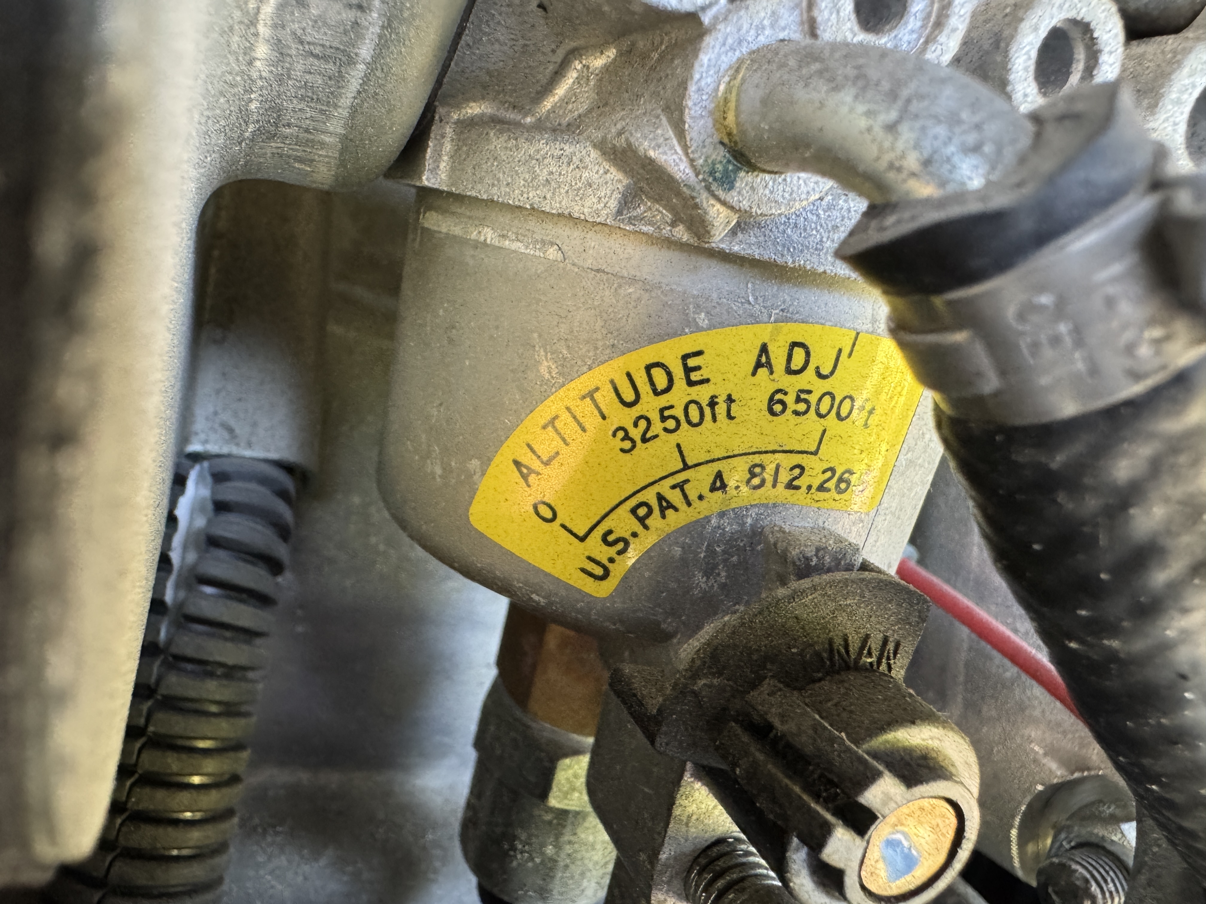

interesting adjustment on carb plainly marked to adjust based on elevation. First time I've seen that.
wiring connections had a little crud on them, cleaned them up and sprayed waxy oil on them. Cleaned everything up
with 303 protectant, ran the gen, put on my service stickees and job was done.

Onan perhaps ?
I seem to recall seeing Elevation stickers on some RV Onans, once upon a time....
