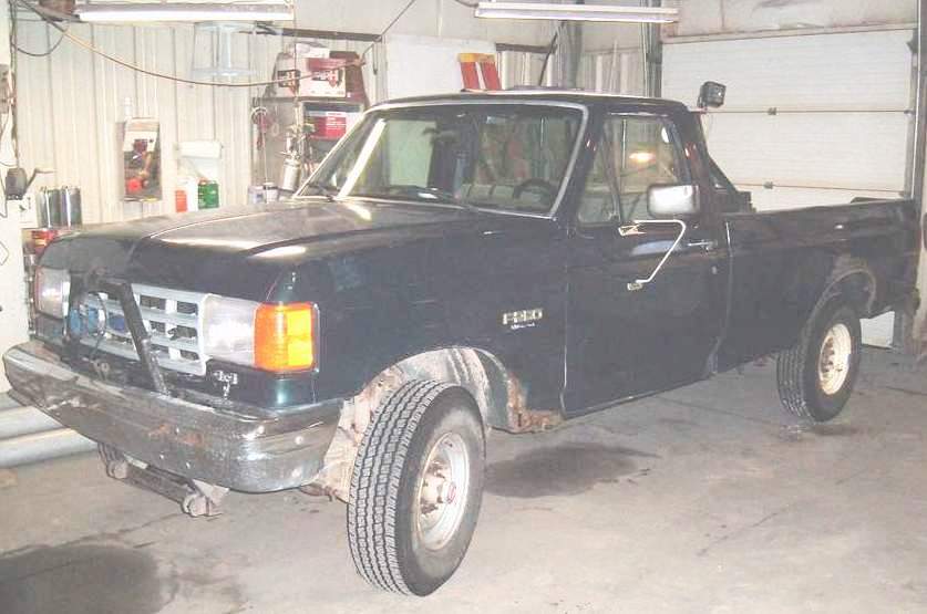

/ Your NEXT Snow Removal Setup #18
NICE, clean little ARTICULATED Wheel Loader. Hard to find older ones that nice. Did they have a torque converter?
