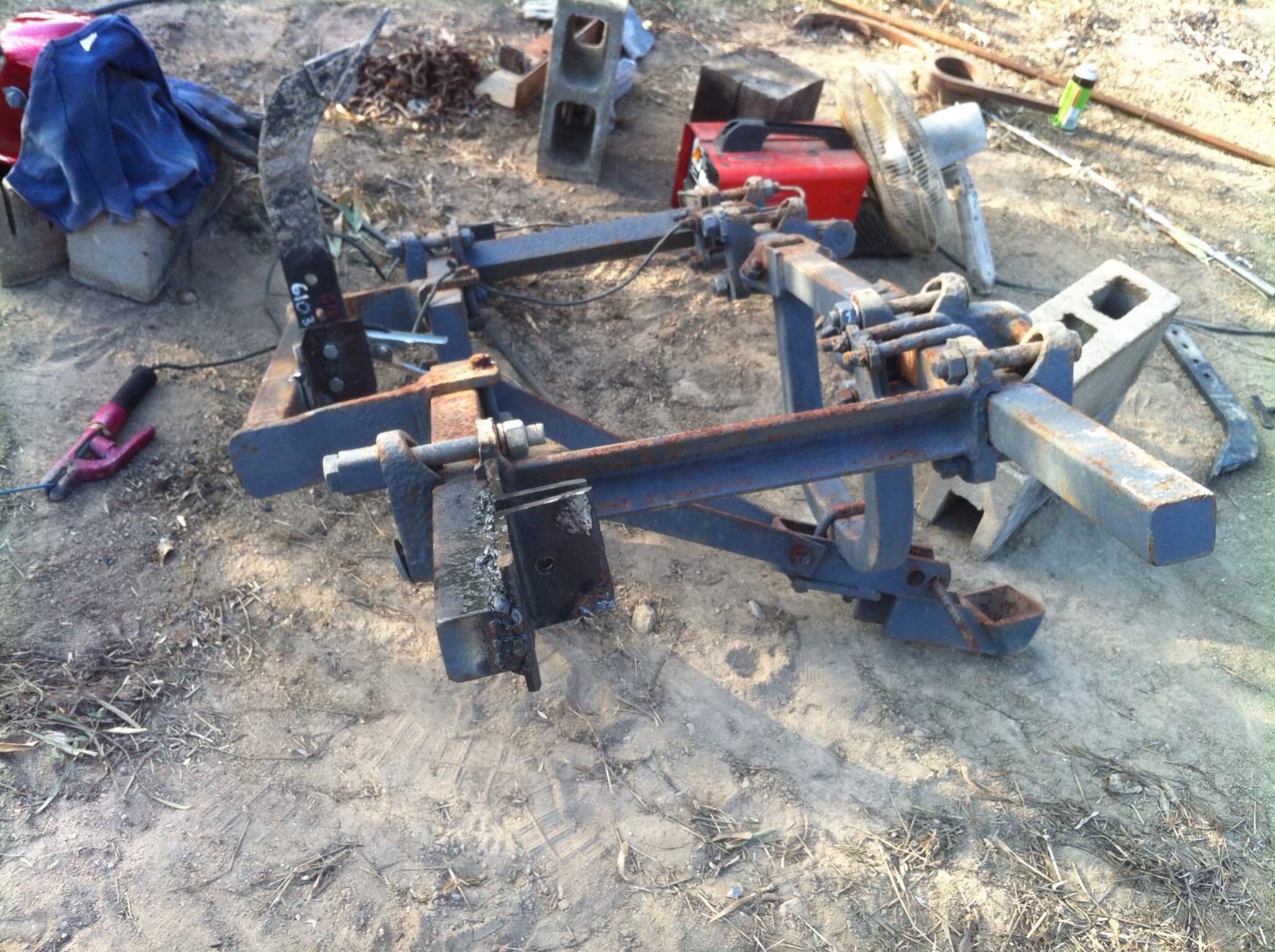

Finally got a couple of ripper teeth delivered.
I am going to weld 2 pieces of angle iron to the leading edge of the tool bar.
Drill the angle iron to allow me to bolt the ripper teeth between them so the force is against the tool bar rather than the welds
I have the metal cut to size and drilled.
This is how the teeth will bolt to the angle once it is welded in place
Next week weld it together.

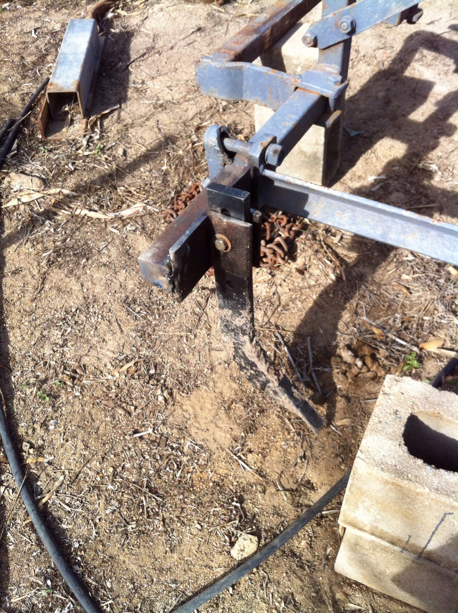

Well 50:50 one ripper tooth held but the other snapped the retaining bolt.
So I will adjust the tooth mounting point and re test

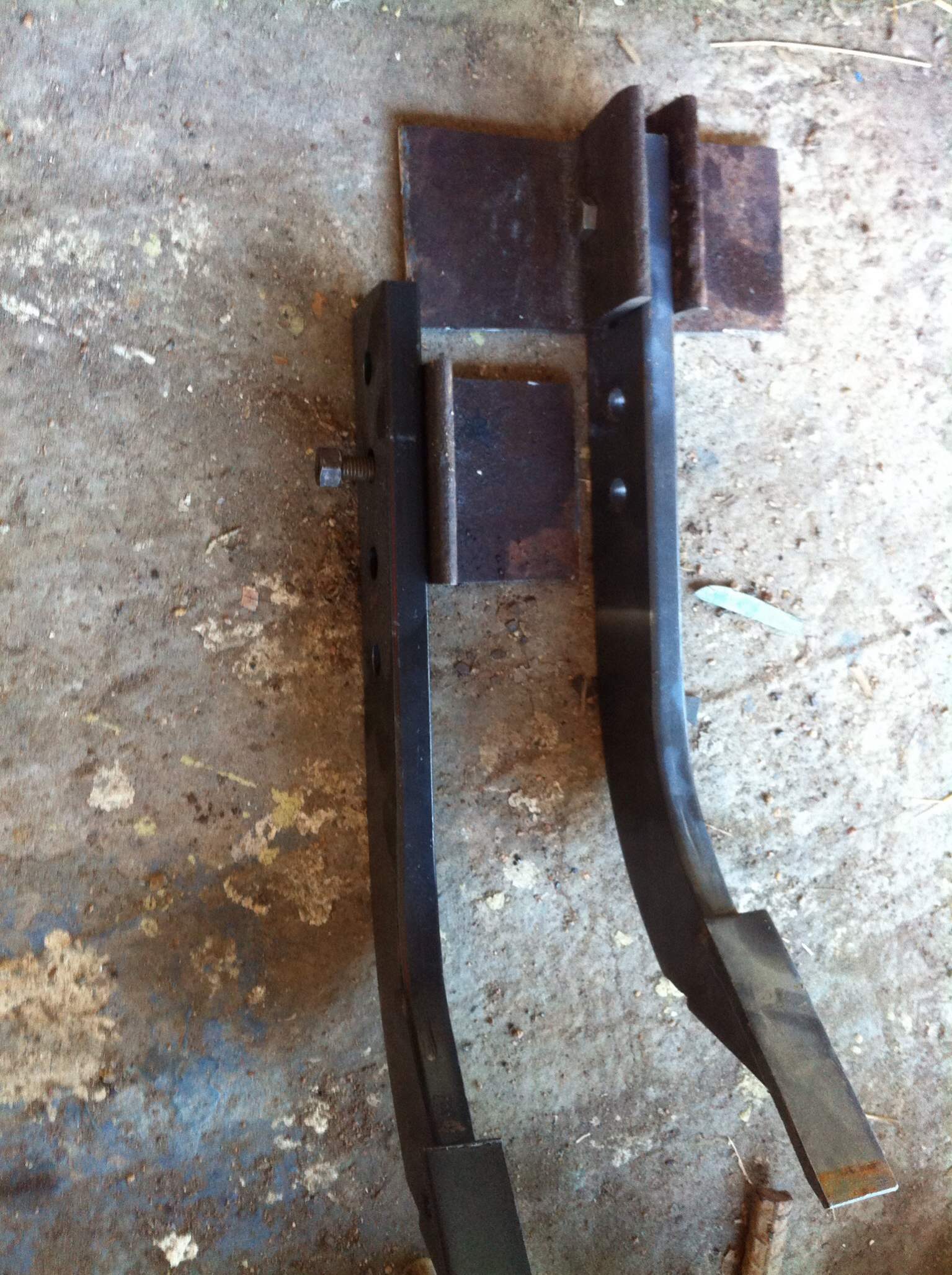

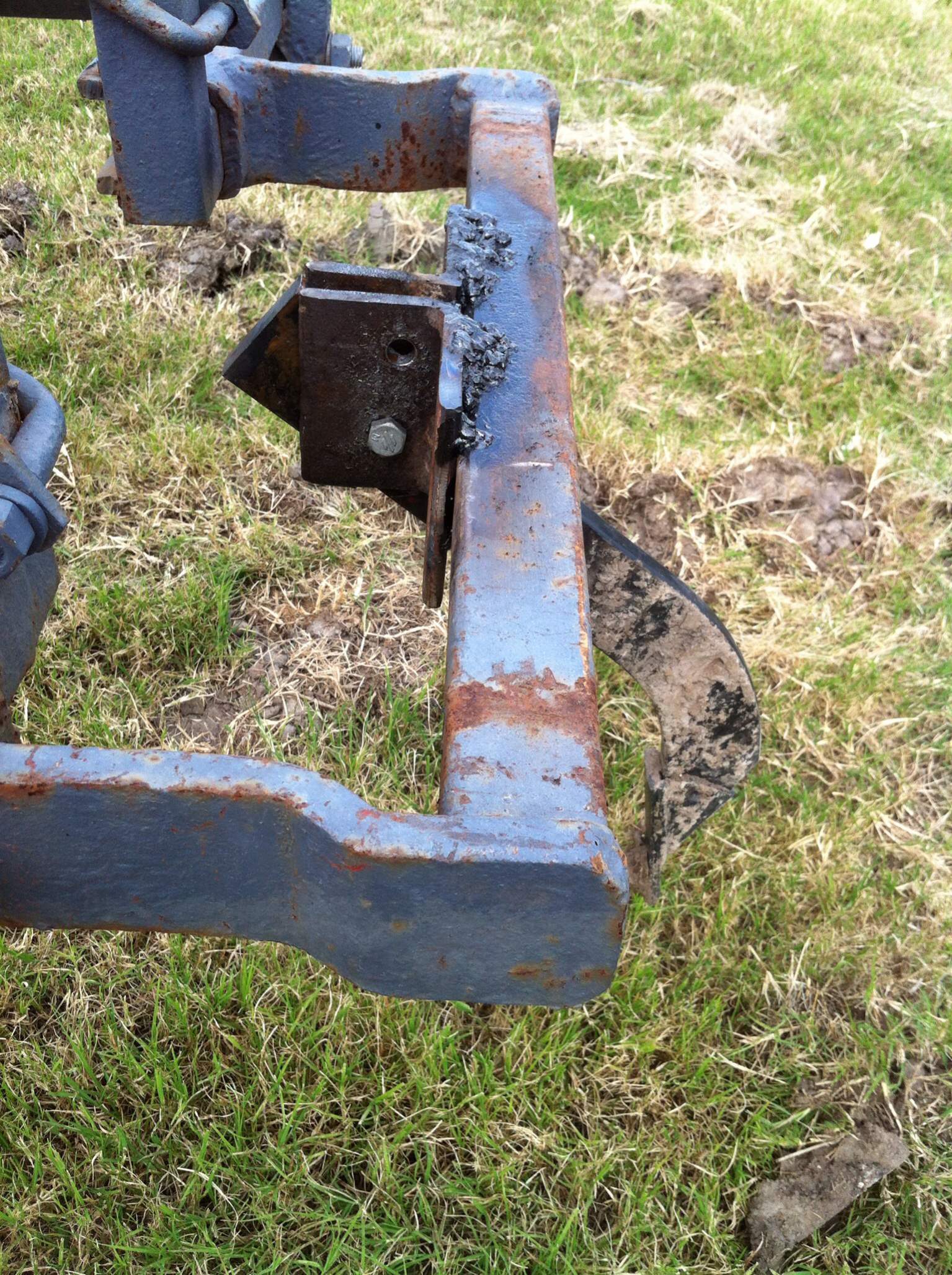

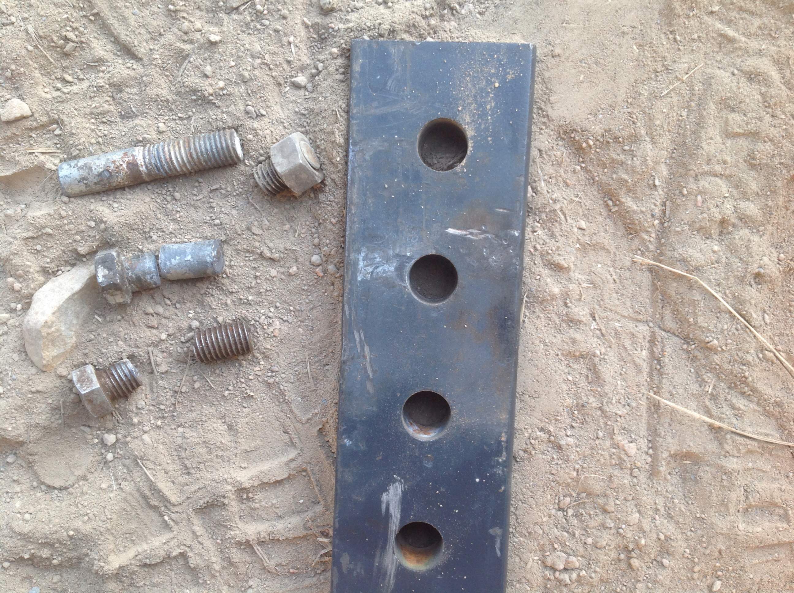

Not so great.
The retaining bolts on both teeth sheared. Better them than something more expensive.
But I also see that the locating hole in one of the teeth has been expanded out of round slightly.
I will re drill the angle iron holding the teeth to the tool bar for 2 bolts, after that I can only guess that I will need thicker bolts, current ones are 12mm or just under 1/2 inch.

It looks like the center of the bolt is not very far above the bottom edge of the bar that forms the back of the pocket for the ripper. That will give the ripper too much leverage on the bolt. You want to spread those points of contact out as much as possible. If you weld in some pieces of flat bar to fully enclose the pocket front and back, especially the top front and bottom rear, so the bolt is only setting the height, you should have better luck. Most implements that use those rippers put them in a fully enclosed pocket.

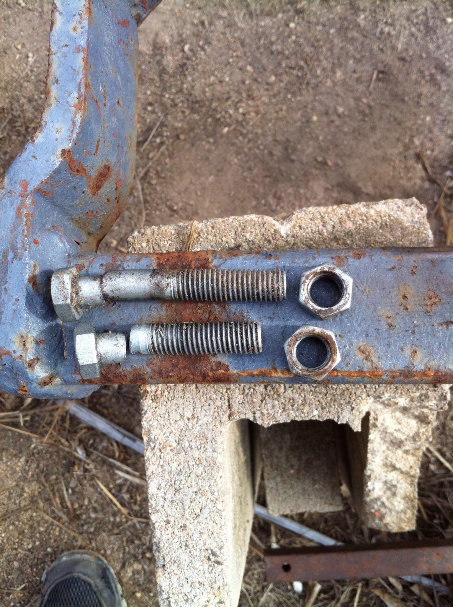

Thanks Brad
Looks like it will have to be a redesign like you suggest.
I did make a 2 bolt attempt and that just sheared. So I will have to find a Pocket design to copy.image.jpg

One bolt sheared through, the other part way through.
