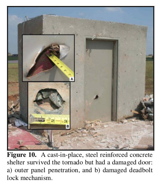

My plan for the storm shelter is to drill into the slab and epoxy in rebar going up 8 feet. Then set block around the rebar and fill the cavity with concrete as I go. For the roof, I will create a grid of rebar , form it and pour concrete. I've never done a roof before, so I still need to spend more time researching it.
For the door, there are some for sale that seem to run about a grand. I haven't seen what I can get from Home Depot or Lowes yet, just a few google searches. I also saw that some use three deadbolts to hold home made doors in place. Considering the cost of the door, I might just weld something together myself and go with the deadbolts

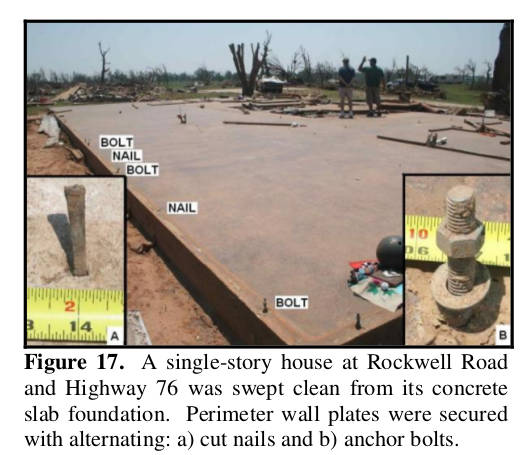

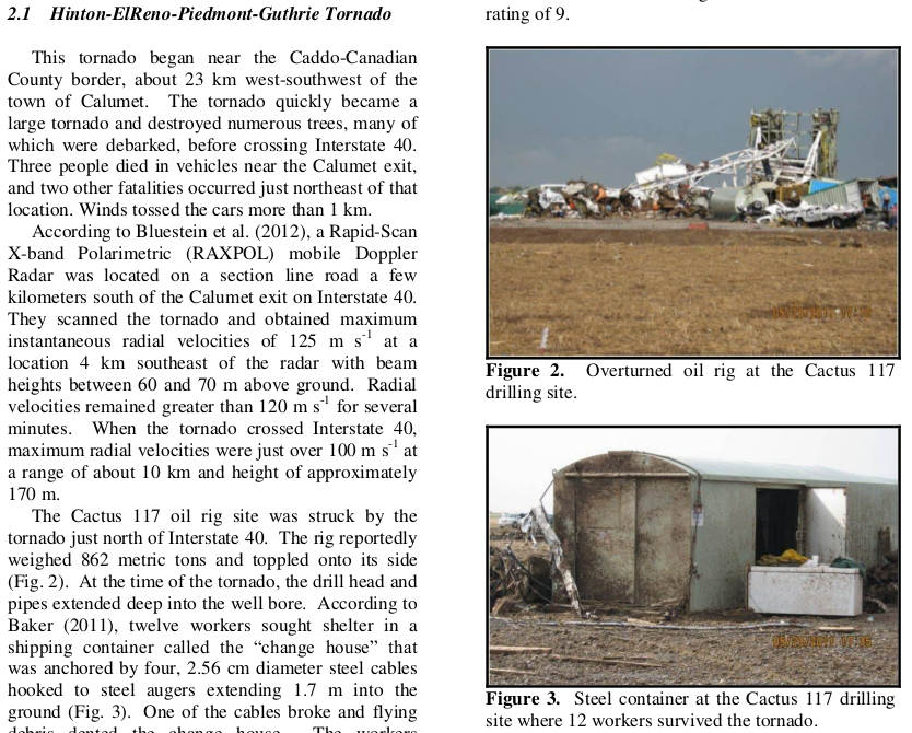

Read the 2011 article and see how the structures failed. You would be far better off to cast the rebar into the floor with a 90 degree bend instead of using epoxy, that is likely to be your weakest link. The steel container that the drill rig employees survived in was anchored with 4x 1" diameter steel cables and the wind force on the container was so strong it broke one of the cables. But fortunately the other 3 held.

Picture of the drilling rig which weighed over 800 tons which was toppled by the tornado
Anchor bolts and nails which failed to retain wall to foundation
Impact damage to steel door of above ground "poured in place" shelter
