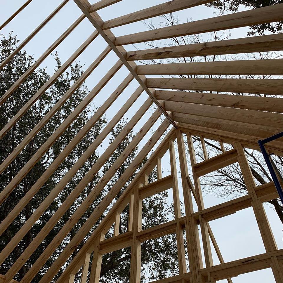

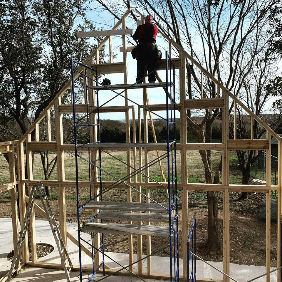

Thanks Randy. The place where the damage happened said that they had high winds, but hasn't replied to any of my questions. I asked another friend in the area, and she said that they winds where not very bad at their place. I looked online to see what was reported and only saw the winds in the mid 20's.
Regardless of the wind speed, the framing on the wall has some horrible flaws. One of the reasons that I haven't heard back from them might be that I said that it might have been a blessing that it collapsed now, and not later on when it was all done and people where inside there.
Here are a few more pictures that I found on her FB page.

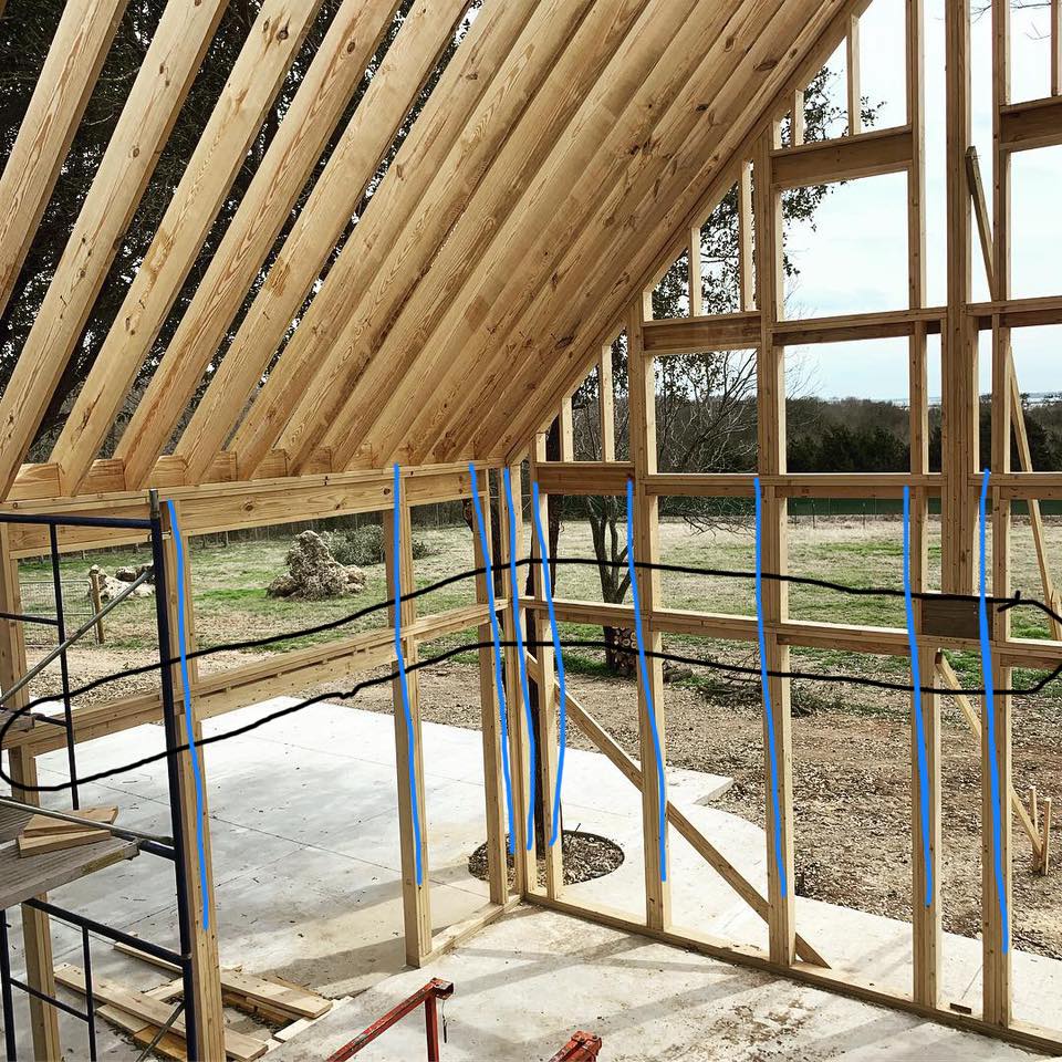

I think this last picture shows the main issue. The studs only go up 8 feet and then they started framing again on top of the double top plates. There isn't any strength there to keep the wall standing up straight and it just folded in on itself.
You nailed it it is like a deck of cards just waiting to come down. Not one stud going up all thee way. Also if you look close at the very first pic. you posted, they don't look like 2by4's ?? If you compare the 2 pieces of scrap wood to the plank on the staging it's thinner even the rafters look thin. Maybe it's just the angle ...

I see a few small issues with the end wall but in theory, it's just an end wall that might be a little bouncy without continuous framing members full height, and the framed roof should hold it's self up. It looks as if the roof was at least sheathed and I didn't see any "collar ties". That & sheathing on the side walls may have been all it needed to live through that storm. I think that was why the wind took it and I don't think I'd condemn the framer just by these pics. The right wall and the gable end are both laying IN the space. I can't make out where the left wall ended up.

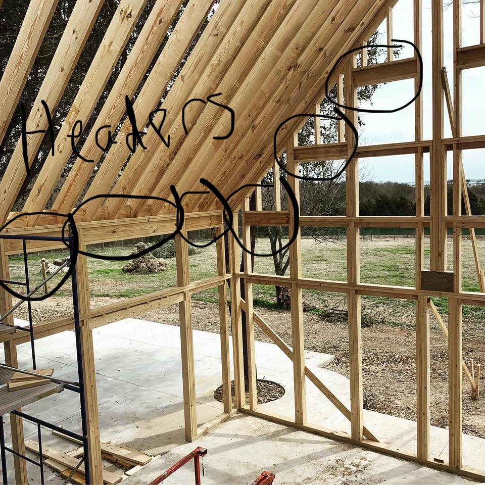

There was no visible lateral bracing in the end wall. Without see more complete photos, that's why it fell over. More questions... The header has no hurricane clips in it, which could be added later. And the header looks to be grossly under sized. Hummmm
