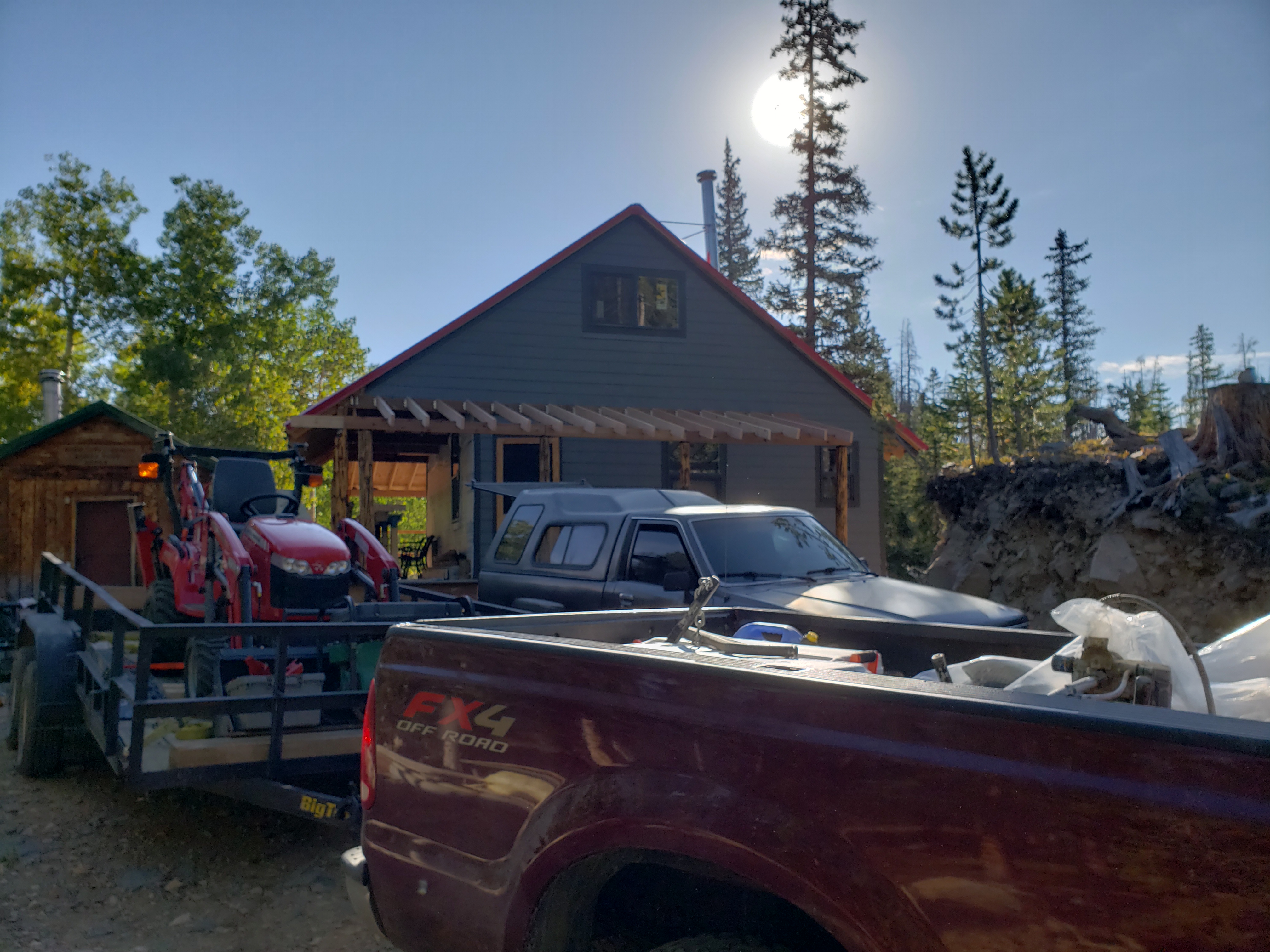

And too get some pictures in. A powerstroke, an ecoboost, a tractor, and the best of all...1988 Toyota truck. They don't make them like that anymore.

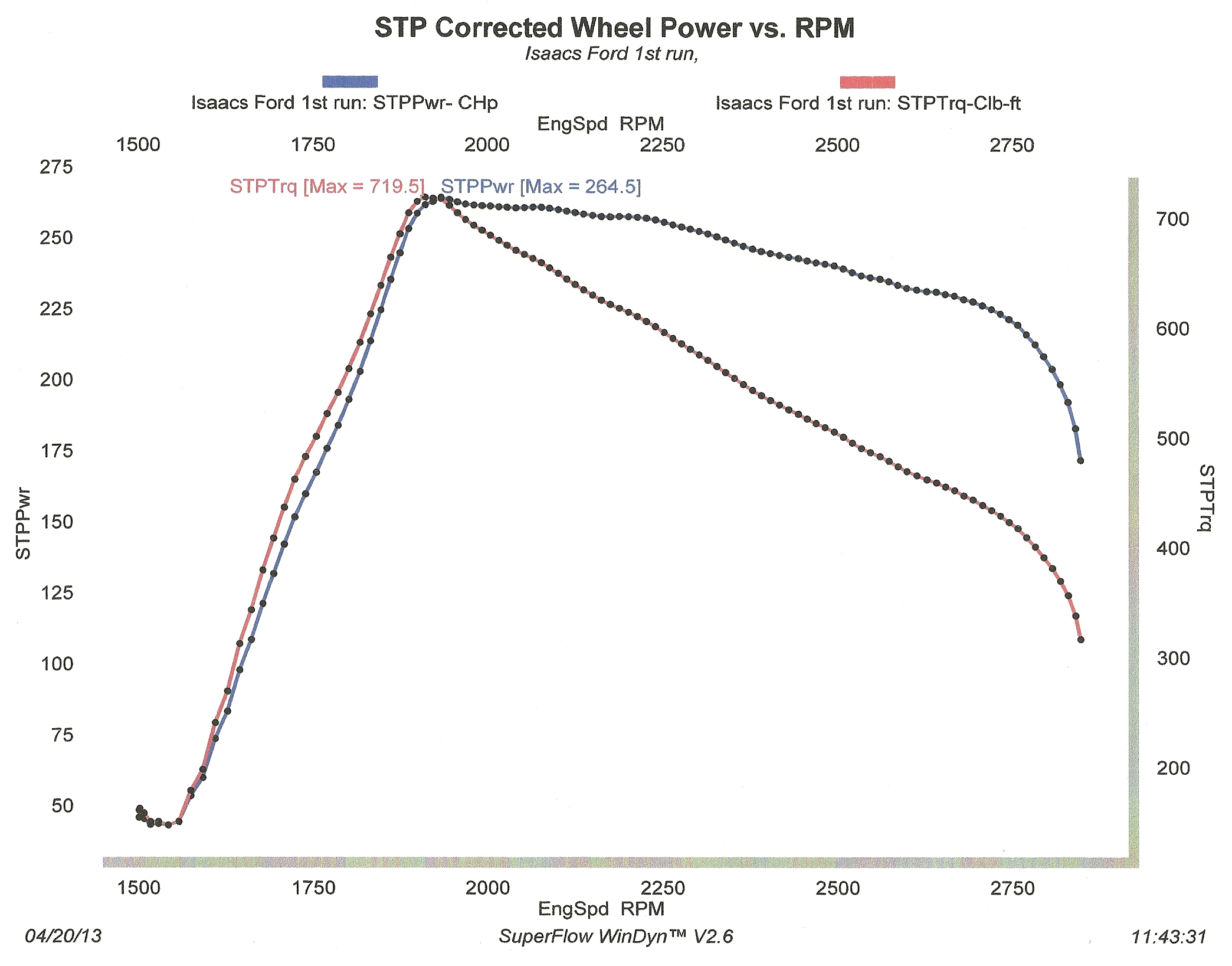

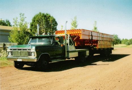

I agree. The 5.9 is an amazing truck engine. My numbers posted on the old Ford, 260/700 are to the ground and is considered a mild build. With two transmissions, a loss of 20% off the crank is about right, so 315/860 at the crank@1900 rpm. And for the non believing gasser guys:) here is a dyno sheet and a small load, 29k gcw.
Not bad for a 47 year old truck that spent 20 years in the log woods. 13 years as a gasser and 7 as a diesel hauling heavy. To this day, I would put it against any new 1 ton dually hauling heavy in the log woods. On the big highway, not so much:D
