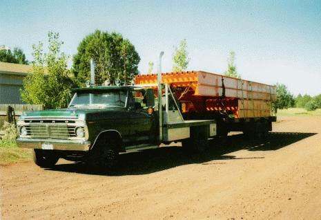

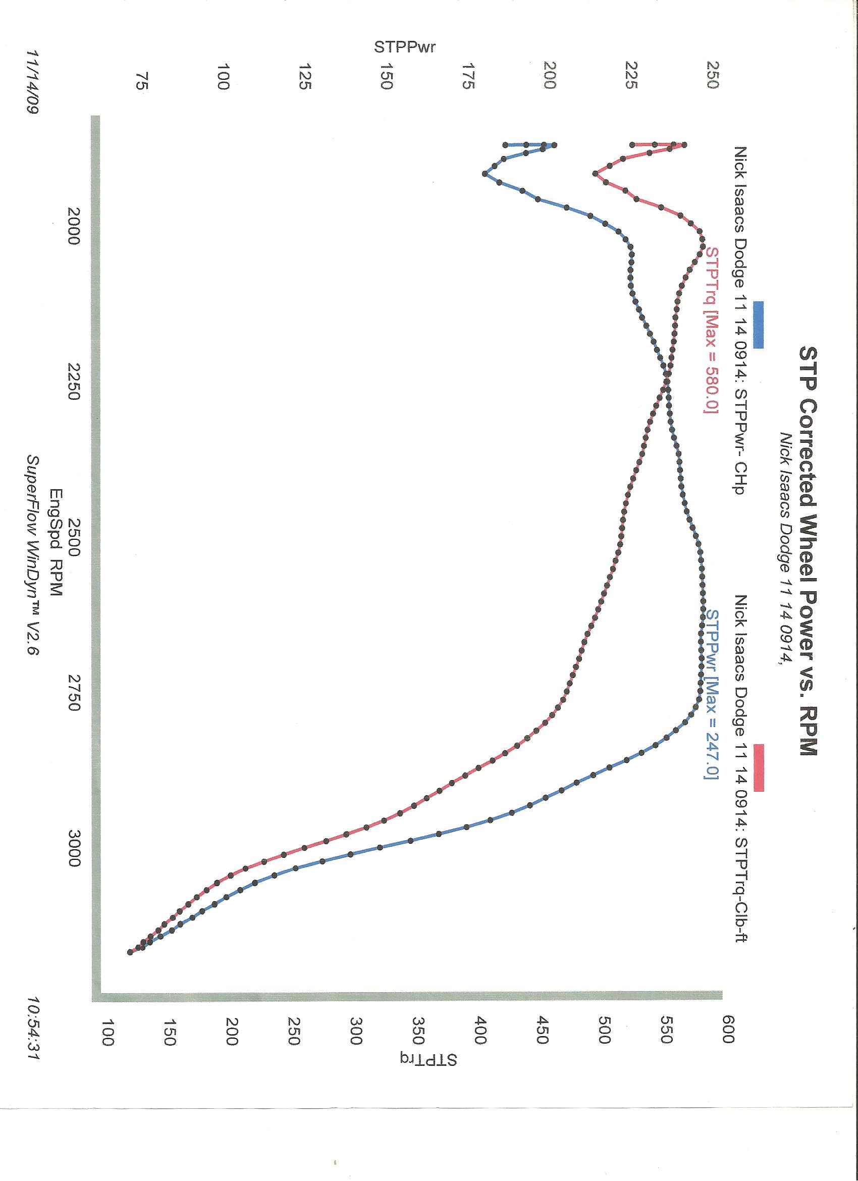

I agree. The 5.9 is an amazing truck engine. My numbers posted on the old Ford, 260/700 are to the ground and is considered a mild build. With two transmissions, a loss of 20% off the crank is about right, so 315/860 at the crank@1900 rpm. And for the non believing gasser guys:) here is a dyno sheet and a small load, 29k gcw.
Not bad for a 47 year old truck that spent 20 years in the log woods. 13 years as a gasser and 7 as a diesel hauling heavy. To this day, I would put it against any new 1 ton dually hauling heavy in the log woods. On the big highway, not so much:D
View attachment 687850View attachment 687851
So... whats up with your very odd power curve there? Most Cummins 5.9's will build power out nicely to around 3000 rpm. Yours only peaks at 1800 and goes down from there? 260 HP is nice for an old 12v, but the curve is odd. Just curious.

It is a little “ peaky “. Could use a little fuel map adjustment, but still better than stock...
Winter fuel?..Lol I think mostly because it is an industrial version, rated at 2500. It appears to defuel at about 2200.
Here is a similar 5.9 but in a Dodge D-250, 1991. First sheet is before injectors and the second one with 30 hp's.

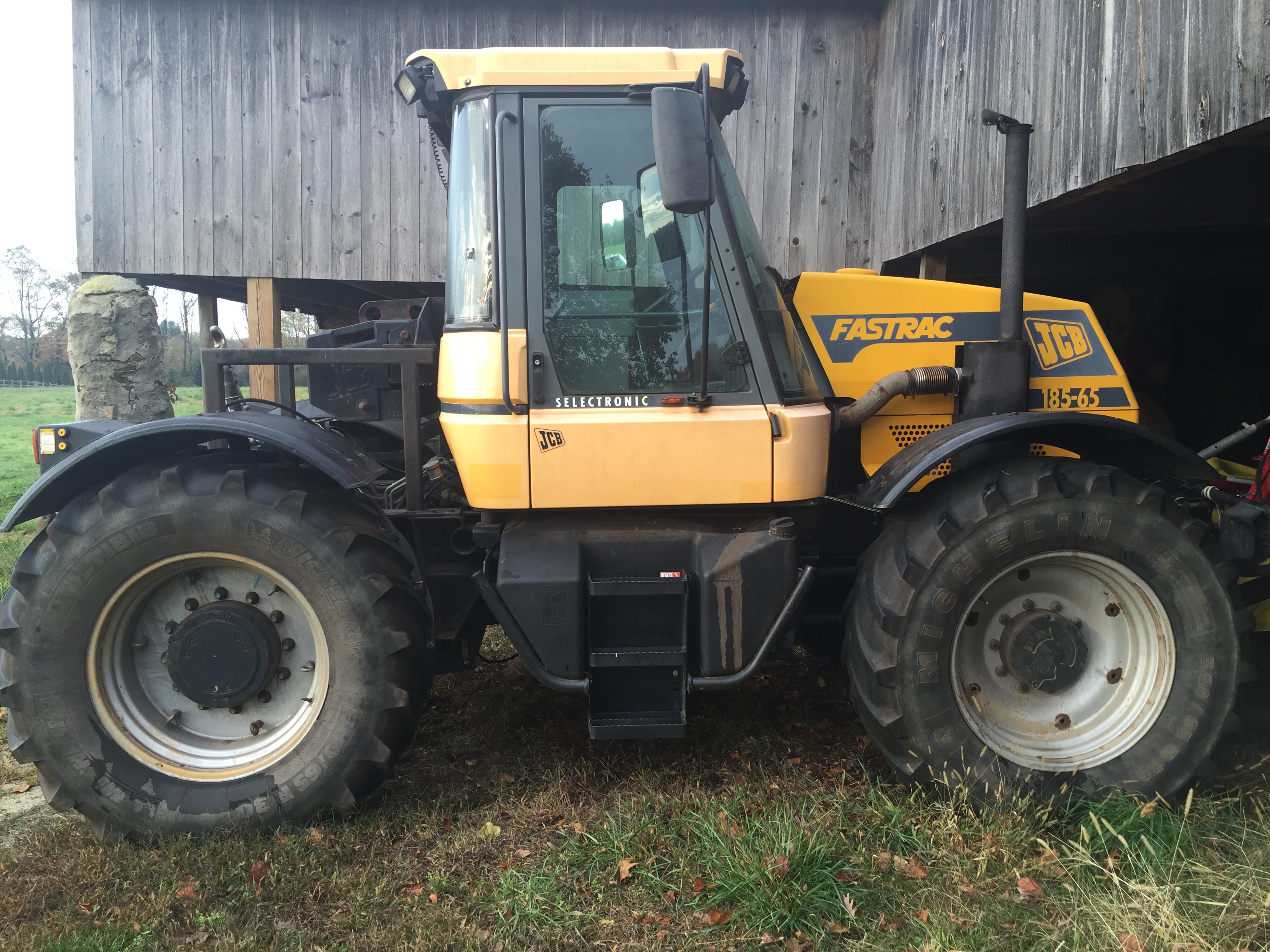

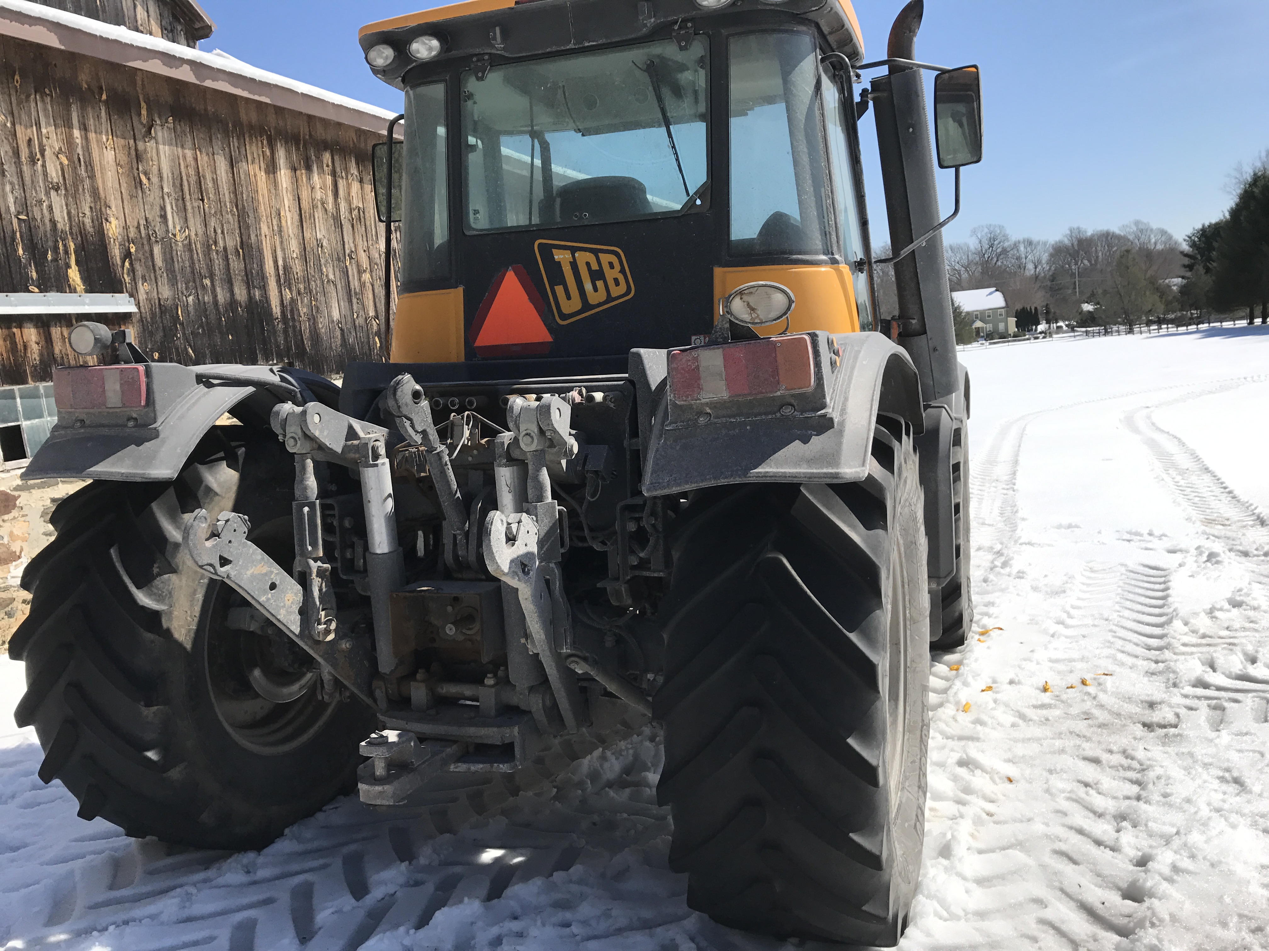

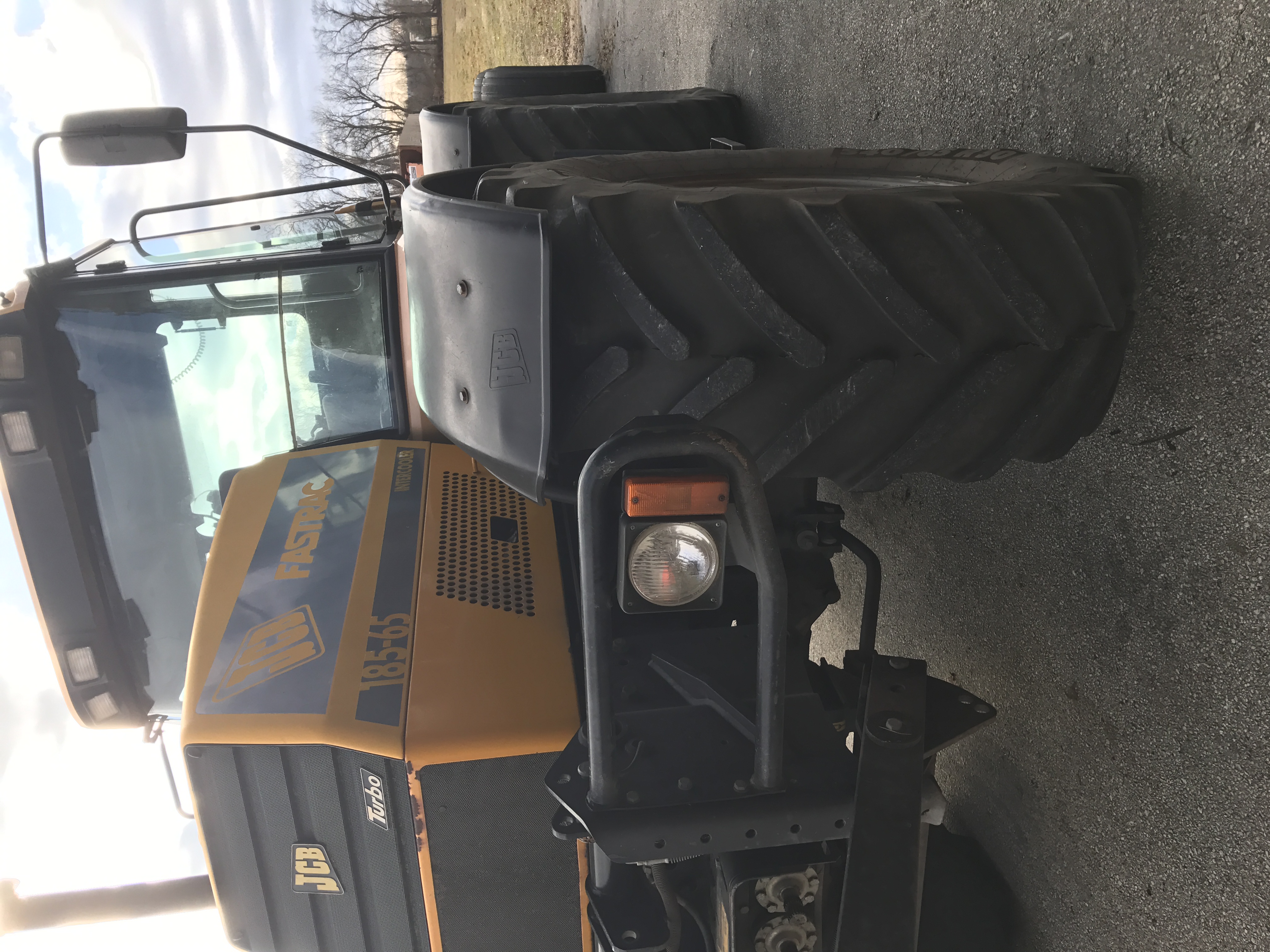

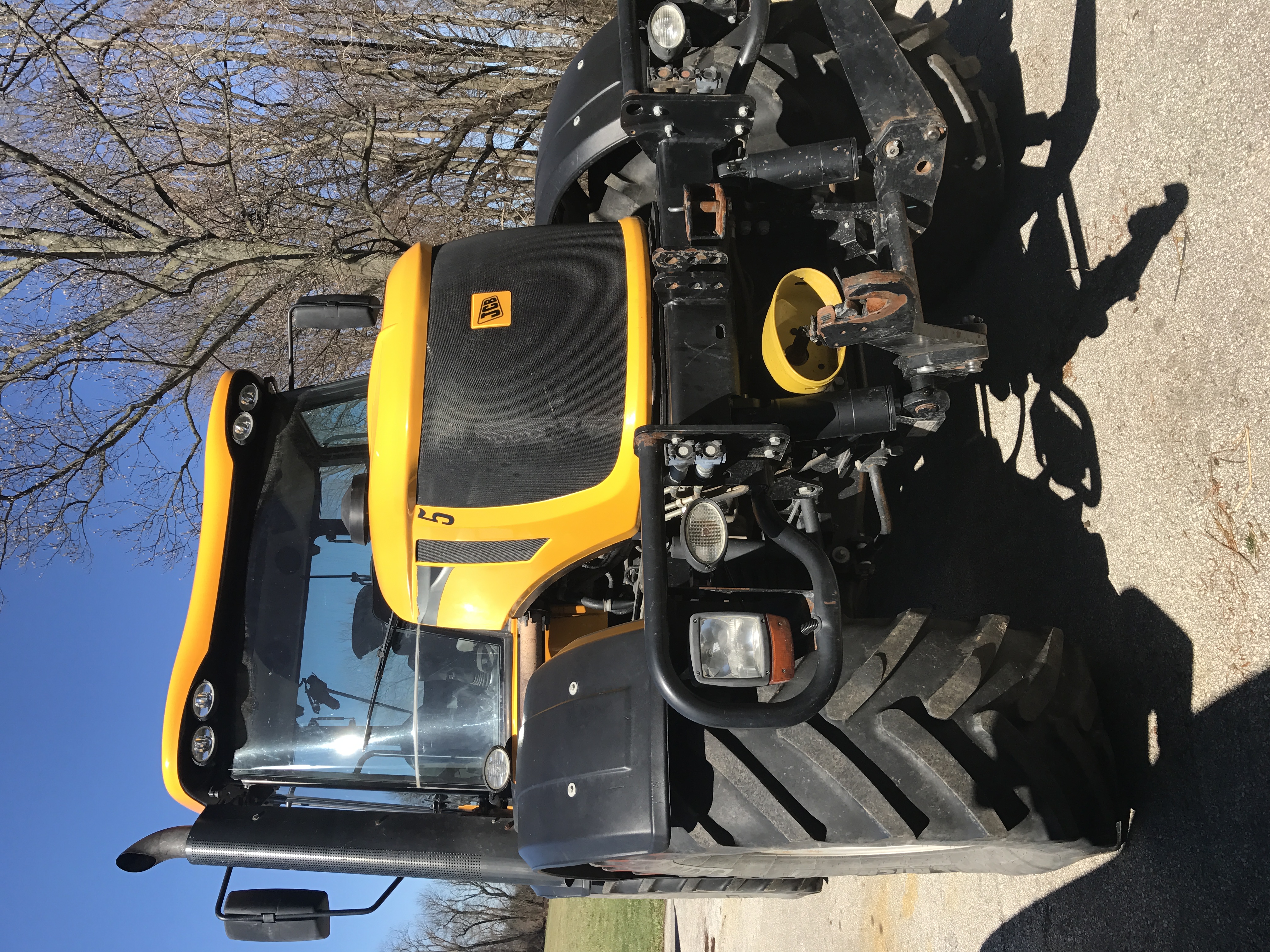

I had 2 JCB fast tracs with 5.9L/6.7L Cummins in them. One was 185HP and the other was 220HP.
Crazy low torque in them. They also had close to 40mph road speed. :D I was talking to a JCB dealer service tech and he told me the JCB Cummins versions that went in the Fast trac were a little different than the Dodge/Ram units. They speced out a heavier bedplate and bottom end for continuous lugging and high demand. My smaller Fast Trac has over 8,000 hours on the on the original 5.9. I think thats impressive.
Probably would have fared better with a Ford Ecoboost due to its larger crank surface area :shocked:

I think those Fast Tracs are very cool. If only they had more crank surface area! Seriously though, a turned down 5.9/6.7L Cummins will last about forever.
As mentioned, I have several newer Ram 2500/3500 diesels for tractor delivery trucks, but owning a Raptor as my daily driver has given me a ton of respect for the twin-turbo 3.5l Ecoboost. I think each has its place. I won't tow heavy or often with the Raptor, and I won't jump the 3500 dually.
   / Your towing rigs and trailers #3,840
Dang! That is a bad azz tractor. Does it have both pto speeds or just 1000 rpm? I would also guess with 200 hp it will be the large pto 1000. My Case/IH 995 only has 104 hp with the 540/1000 small.
