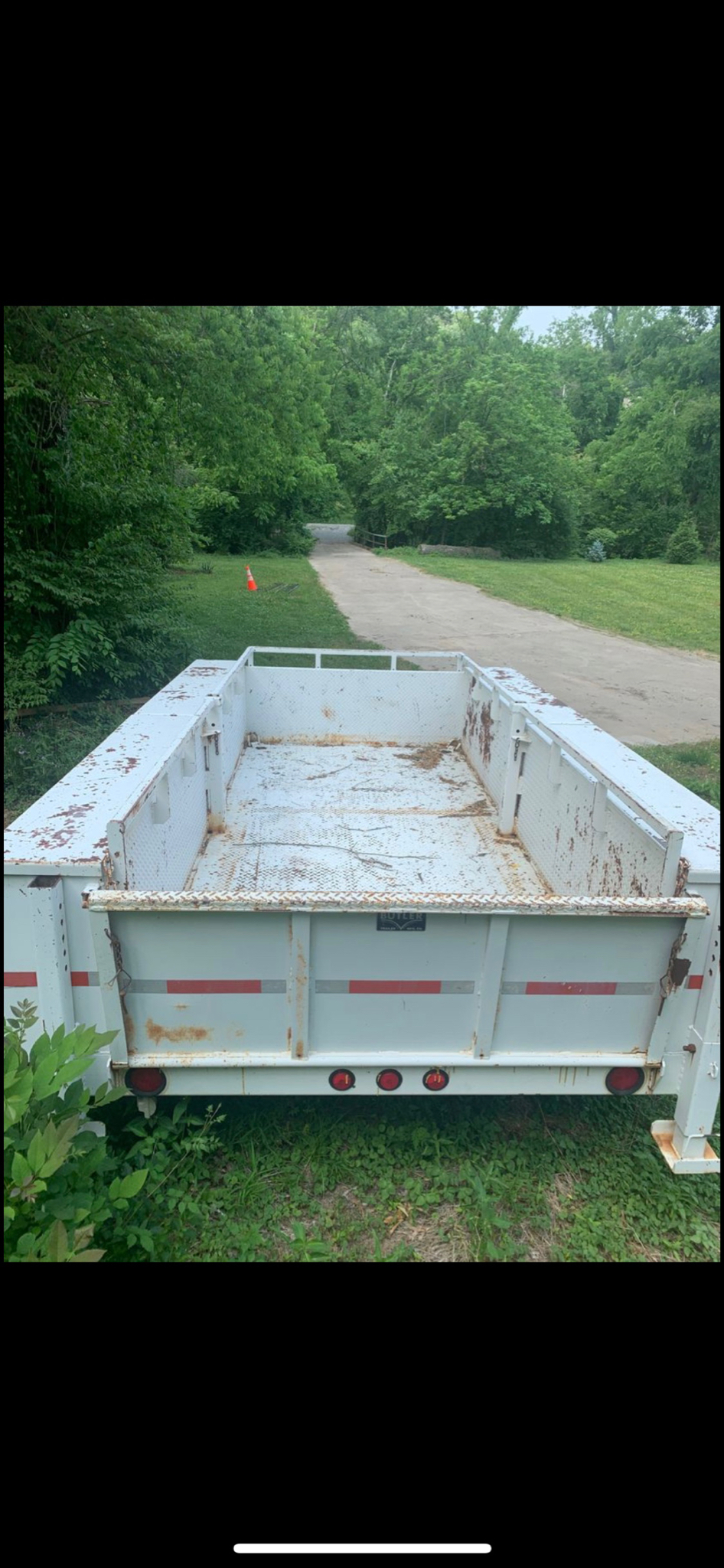

The spring hangers are different on the duel trailer vs the super single trailer. I think they’re both 10k HD. I’ll just have to see what happens. I was planning on selling the service trailer after I was done but I’m kinda starting to like it. I’ve never seen a 12ft trailer built that heavy.

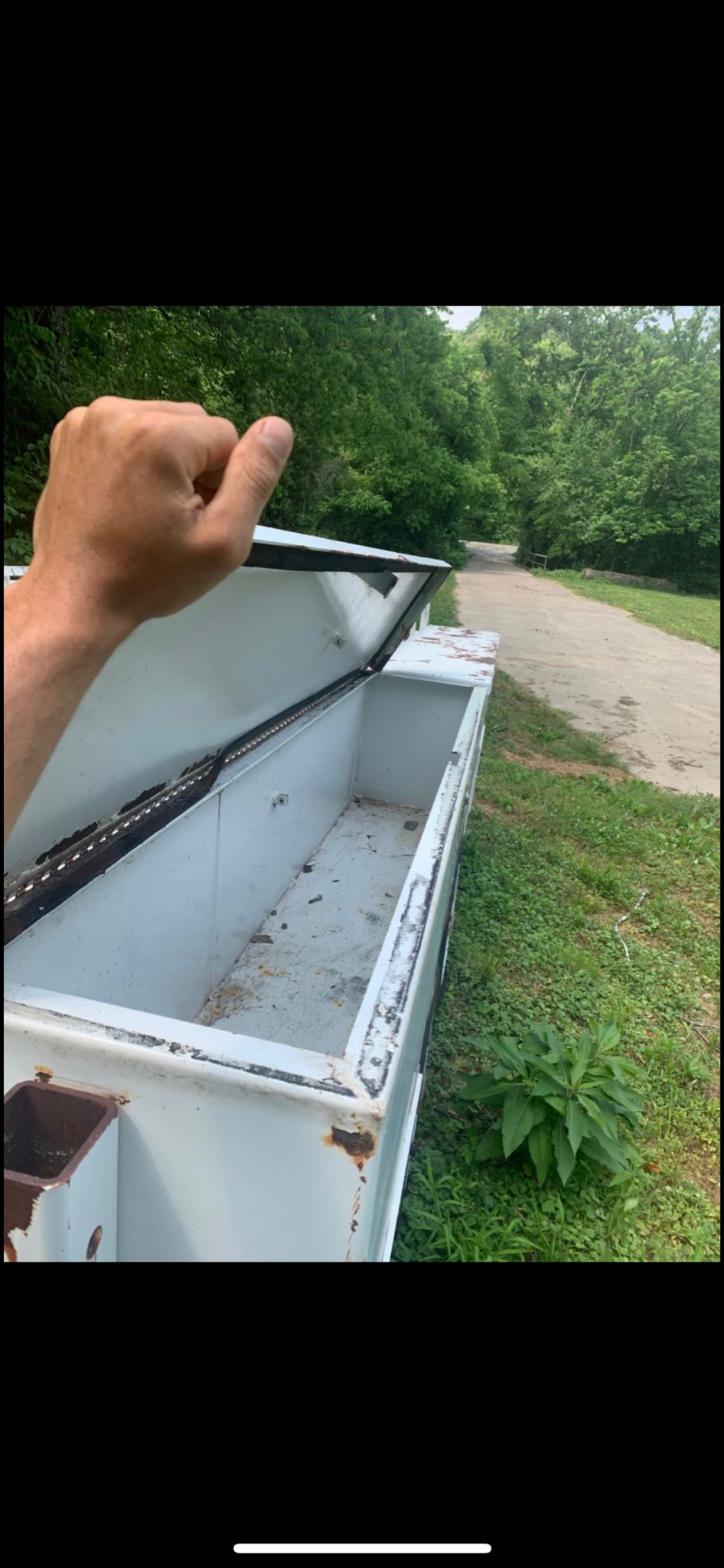

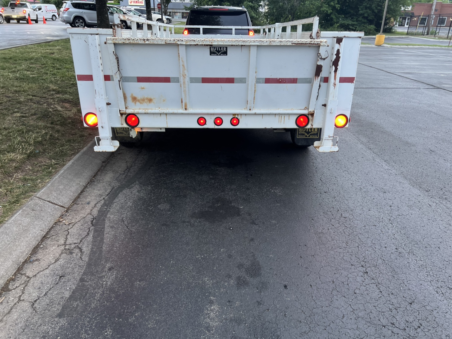

It’s really nicer then I was expecting. I gave 2k for it figuring the 17.5s were worth that and anything else was a bonus. Every light works, I’ve never bought a 25 year old trailer and that happened before. Every box latches. I even have the keys for the latches. All the panels are straight, nothing is bashed in. The boxes are like 7 gauge. Even the floor is straight. Someone has actually taken good care of it. I wouldn’t hesitate at all to buy another Butler trailer although I’m guessing it would be exorbitantly expensive.
