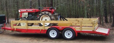

I stated before the only problems I've had with The My Ym2000 and was purchased ASIS.. This is my YM2000 not long after I bought it. And I highly doubt It's a VN'er.
