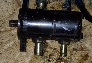

I'm not saying this means I'm quite comitted (can't ponder long though, with the snow melting like it did today), but pictures is a very good idea!
#1 is the pump. It turns out the numbers were a bit off; looks like they restamped the second pump after it was desinated as a primary pump.

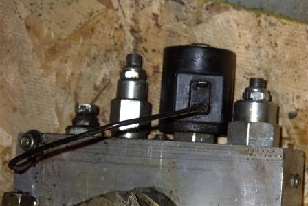

This is the PTO solenoid, as well as all the over pressures. Also what the LBracket was supporting.
If I go with manual valves and a different pump; the L bracket will not be going back, and the block will take a different form. /forums/images/graemlins/grin.gif
