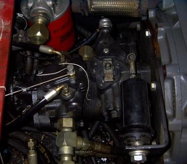

Plenty of room! /forums/images/graemlins/cool.gif
However, it looks like I will pay the price when routing the hoses. /forums/images/graemlins/frown.gif

Re: You\'ve warped me!
I think it looks even better than the original! /forums/images/graemlins/cool.gif But again, the hosing may put me in knots.
Yes, that is store-string holding up the loose hose ends. /forums/images/graemlins/grin.gif

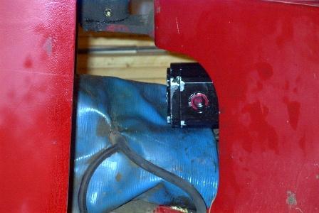

Take 2
Finally got a chance to get the holes drilled for the valve (one of those projects I knew would take 4 hands). By the time I got the inlet and exit (couldn't find the fitting I wanted there so that was 1/2" too) hoses on, it was tight, but looks nice!
The hoses are being a pain, but I expected that; PT had it way too easy using 1/4 and 3/8. 1/2 and 3/4 doesn't cooperate nearly as well, but I just couldn't put 25GPM through 3/8" hose. Actually, I'm looking at some funky configurations for the inlet to.
Sorry, pajoube, I forgot the pictures tonight. /forums/images/graemlins/wink.gif But I have some more hoses to go anyway.
