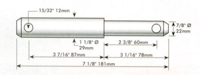

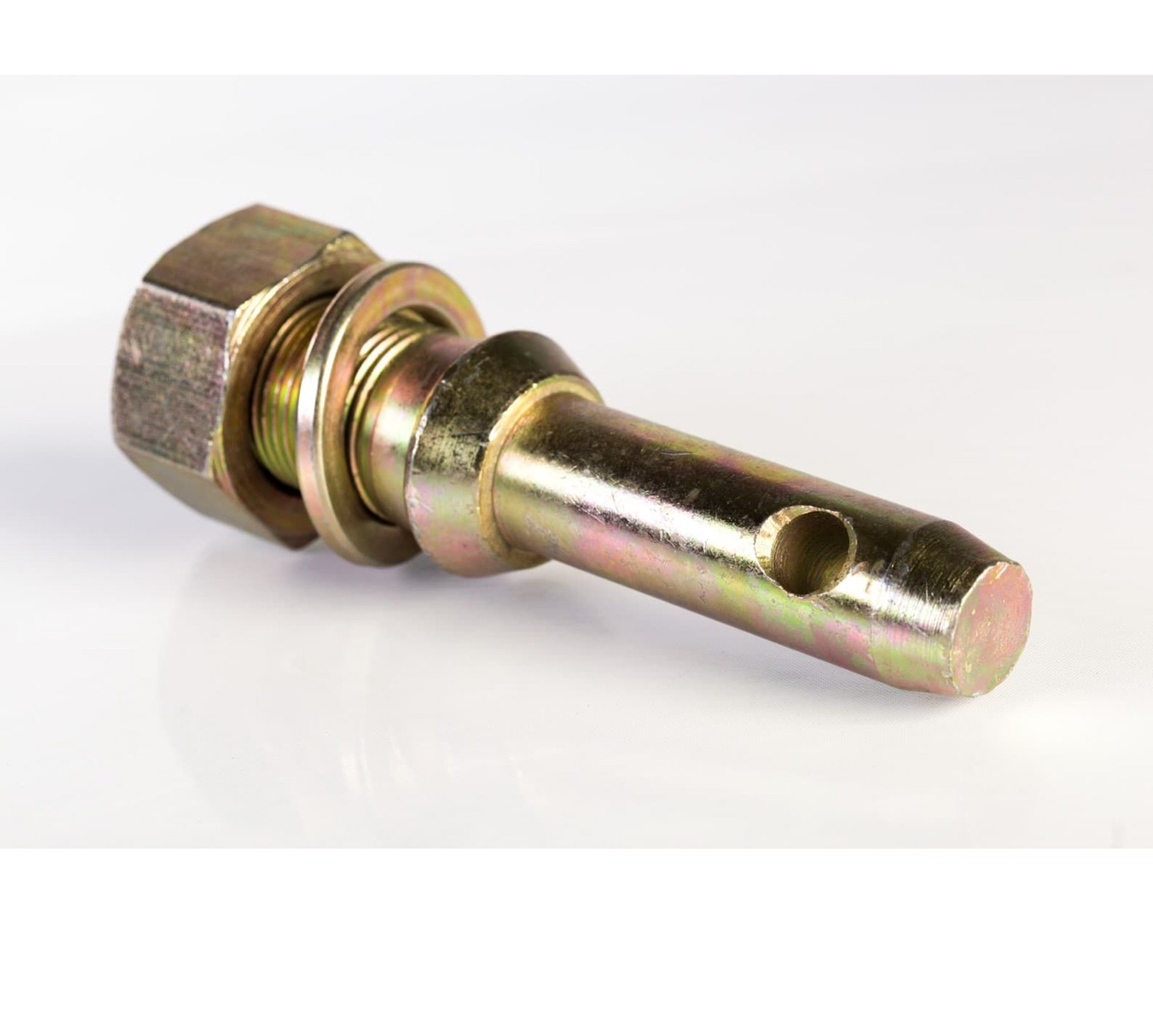

How do you put a smaller bushing on a bigger diameter pin :confused3: CAT 2 tractor WILL work on CAT 1 implement with a bushing BUT Cat 2 implement WILL NEVER FIT IN A CAT 1 tractor LOWER ARM

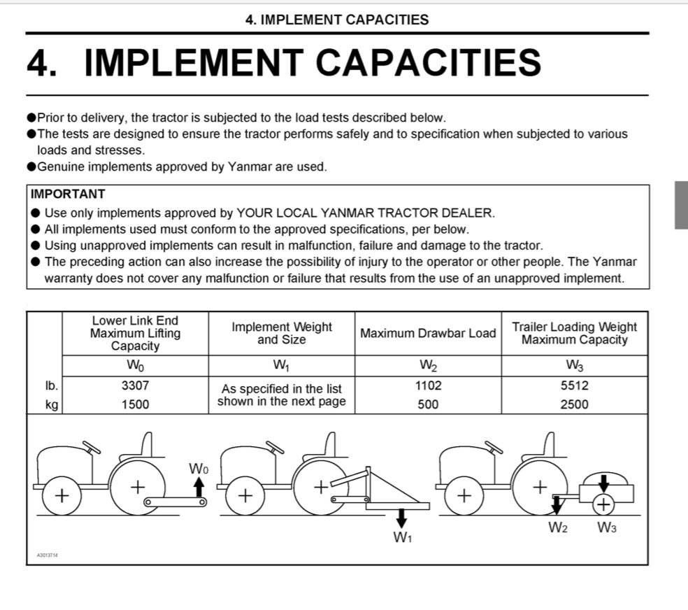

The manual for YT347/359 suggest the largest mower is 7', so an 8' mower may be more than what the tractor can handle.
I attached screenshots of the relevant pages.

Ray,
My MX and your tractor are similar in size and lifting capacity. I use a Befco 9 ft 2 " finish mower with no issues, about 1500 lbs w/o looking up the exact spec.

What would be the largest rotary mower that you'd want to pull with the YT359.

I used to pull a twin blade 8' pull-style mower with my Massey 1652 (which is very close in spec to this Yanmar)... It handled it fine. But a flail can be a bit more demanding.
I sold that mower and only use the 90" flail now.

How do you put a smaller bushing on a bigger diameter pin :confused3: CAT 2 WILL work on CAT 1 with a bushing BUT Cat 2 WILL NEVER FIT IN A CAT 1 LOWER ARM
Replace the cat 2 pin with a cat 1 so it fits inside the cat 1 arm, then cat 1 to cat 2 bushings where the pin goes through the implement. Would require two bushings on each pin, or use a dual category pin with one bushing on each side.IMG_0113.JPG
