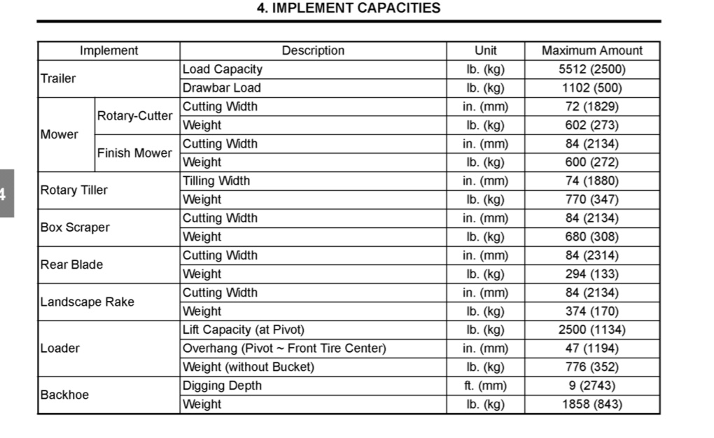

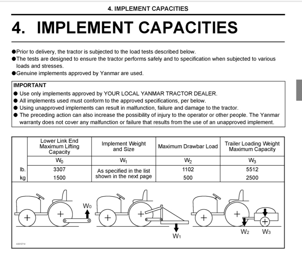

The manual for YT347/359 suggest the largest mower is 7', so an 8' mower may be more than what the tractor can handle.
I attached screenshots of the relevant pages.

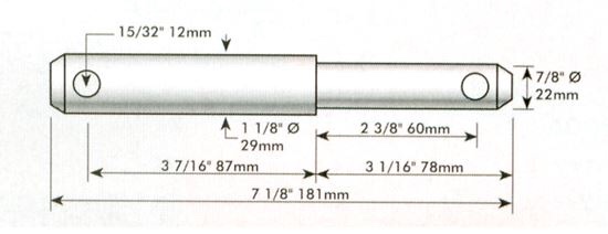

How do you put a smaller bushing on a bigger diameter pin :confused3: CAT 2 WILL work on CAT 1 with a bushing BUT Cat 2 WILL NEVER FIT IN A CAT 1 LOWER ARM
Replace the cat 2 pin with a cat 1 so it fits inside the cat 1 arm, then cat 1 to cat 2 bushings where the pin goes through the implement. Would require two bushings on each pin, or use a dual category pin with one bushing on each side.IMG_0113.JPG
