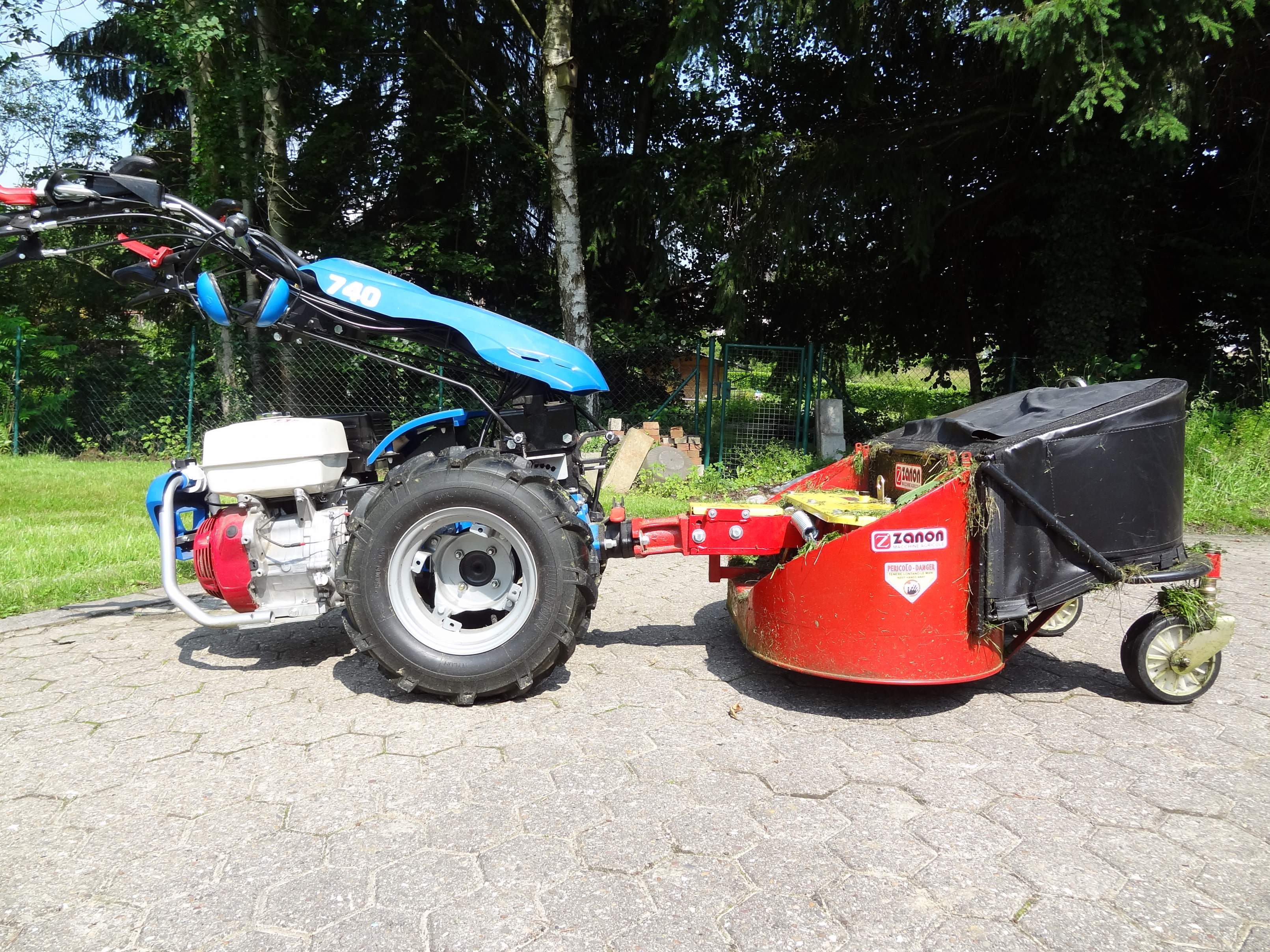

After my first season with the Zanon ZCR 800 lawn mower, I would like to share some of my experiences with you.
The following link to the Zanon homepage shows some pictures and some basic information on the mower in question:
ZCR double-blade lawnmower
The mower makes a very robust impression, and it is generally well designed, well-built and user-friendly to operate.
To mow at the highest possible height, I left the front caster wheels in their highest position and to keep the deck parallel to the ground, I tilted the PTO-flange to its lowest limit. This gave a mowing height of 8 cm (3 5/32") with the standard 5x10x20" wheels on my BCS 740, but due to the tilted PTO-flange, unfortunately only 11 cm (4 5/16") of ground clearance under the engine. After changing to 6.5x12x23" wheels, I could return the PTO-flange to around level and still maintain 8 cm mowing height, and because the tractor stands more level now, ground clearance under the engine has almost doubled to around 20 cm (4").
The larger wheels also adds some 15% to the speed, and gives a comfortable mowing speed around 2.3 mph in 3th gear with half throttle. If mowing regularly, I only use 3th gear, and it takes less than 1 1/2 hour to mow an 18,000 sq. ft. lawn. For mowing - and for sweeping by the way - I can only recommend that you use the largest diameter wheels available.
After a long rainy period - and some vacation on top, I had the chance to test the mower on my then 1-foot tall lawn. The mower cut the grass with ease, but the limiting factor was the chute blowing the clippings into the bag on top of the mower. It was clogged by the vast amount of grass, but by mowing in 1st gear, the problem was solved.
The Zanon ZCR leaves a nice cut comparable to any traditional rotary mower. Due to the long distance (53") between the swivel caster wheels at the front of the mower and the wheels of the tractor compared to a traditional lawn mower (23"), the clipping height will vary more when mowing on uneven terrain. This is perhaps not so bad in the lower parts where the mower will leave the grass longer, but at the top, the risk of scalping is high - especially with a low setting of course.
The ZCR has a swiveling joint in the PTO-flange that allows the mower and the tractor to follow the terrain independently. Probably because the mower is supported only in 3 points (the PTO-flange and the 2 caster wheels) and because of the direction of rotation of the PTO-shaft, it has a tendency to "dip" to the left. To keep the cutting height the same on the left- and right-hand side, I have tightened the spring dampening the swivel movement on the left-hand side 1 cm (3/8") more than on the other side.

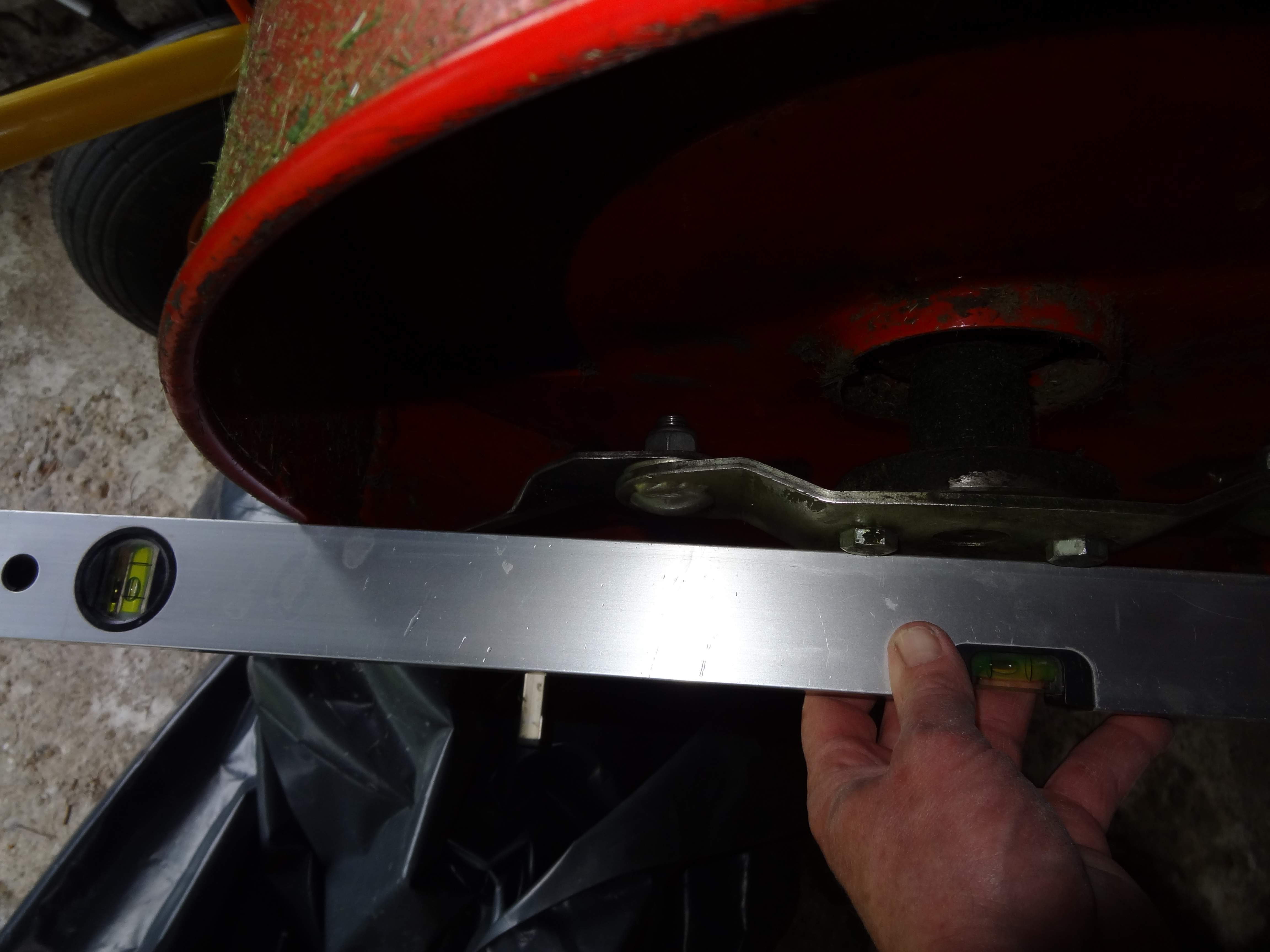

As I mid-season turned the mower upside-down, I was a bit surprised. On a traditional lawn mower, the lower edge of the deck will be the lowest part of the mower, and thereby protect all moving parts such as the knives and their mountings. On my Zanon the knives flush with the lower edge of the deck (at best), and the 4 bolts fixing the mounting plates to their axis, protrude below the deck (see picture 1)! This is not ideal, and I suggest that Zanon correct this by raising the 2 axis a bit for instance.

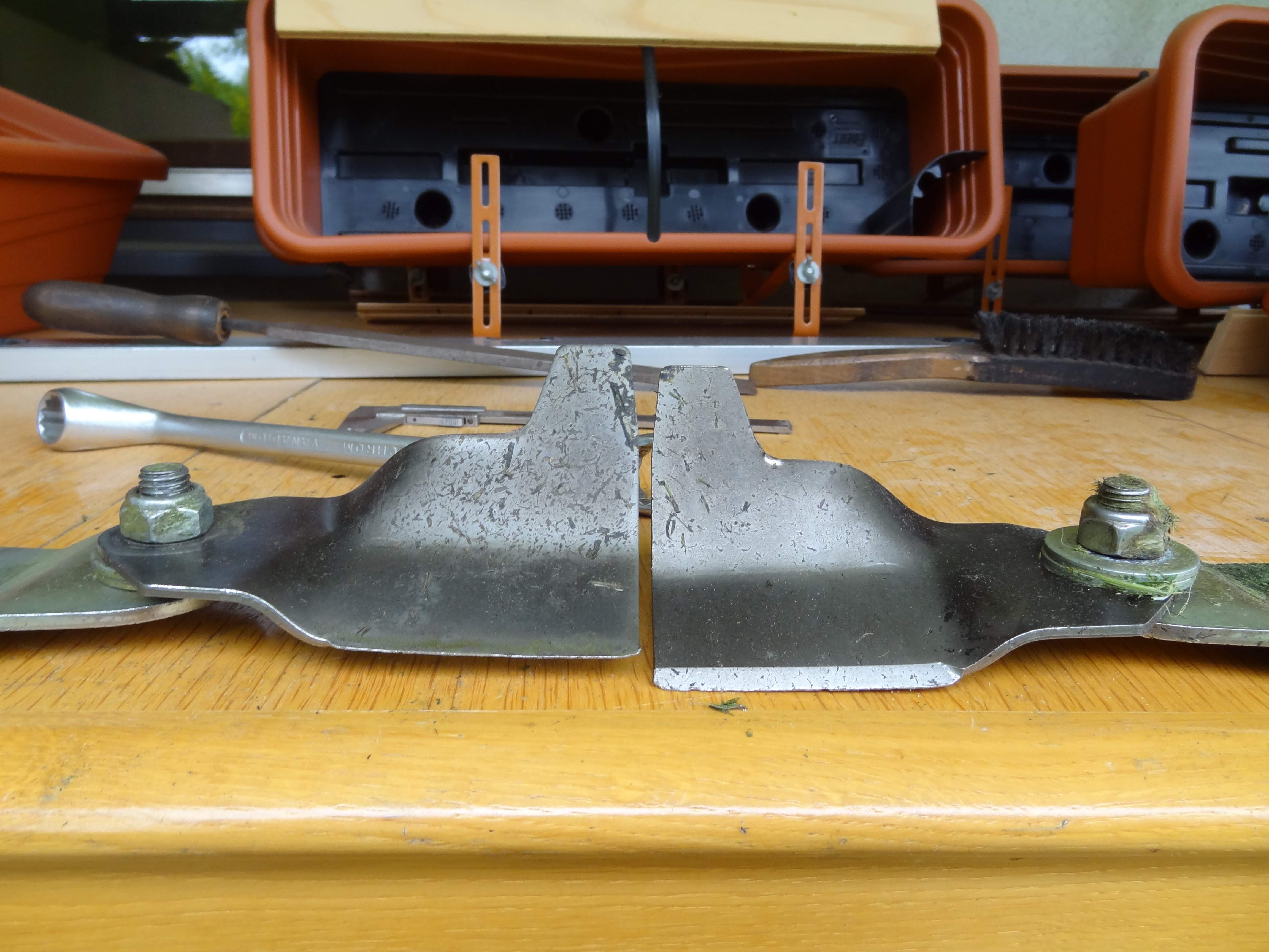

It might not be a fault, but the knives themselves surprised me a bit too. They are 3 mm (1/8") thick and produces a lot of lift and air to transport the clipping into the bag. As I removed the mounting plates from the axis, I noticed a difference in the knives on the 2 axis (see picture 2). I would like to hear from some of you having a Zanon, if your knives are also different or not? They cut fine, but why are they different? The knives on the left and right axis have different part numbers of course, but why are they sharpened differently?

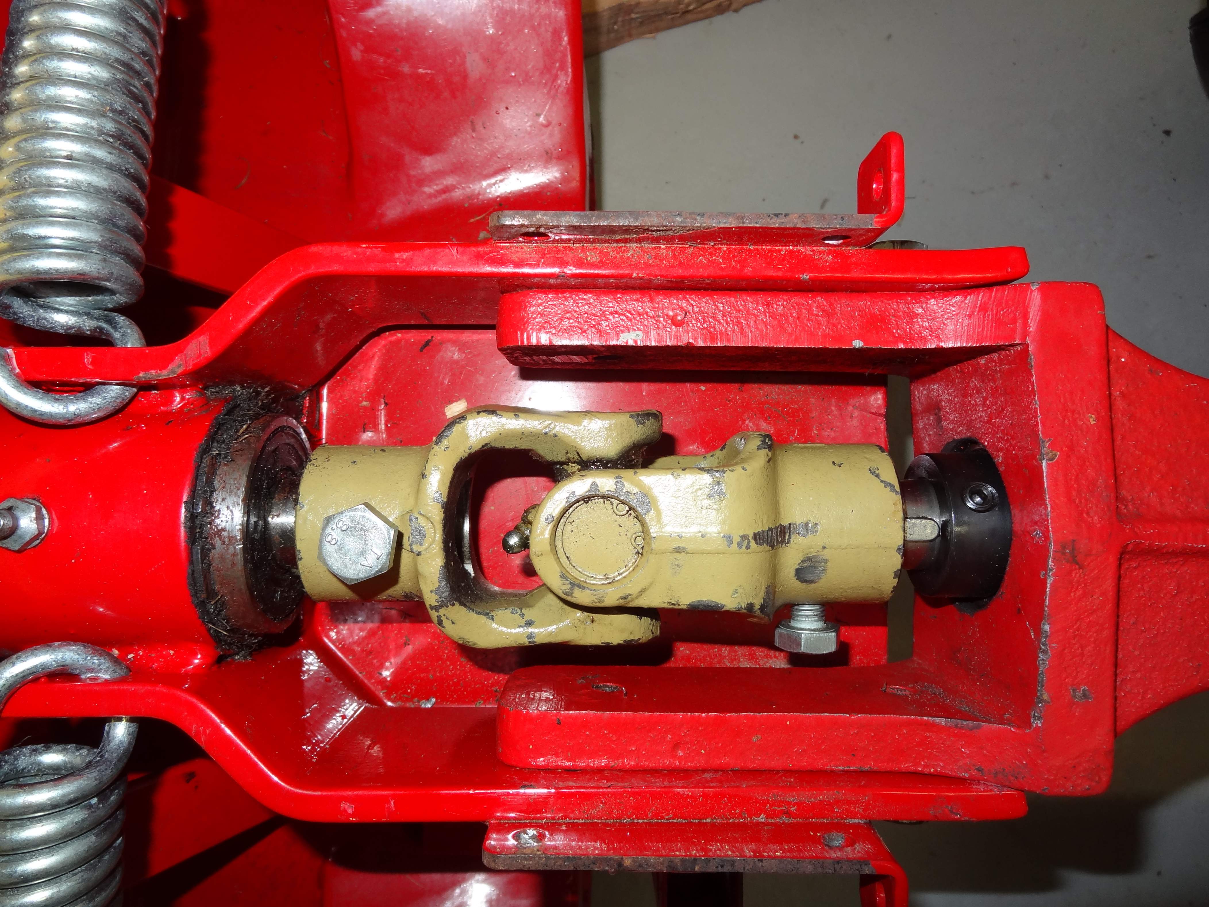

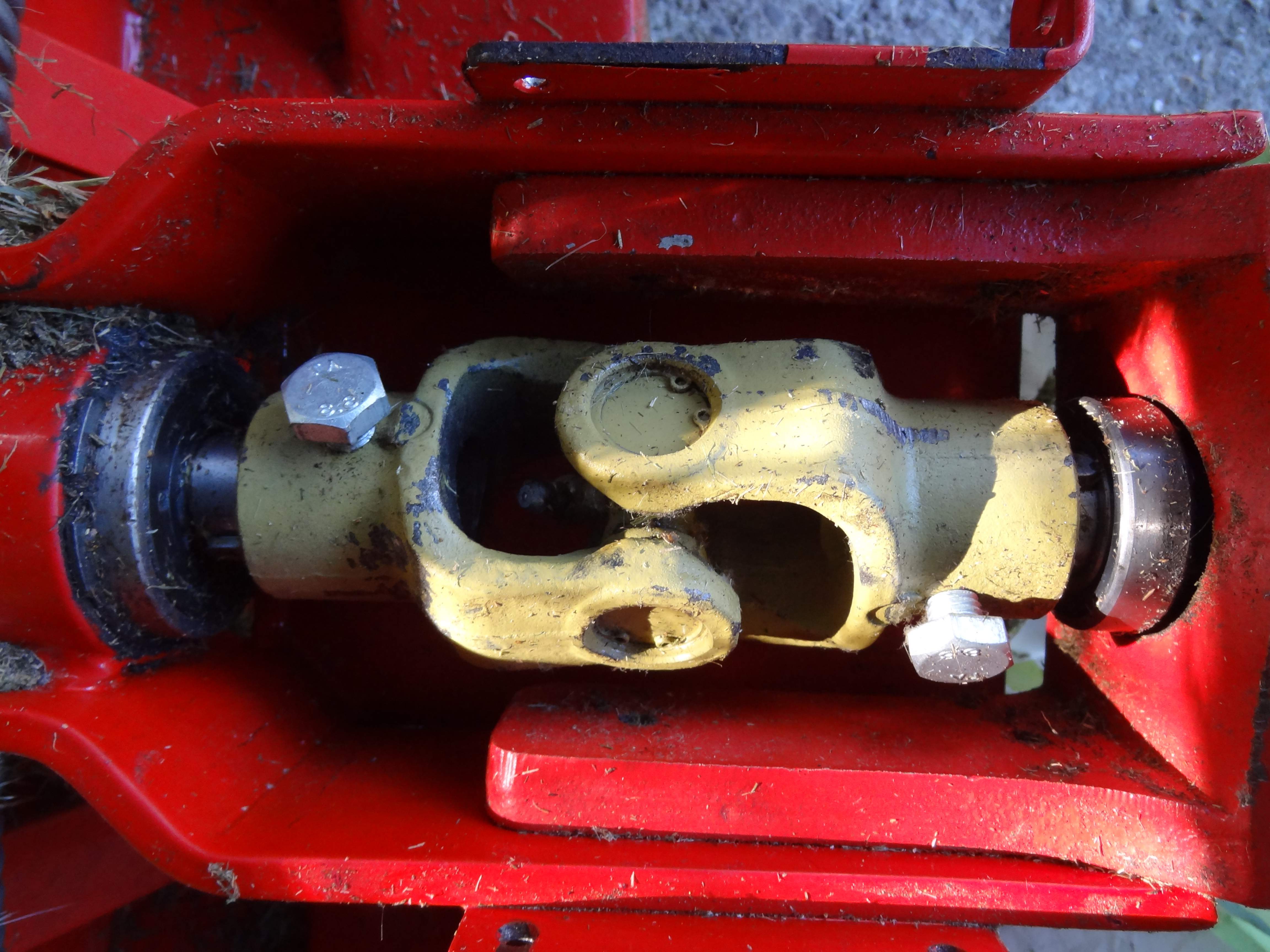

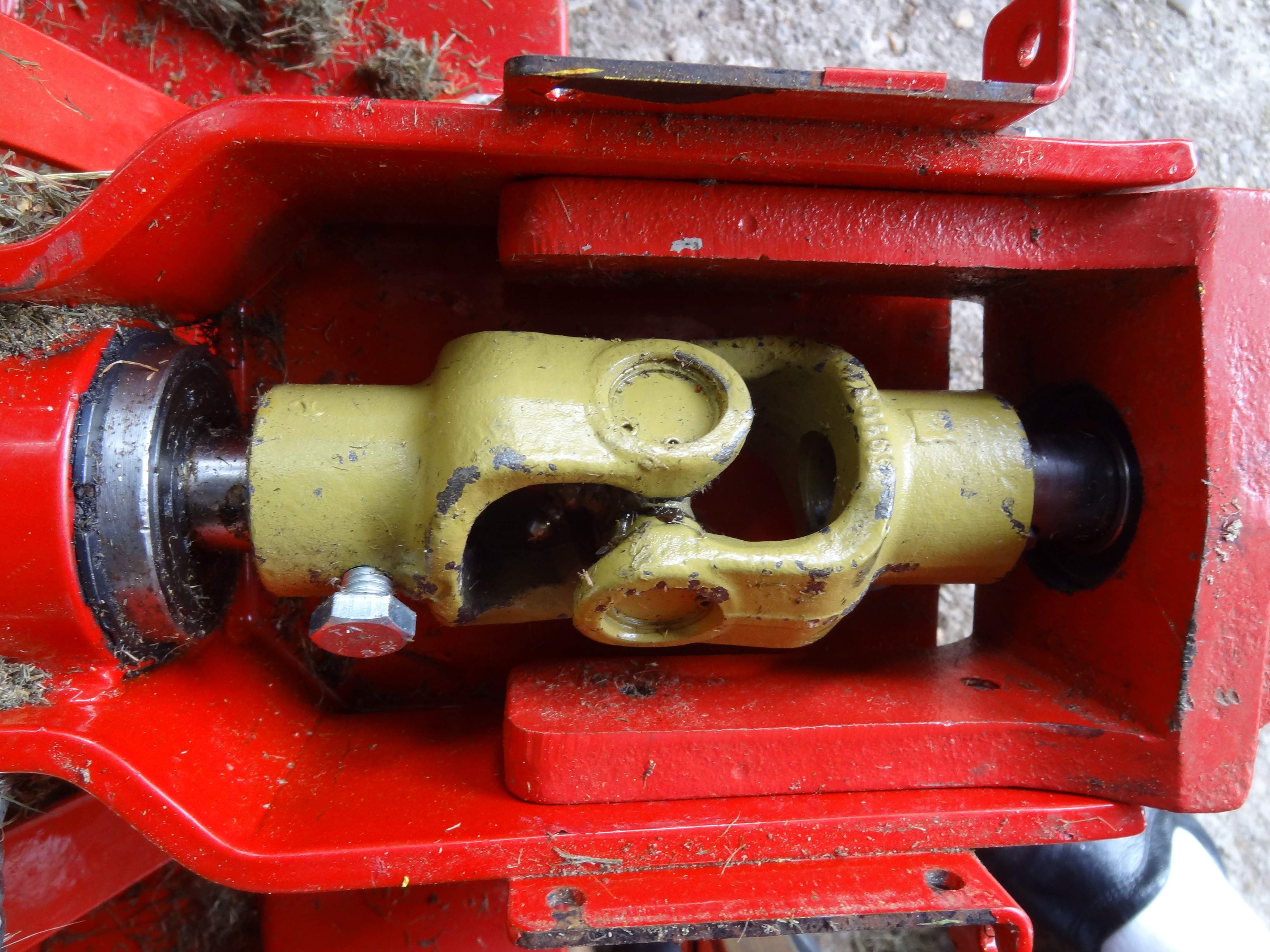

One item has puzzled my all last season, and that is the drive line through the PTO-flange:
The mower was working fine, but as I removed the cover over the universal joint to have a look at it, I was surprised to see that the bearing facing the tractor, had slipped out of the housing, and was just turning on the axle (to the right on the first picture). I disassembled the PTO-flange and got the bearing back into its housing (see second picture). At first, I expected that a lock ring had fallen off and disappeared which had led to the bearing sliding out of its housing. I found no evidence of anything missing, and looking at the part diagram in the user's manual, confirmed that there was not supposed to be a locking ring at all! Sure enough, the next time I had a look, the bearing had slid out of the housing again. As said, the mower worked fine, but this can hardly be the way the Zanon engineers intended it to be. My local dealer had a look at it, and he mounted a metal ring - fixed with an Allen screw - preventing the bearing from sliding on the axle (see last picture).
It would be interesting to hear from other Zanon users, if some of you have experienced something similar. I was surprised to hear from my local dealer, that this was the first time he had seen this problem. I can hardly imagine though, that this should be the first time this has ever happened.

I see from your picture that the mower PTO sits a little high and pivots the engine down when coupled to the tractor.
It looks like the wheels on the ZCR are out farther than those on the ZRA. To accommodate the bagger. But other than that, they do look like they're built off the same basic mower. (BTW, I agree that it is very strange that those blades are sharpened differently. I can't imagine why.)
