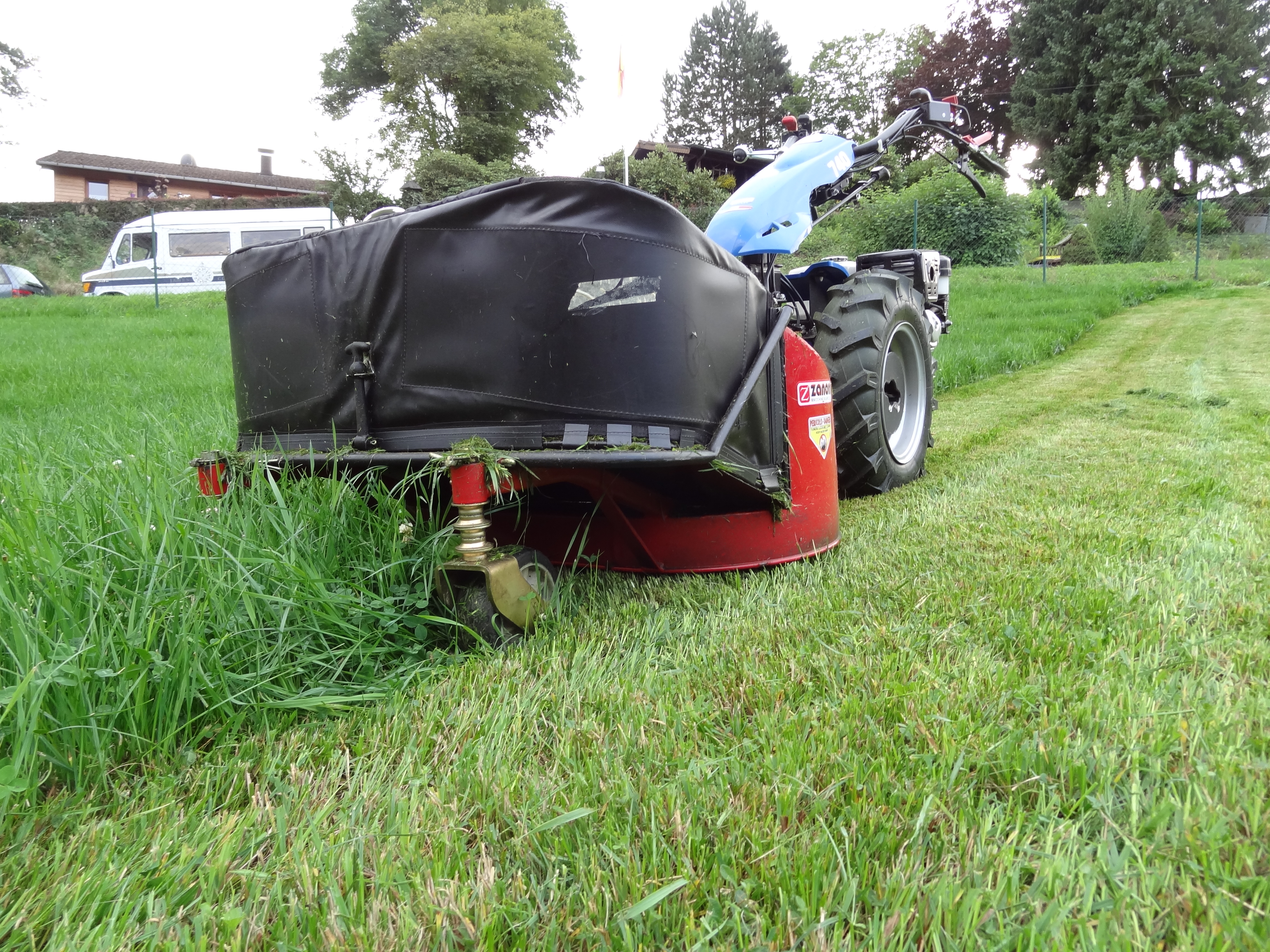

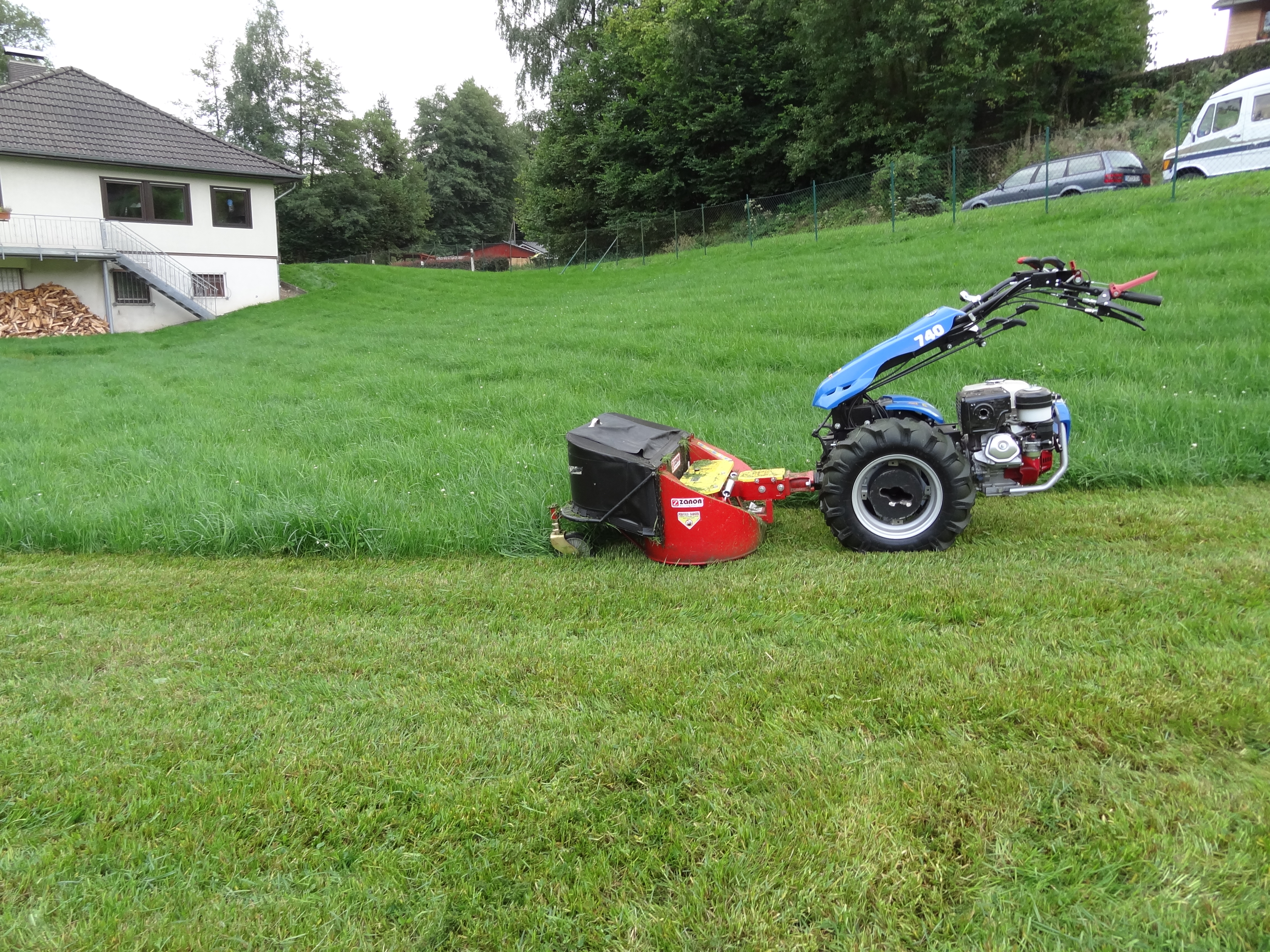

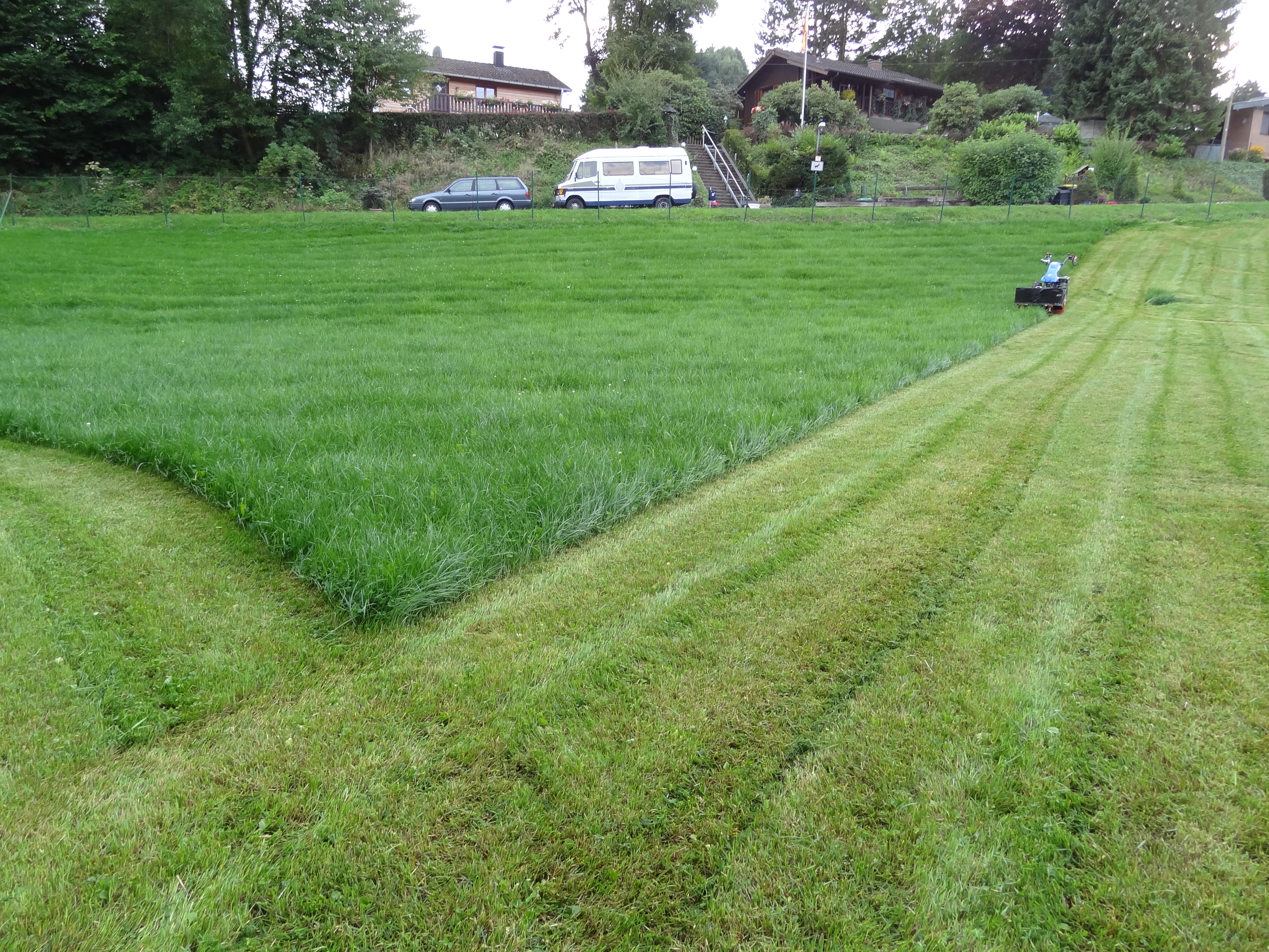

Hi - and a happy New Year :)
Since a few month, my 2016 mowing season is over, and I have added another 29 hours on my Zanon mower. This was my fourth season with this mower, and it now has a total of 139 hours. The tractor/mower setup was the same as for the 2015 season, and it has worked just fine.
I find it hard to believe that I should be the only member of this great forum who has a Zanon ZCR, but considering the lack of replies to this thread, that might be the case. I would very much like to hear from members who have experience themselves with this lawn mower.
As I do not have much to add to my previous comments this year, I can offer a few photos of the mower in action instead.
Best regards
Jens

My lawn is around 1,700 square meters, or around 18,000 square feet. Depending of course on the weather and thereby on the growth, I try to mow around once a week during the season. I usually spend 1 1/2 hour or a little less mowing the entire lawn then. I am glad, that the 3 photos above does not show the normal growth in a week, because then you would be right - then I really had a lot to mow ;)
I took the photos in the summer of 2013 after coming home from a 2 1/2-week vacation, in which time the weather at home had been warm and rainy, and the lawn had grown to around 30 cm (1 foot), as mentioned in the first post in this thread. I normally always mow in third gear, but due to the large amount of clippings then, I spent 6 hours mowing in first gear! The mowing of course took longer driving in first gear, but as you rightly indicate, emptying the bag took forever.
Whether to leave the clippings on the lawn or to collect them depends on several factors: if you mow often, and thereby have a small amount of short clippings, you can easily leave the clippings, and they will dry and disappear into the lawn itself. This is what they often do on golf courses, especially by warm and dry weather. At the same time, you need a mower that will distribute the clippings evenly, preventing lumps of clipping rotting on the lawn. This is not possible with the ZCR, because without the bag, it throws the clippings in front of itself, often in lumps, especially with the amount seen on my photos. That day I think I spent twice as much time emptying the bag, than on actual mowing. When mowing normally around once a week, emptying the bag is not that big a deal, if you can empty it close by.
