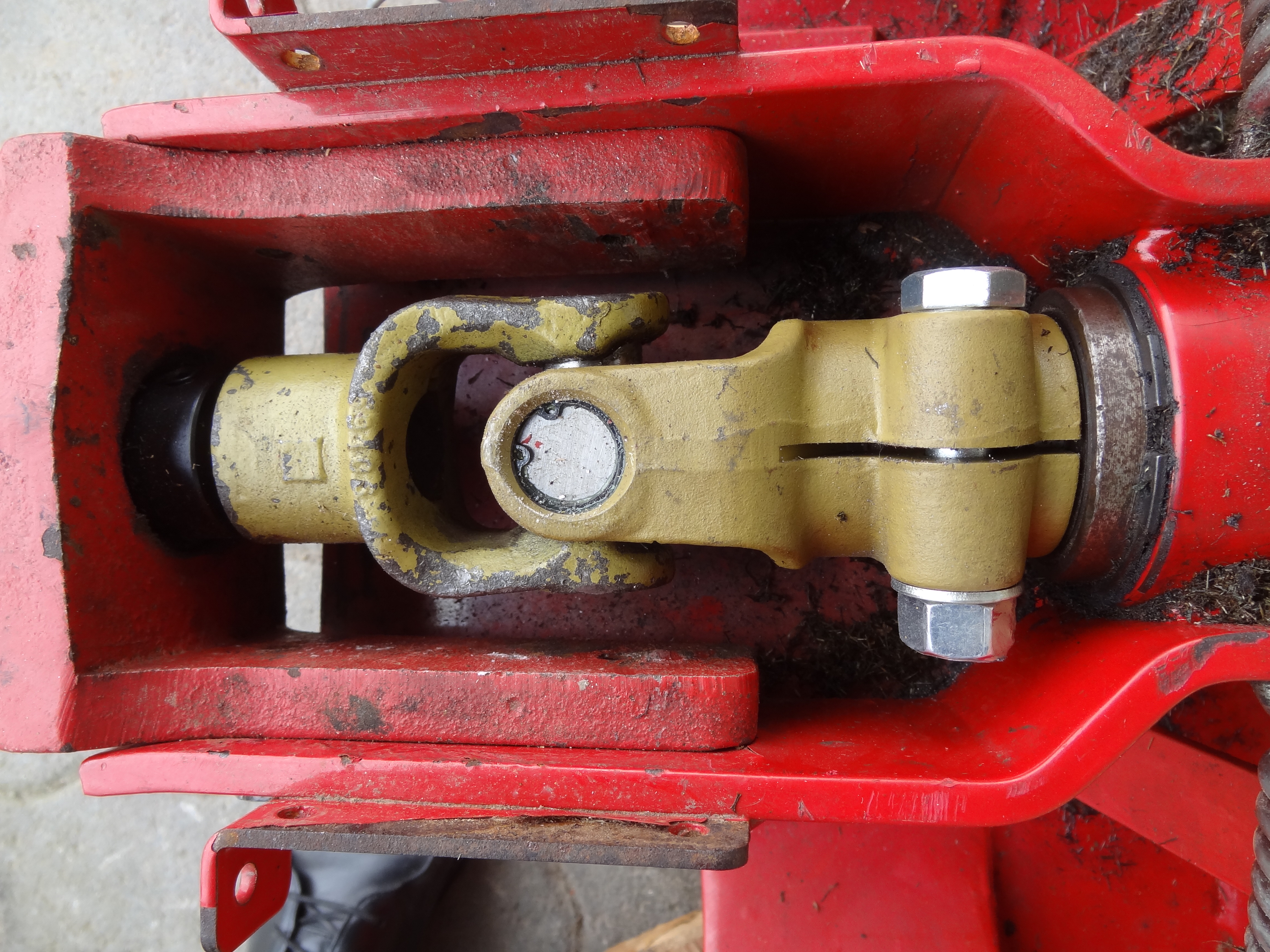

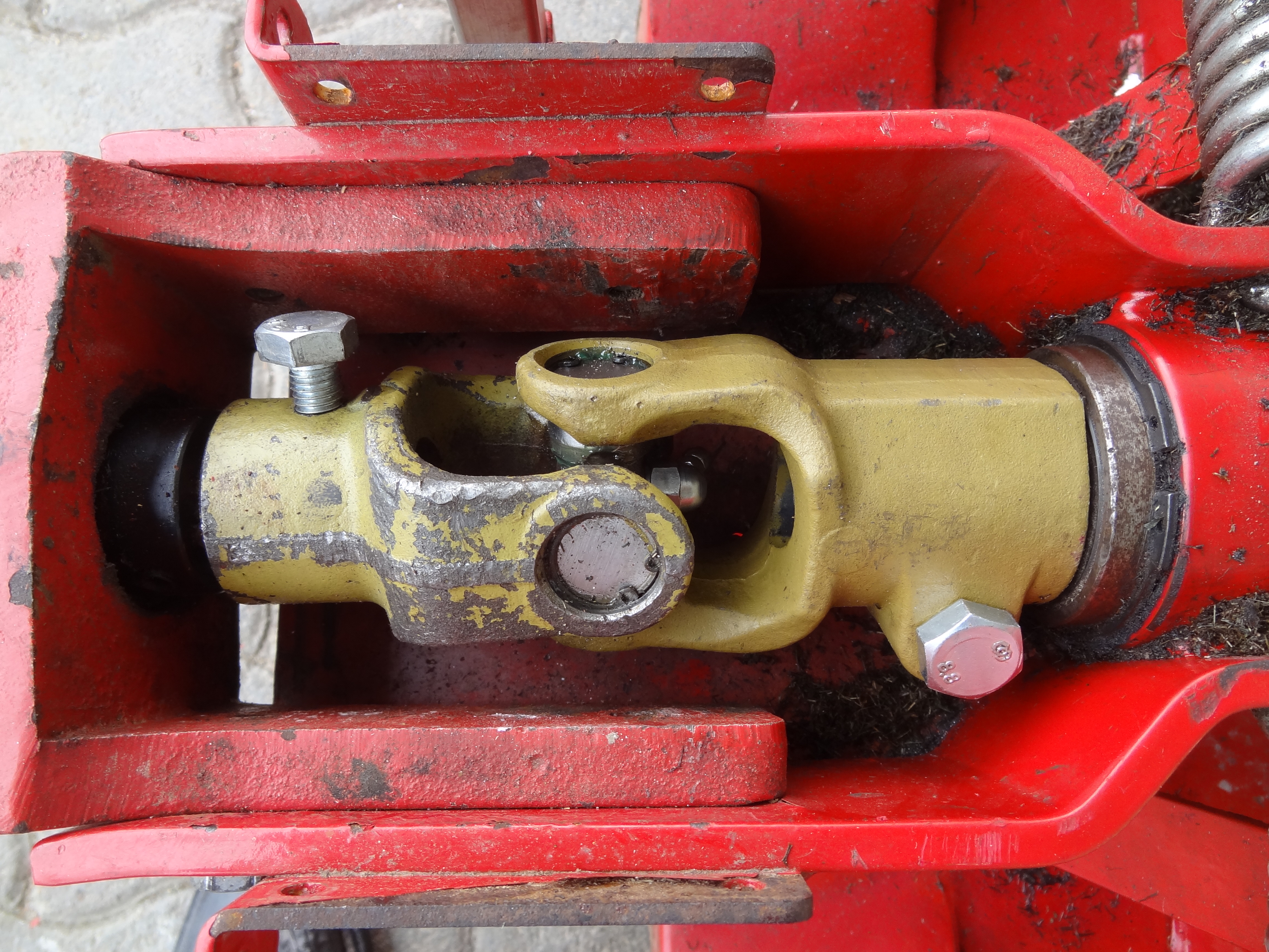

At my last update after the 2017 season, I mentioned the problem that I had with the universal joint which is part of the drive line through the PTO-flange. Since this experience, I have left the yellow cover over the universal joint off, allowing me to keep an watchful eye on it at all times. Further more, I often check that the 2 bolts keeping either end of the joint in place, are tight. To connect the incoming and the outgoing shaft to the universal joint, there is a keyed joint at either end of the universal joint. This feature allows the male flange on the coupling to be adjusted up or down, always allowing the deck of the mower to run parallel to the ground, even with varying tractor wheel size and mowing hight.
Last summer then, I noticed that the key on the outgoing shaft was beginning to wear out, as a little bit of slag had developed in the joint, despite my constant effort to keep the fixing bolt tight. I brought the mower to my local BCS dealer, and he recommended to replace not only the worn-out key, but the outgoing half of the universal joint as well. The picture below shows the final result.
To me this looks like a much more professional solution than the original one, as the new outgoing half of the joint has a slit, that allows it to press tight on the entire circumference of the shaft, and not just at the point where the bolt is.
The picture above shows the original half of the universal joint with the bolt pressing on the incoming shaft.
Perhaps something similar can be a useful solution to other owners of Zanon mowers, experiencing similar problems.

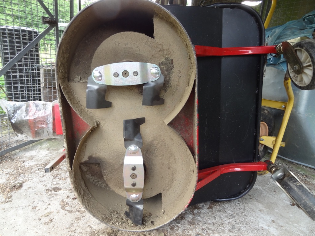

I’m in my 9th season with the Zanon ZCR lawn mower, and the mower has accumulated a total of close to 250 hours. In early spring I was struck by bad luck while mowing, as one of the hinged knives struck a stone to hard and broke :cry:
I decided to use this opportunity to replace all 4 knives including their 2 mountings, and save the old parts as spares.
A new knife next to a 9 year old one with close to 250 hours of use.
The Zanon ZCR standing on its side with the new knives and their new mountings in place.
