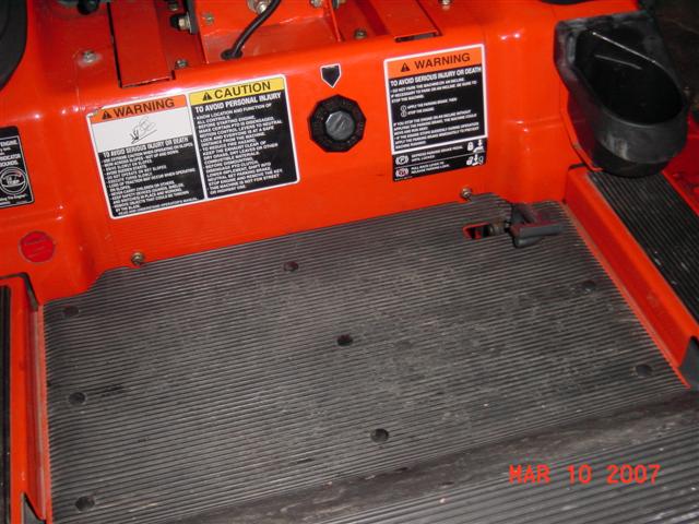

Actually, I started another thread where I did just that. I added a couple of bolts in the top so I don't have to remove the ones under the deck. Yeah, getting the deck off the first time is the pain. I took the brake pedal off.
Removing the mower and just greasing it is going to be so much easier this year. I can't believe I didn't do this before.

Can you post a photo of your new hatch? Did you add any supports in the floor plate to account for the loss of strength from the hole in the floor?

Here's a link to the other thread with picture of the underside of the deck showing the cut:http://www.tractorbynet.com/forums/lawn-garden/95887-zd28-maintenance-hatch.html
I don't figure I did anything to weaken the deck, so no I didn't add any supports.
Here's a pic of the deck after I put it back on. I have since drilled a couple holes in the deck and tapped the frame and now put two bolts in near the rear of the deck so I don't have to bother removing the bolts under the deck which hold it and the fender to the frame, like just in front of the cupholder.
I used to know how to make pics show up in my posts, but can't do it now.
