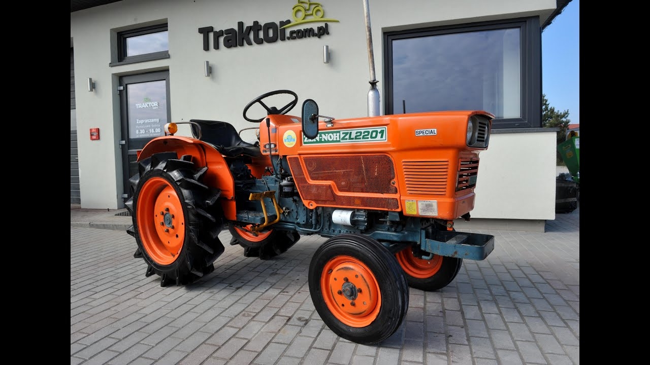

Zen-noh 2201
Are there oil pumps available for the 2201 3 cylinder
   / Zen-noh oil pressure #2
You would probably need to order the oil pump for a Kubota L245. It's the closest north American equivalent to it.
Those engines had a plug installed on each end of the camshaft.
What happens is the camshaft plug on the front of the motor falls out and ends up in the oil pan causing you to lose oil pressure.
I had the l1501 which was a smaller version of your tractor and had to replace it.
You can Google the replacement of the camshaft plug and you can find old threads from people who did that repair.
   / Zen-noh oil pressure #3
Just a comment - Zen-noh is a huge ag co-op in Japan.
Kubota, Yanmar, likely others, put the Zen-noh trademark on tractors they build for this co-op to sell to its members. So far as I know the Yanmar/Zen-nohs are identical to the tractors labelled Yanmar sold in Japan. I expect Kubota/Zen-nohs have an equivalent Japan-market Kubota twin, also.
Researching this could make finding parts simpler, in particular if there happens to be an American-market twin to your Kubota/Zen-noh.
   / Zen-noh oil pressure #4
Your machine is made by Kubota as ZL2201.
Most were orange, some were pine green in color.
