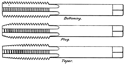

Not sure what a bottom tap is?
It allows you to tap to the "bottom" of a hole. The tap is not tapered it's squared off at the end. They are harder to start though.

   / Zerk fittings #23
Common types of taps:
