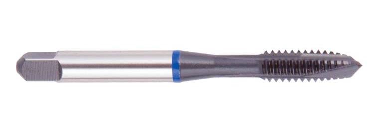

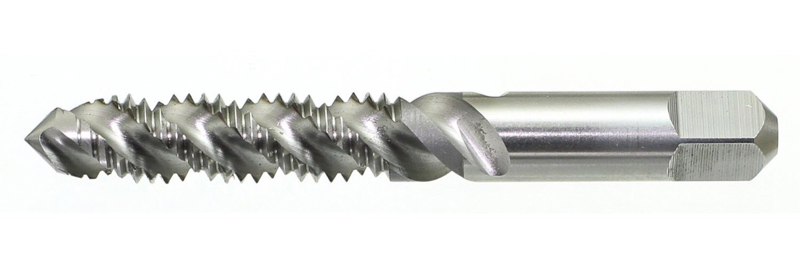

Here is a spiral flute tap it draws the chips upward like a drill bit.
And a spiral point tap it ejects the chips downward.
Either works about 20x better than the usual hand tap.

downsizingnow48, I probably should have go one of those taps, I saw them online but had never used one so I ordered another like I had. I guess I will try it and be a little more careful and see if it works. That is, if I can get the other one out, if not I'll drill another hole. Don't have a cutting torch and I would probably burn something up with my luck!
My tool and tap is suppose to be here fri. or first of the week. I will let you know how I make out!
