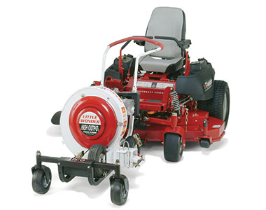

Having just gotten thru another fall season, where so often weather and schedule dictate pushing past sunset while either mowing or using the JRCO Blower Buggy on my zero turn, I went thru the usual frustration of zip-tying and duct-taping various Li-Ion LED work lights all over my rig to get the chores done. It's time for something better and permanent.
The rig I'm running when pushing past sunset is most often the Little Wonder Optimax blower (EX27) on the blower buggy, which looks a bit like this:
Mounting lights down near the front casters or even in the forward cowlings by my knees seems like a good recipe for blinding myself from the back-scatter off that big white blower housing, while creating long shadows out front from the blower blocking the lights. My mower has a ROPS, which I usually keep folded down, but the hinges are up at shoulder height. If I clamp lights onto the lower ROPS, they'd be near bicept height. Probably the best-case scenario on this mower.

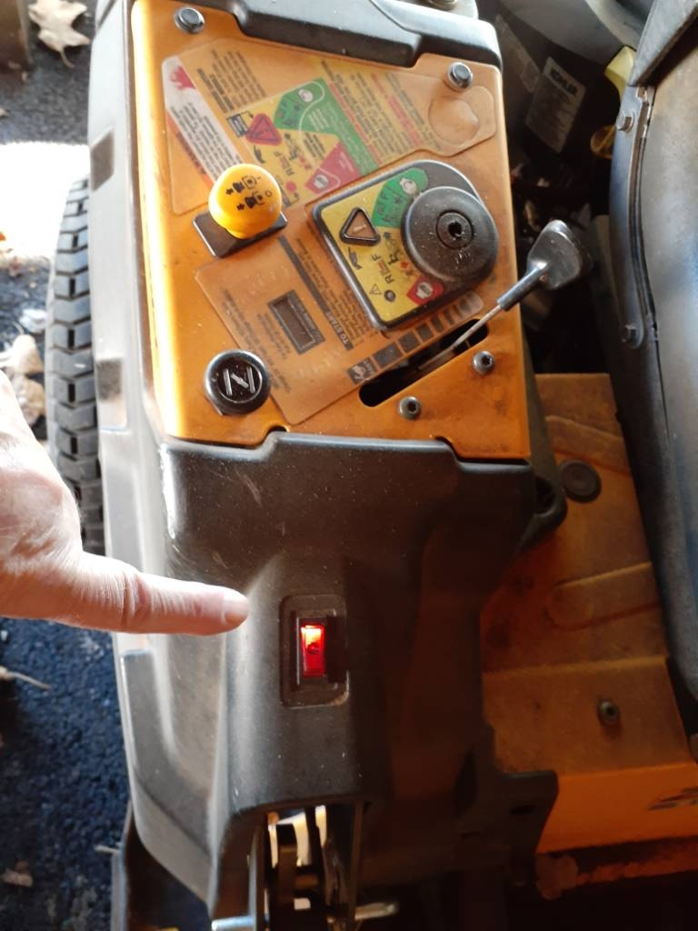

I'm cheap. For $20 I got a pair of these from HF, mounted over each front wheel on Cub Zero. There already was a cut out plug on mower for rocker switch, so there then back to battery where I put a 20A fuse right at battery.

Oh, I'm definitely going LED, since I want maximum lighting and I'm not sure how much current these zero-turns can actually support. Deere literature is always vague, they actually show only one 35W halogen as part of the OEM kit in the Deere parts catalog, but in the shop manual it shows two, so I'm not sure how much added load capacity they had planned into the system, on top of the more substantial PTO clutch draw.
No biggie though, they make LED equivalents of that light for $20/pair, just without any sort of shade that would keep me from blinding myself with it mounted behind my arm on the ROPS.
My switch panel does not have a knockout in the laminate for the switch, but knowing they sell a press-in square bodied rocker with the kit, I'm guessing I'll find a knockout in the aluminum panel behind the laminate. Easily addressed with an X-Acto knife.
Like you, plan is straight to battery, or perhaps battery lug on the starter solenoid if that's more accessible, with a fuse at the lug.

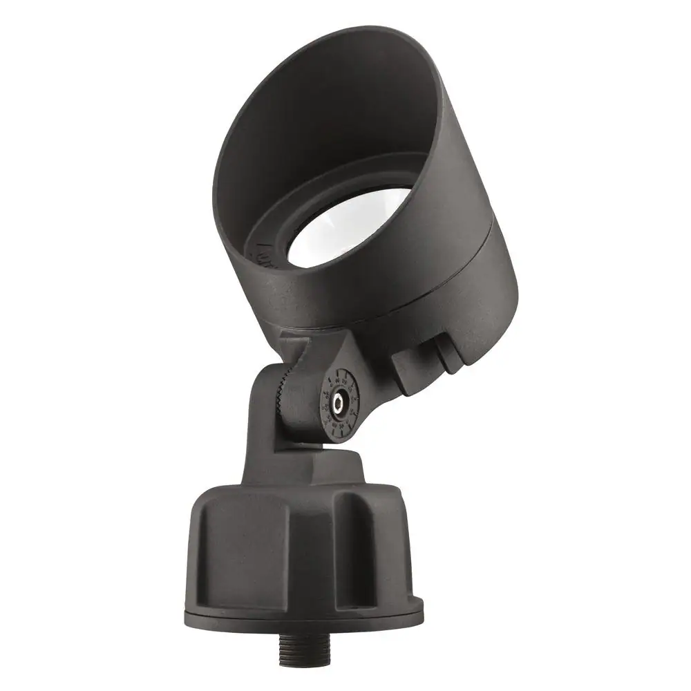

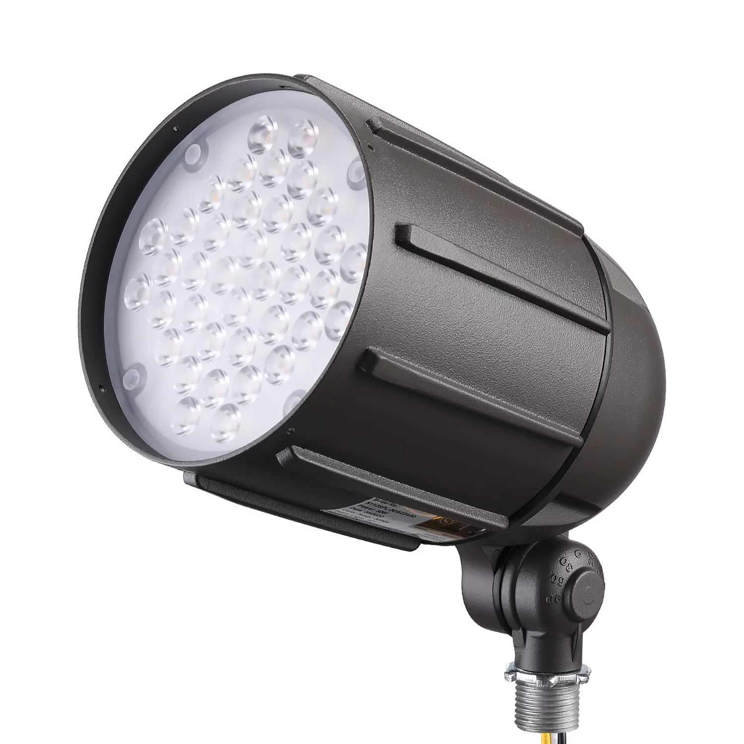

But finding LED work lights with an adjustable shade has been a bit of a challenge. That would be key to mounting them behind me on the ROPS, so as to not blind myself every time I glance behind me to turn or back up. Anyone who has had landscape lights knows the shade I'm speaking of, they're pretty common in that application.
I need this:
Not this:
