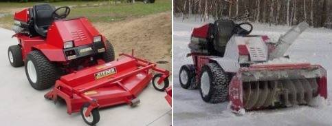

With a sixteen thousand dollar budget, check this out, I have one an love it...
http://www.steinerturf.com/products/tractors/230/
It's front wheel drive, rear steer, it's almost as manueverable as a ZTR, it's
biggest advantage over a ZTR, it can handle about 25 different attachments.
John Deere, New Holland and Kubota make similar turf tractors, not sure if
then off as wide a range of attachment...
Richard
West Michigan
