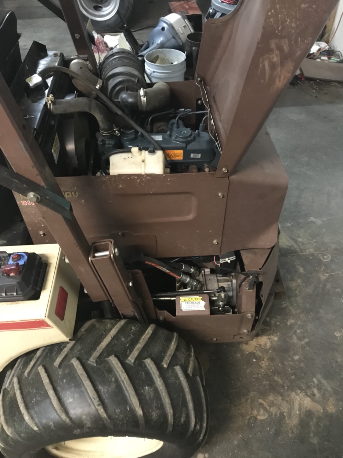

Here’s mine. My sideways traction is much better. Going sideways it’s really still a game of not letting the up hill tire slip forward sending the front of the mower down the hill. IMG_1805.JPG

Dang, and I thought I was all set for another mowing season. You guys got me thinking. There indeed is a lot of finesse with handling Z's on slopes and I enjoy the challenge, but more traction just means you upped your game! :D :thumbsup: :dollarsign:

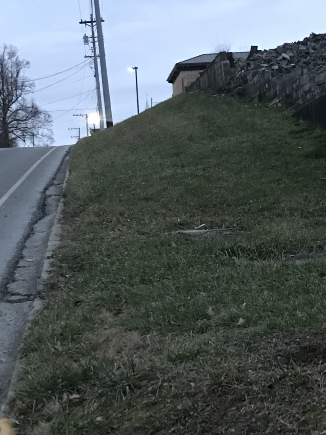

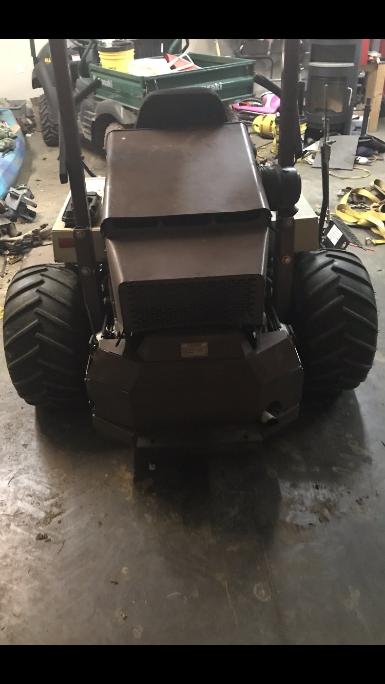

Most people’s mistake on hills is jerking back with the uphill tire and spinning it and then it’s game over. You have to be careful with the up hill tire and push into the hill with the downhill tire. Which the tires on my machine are 58” apart outside to outside and has a Kubota diesel mounted behind the center of the axel with helps the hill siding tremendously.IMG_1806.JPGIMG_1151.JPG

Our wide commercial machines will definitely out perform the little machines in hills. Take a homeowner machine with useless turf tires and add what’s likely a first time operator and it’s no wonder why ZTRs have a reputation for sucking on hills. Imagine what could be accomplished with a front wheel locker.
