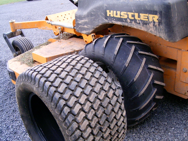

My first zero turn (850 lbs) with turfs was terrible on hills.
My current zero turn is nearly double the weight (1600 lbs) with turfs was no better on hills. (the extra weight made little to no difference in traction IMO).
I replaced the turfs with bar tires (Chevron AT 101) and the difference in traction and mowing hills is HUGE.
Our hills that were always a problem with crappy turfs are no problem at all now.
hey vince, thanks for posting the side by side pic. I think I might look at cost of swapping out my turfs on my little Z turn. I have fair amount of sloping and not always dry lawn. Do you get better traction in terms of a sideways slide (mowing across the slope)? I can imagine the traction going up/down the slope would be much improved.
I gained traction in every way vs the turf tires.

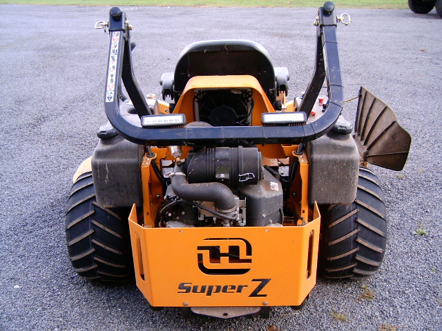

Here’s mine. My sideways traction is much better. Going sideways it’s really still a game of not letting the up hill tire slip forward sending the front of the mower down the hill. IMG_1805.JPG
/ Zero turn turf tires #26
Here痴 mine. My sideways traction is much better. Going sideways it痴 really still a game of not letting the up hill tire slip forward sending the front of the mower down the hill. View attachment 597000
Dang, and I thought I was all set for another mowing season. You guys got me thinking. There indeed is a lot of finesse with handling Z's on slopes and I enjoy the challenge, but more traction just means you upped your game! :D :thumbsup: :dollarsign:

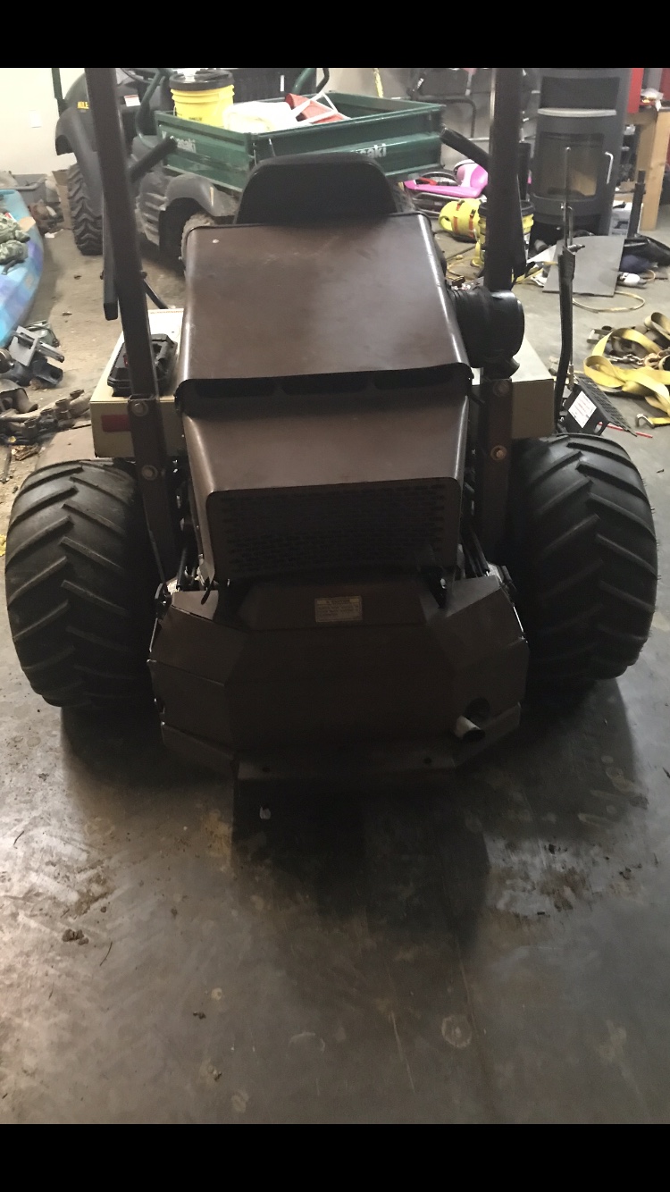

Most people’s mistake on hills is jerking back with the uphill tire and spinning it and then it’s game over. You have to be careful with the up hill tire and push into the hill with the downhill tire. Which the tires on my machine are 58” apart outside to outside and has a Kubota diesel mounted behind the center of the axel with helps the hill siding tremendously.IMG_1806.JPGIMG_1151.JPG

Our wide commercial machines will definitely out perform the little machines in hills. Take a homeowner machine with useless turf tires and add what’s likely a first time operator and it’s no wonder why ZTRs have a reputation for sucking on hills. Imagine what could be accomplished with a front wheel locker.
