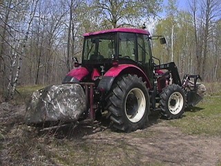

Here's Zetor toting rocks. 5000+ on rear 2500+ on the front

They say a picture is worth a 1000 words.
This picture was worth one for me.
WOW.
That is impressive and who could argue that.

WOW! I hurt my shoulder picking up something way too heavy for my (s)pecs. /forums/images/graemlins/grin.gif
I shoulda used a Zetor.
What is they say? "Life is better with a Zetor." /forums/images/graemlins/cool.gif

Barry, Picking up those heavy rocks really demonstrates the lifting power of the Zetor tractor!

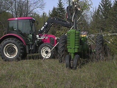

I think you'll find that Zetor loaders are better balanced on the frame than some others. I road about 3 miles on tar to another place + brush clearing which takes it's toll on tires so I opted for Zetor iron wheel weights, can be added to equal what calcium chloride weight would give you. The chloride will kill whatever it leaks out on. Another safe bet is a handy 3 pt weight you already have.
Our old JD A has loaded tires with the rusted out rims on the junk pile that goes along with it. I give the rusted rims to friends for campfire pits. They in turn provide burgers, brats, & beer during the summer when up camping.
I'm jealous of your plow, they go for $3-400/bottom at auction around here. I ended up at $200/bottom from the classifieds.
Pix of Zetor loading brush.
