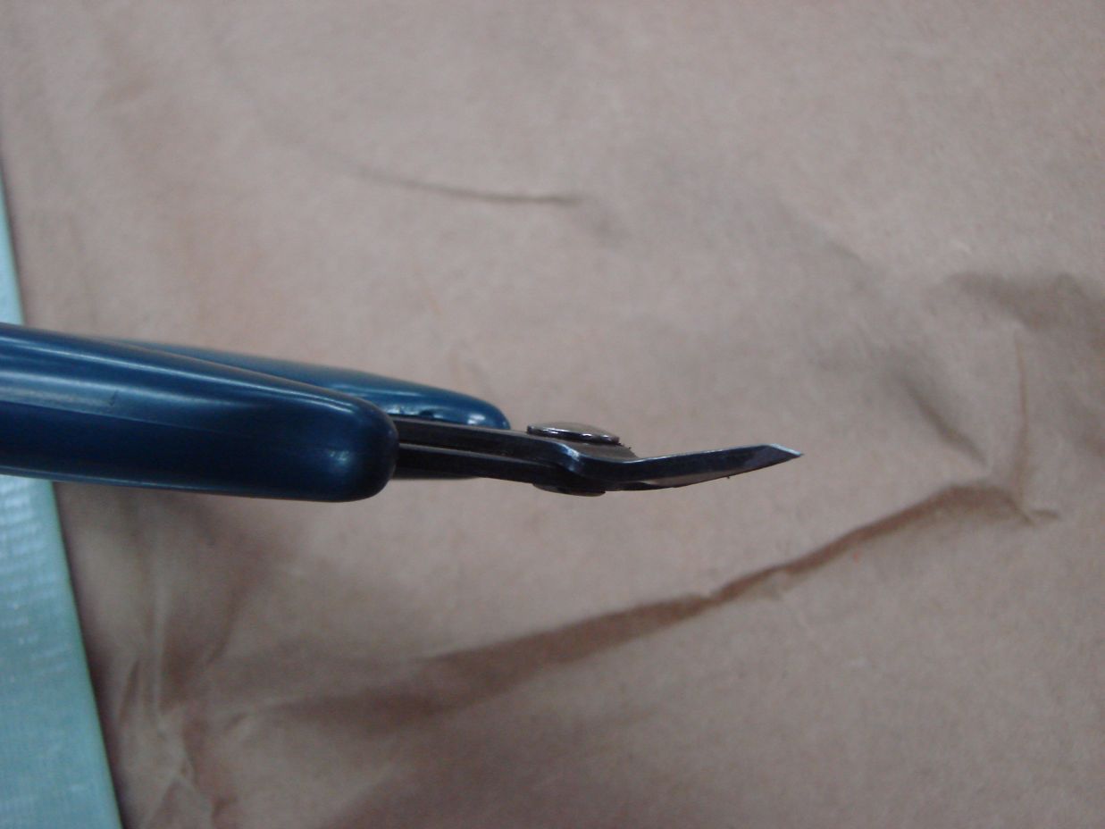

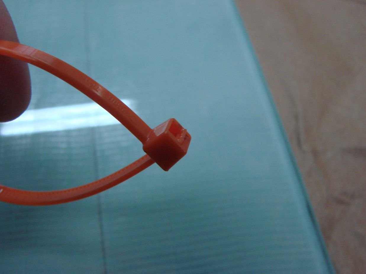

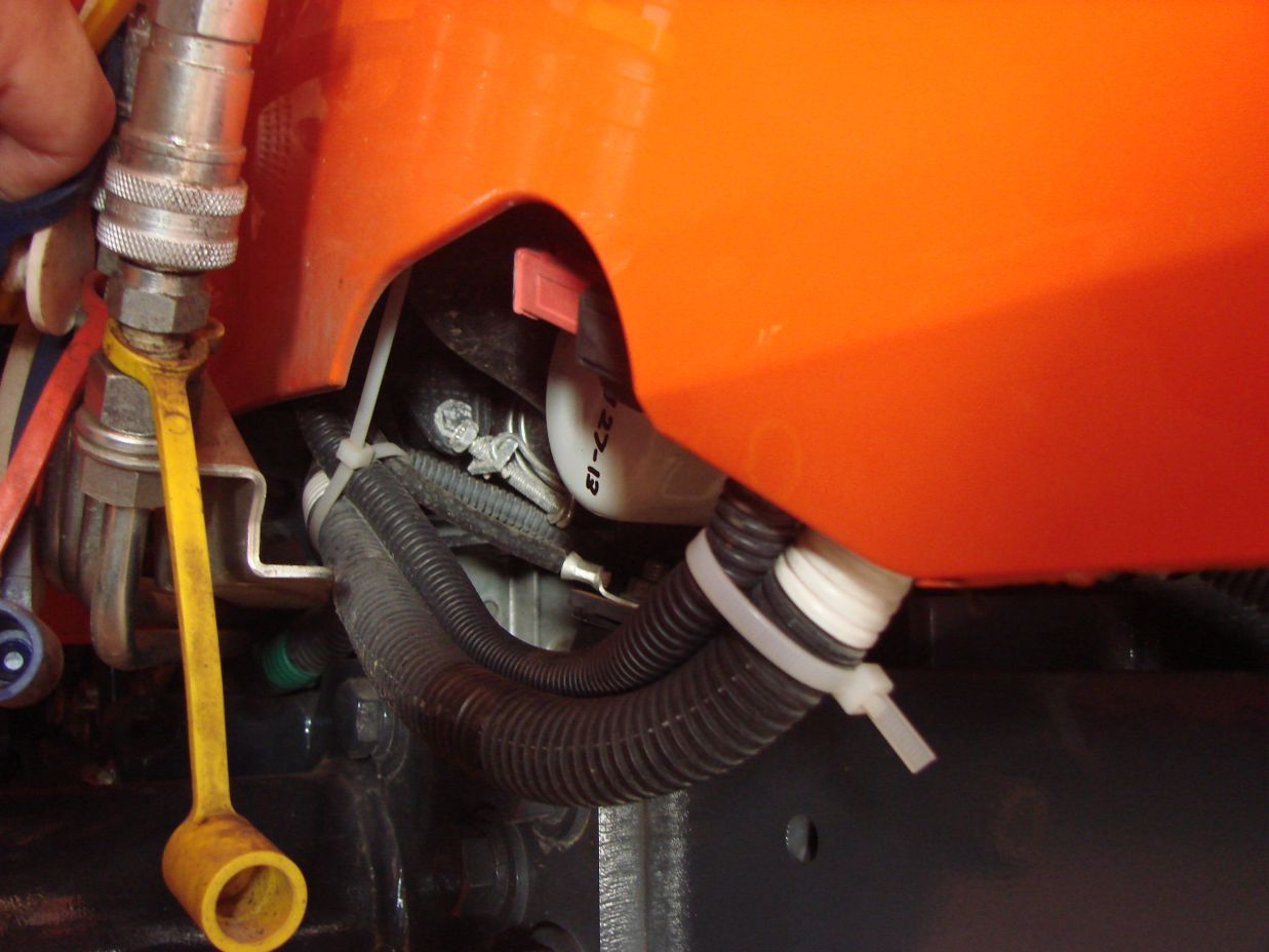

Well it's obvious the zip tie issue isn't just on my end. I know some might find it amusing to see the zip ties like they are on these Kubota's and even more amusing that it bothers some but the fact is not cutting the zip ties to the end lock is really a hazard for the service technician and the customer alike. As a service tech myself I've had some major scratches cause the sharp ends left on the zip tie and it's not only dangerous it's also very unprofessional to leave them that way. I'm sure this wasn't done at the dealer level because there's to many out there cut the exact same way. Kubota should be ashamed of themselves to let this go like that and the dealer should be picking up on the issue at the time of P.D.I. (Pre delivery inspection)
Again. Some might not think of this as a none serious issue but it is very serious. If you work in fluids related to equipment and you get a bad scratch from these zip ties you can end up with a very serious injury. There is a simple tool built exclusively for cutting zip ties and for less than $5.00 it's well worth it. Cut the ties as short as you can so you don't cause anyone any harm.

Thank you 4shorts for discussing this. You always explain things very well and professionally. My hat off to you! :thumbsup:
Interesting your photo is nearly identical to mine. Definitely from the factory! Because KY is a long way from Newfoundland! LOL!
I'll be talking with Kubota this Feb at the National Farm Machinery Show. They need to come up with a better method for their wire/hose securing. I have a feeling this issue is only on American assembled equipment. :no:

Paul those flush-cutting side-cutters look pretty nice, but if you don't have any of those, you can use your regular side-cutters and if they still leave a "razor-blade" sticking up you can hit the "razor-blade" with a file or emery board just a stroke or two, and it will leave it smooth as a prom queens thighs. :)

Hey Papa no thanks necessary. I appreciate your kind comments. Thank you for the great thread. I don't get a lot of time to look around the site between work and my personal stuff so I'm sorry to be so late responding. Yup it's a factory/assemble thing. The people that do that sort of thing is only after a pay cheque. Quality is not in there sites at all in my opinion. They went to the trouble to cut the zip tie so you would think it would be just as easy to do it right :confused3:
Just no pride left in today's society. Sad, Very sad :(

Good point James. I've used it all from a knife to a side cutter but those little cutters I have pictured work so well. "will leave it smooth as a prom queens thighs" Now that's funny right there :laughing: :thumbsup:

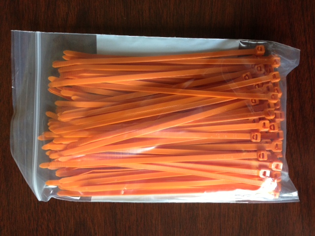

Okay I had just had to grab these (100qty) while I was walking through a customer's factory today and saw these in the bin. I won't say who/where but it was an aerospace OEM. They use them for test/temporary systems install due to easy color recognition so they will not remain on production aircraft at delivery. I also picked up some large orange ties (about 30in long)! Now can go home and do another mod to my BX :cool2:
