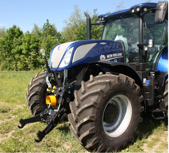

is anyone running a Zuidberg front pto and 3 point hitch?
Is it possible to use a front end loader with that setup?

I ran across this fella's posts when I got my B2601.
I believe the loader can be fitted at the same time, but it's tight.
I'm not sure about that link.
just type "Kubota front pto" into your search engine.
   / Zuidberg front PTO / 3 Point Hitch #3
The link: Front Linkage Systems | Elevate Your Experience
The look:

Yes
I guess it’s possible, the upward lift isn’t very high.
Let me clarify, Im asking can I use the factory front end loader when there is a front 3 point hitch
i.e. is there enough clearance between the front 3 point hitch and the front end loader bucket?
   / Zuidberg front PTO / 3 Point Hitch #6
Oh, I thought you meant connecting a bucket to the front 3 point.
Yes, as long as the loader speced for the tractor isn’t too small or overly short armed.
I’ve seen a few tractors with both a front 3 point and a loader. The 3 point should be able to tuck in behind the loader.
