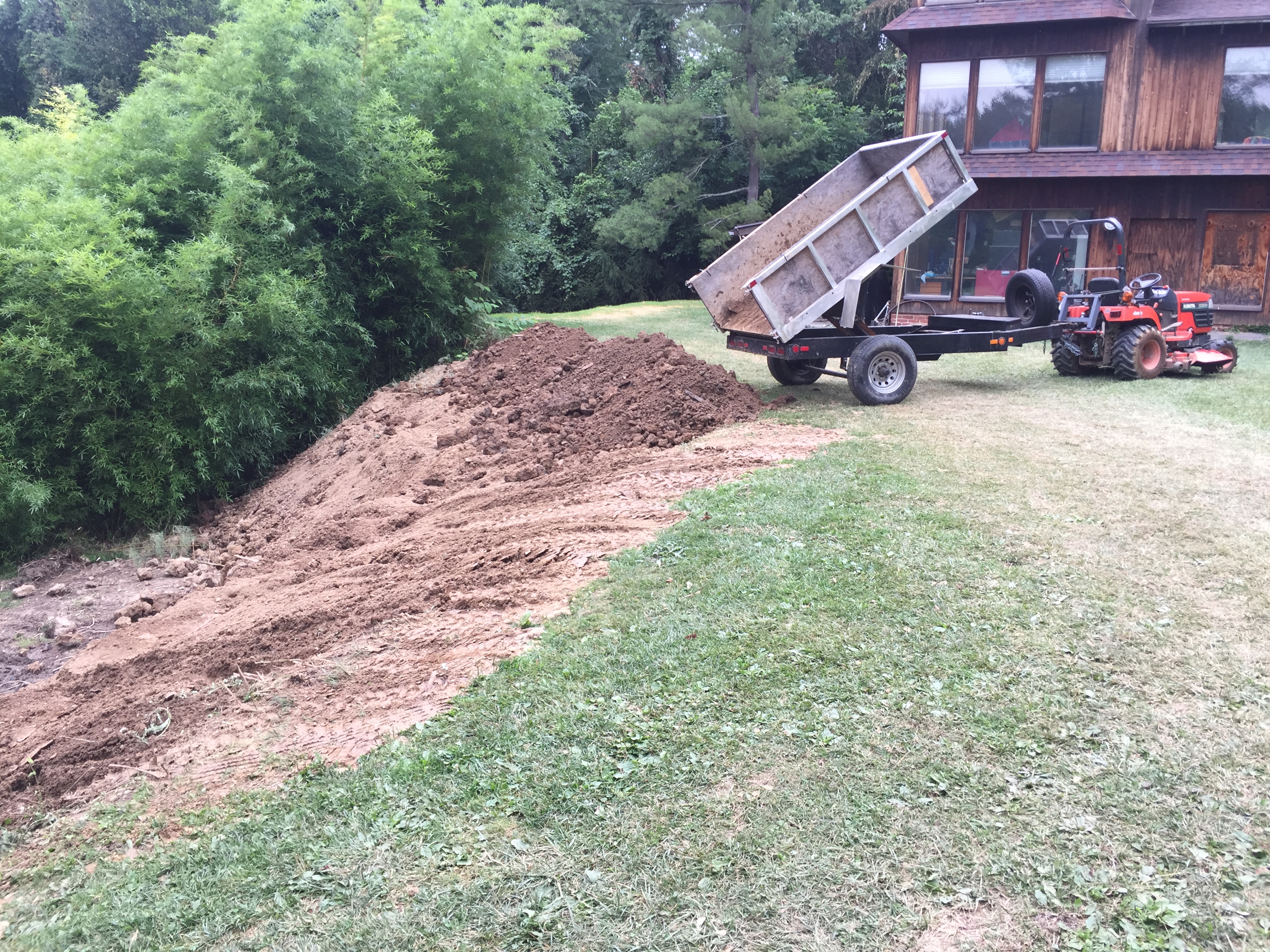

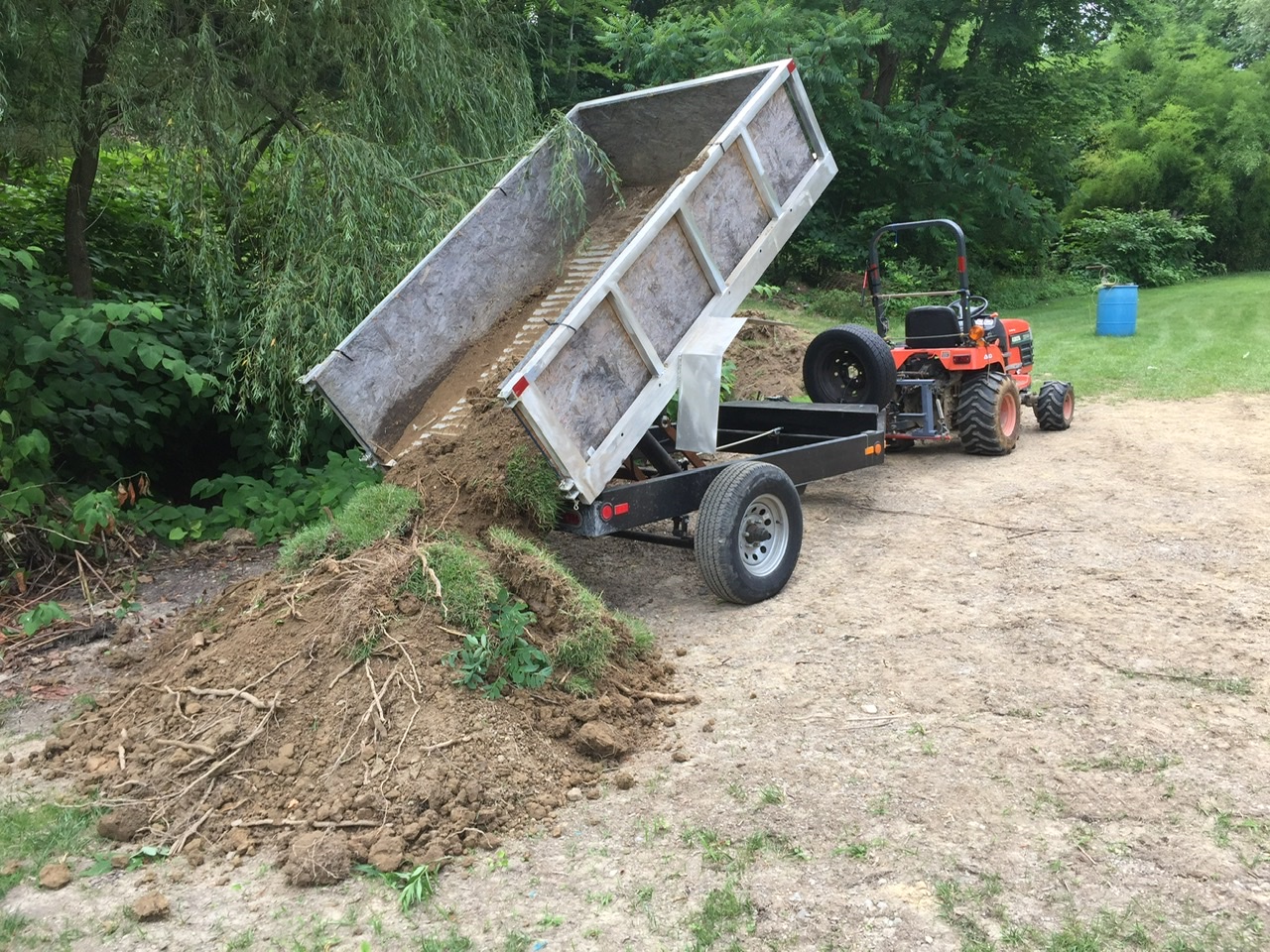

   / Can you pull a 7’x12’ dump trailer with a 3pt trailer hitch receiver? #10
Re: Can you pull a 7遅12 dump trailer with a 3pt trailer hitch receiver?
My little BX2200 pulled this 5x8 dump trailer with out any issues, using the 3ph. Several hundred loads a last year and the year before.
Only problem I had was running out of traction if the grass was wet.
I raised the 3PH before dumping to increase the dump angle. Trailer plus load was usually between 1.5 and 2 tons.
Edit: I usually dumped with the 3PH fully raised, so I never noticed any upward movement of the 3PH when dumping. BUT I occasionally forgot to fully raise the hitch, and never noticed any tendency for the trailer hitch to raise. Could be the geometry of my trailer though...
Given the size of your tractor I do not think you will have any issues. But you need to ensure the hitch ball is solidly fixed in position. I welded up a frame to hold the ball in position so it would not rotate.
